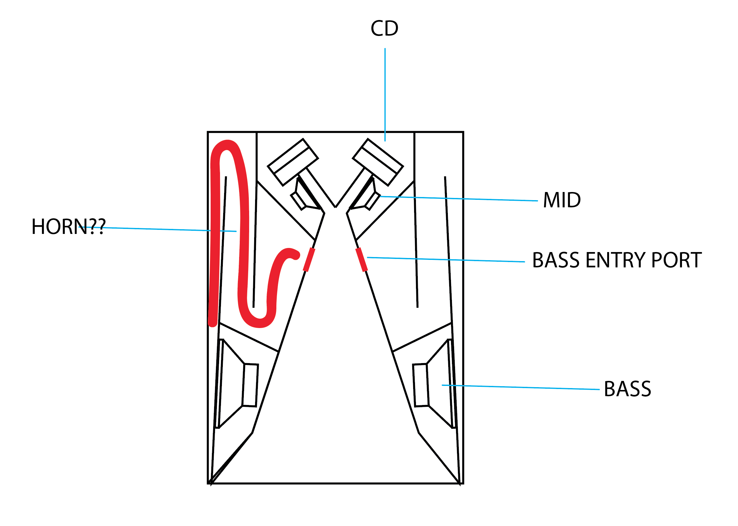

Ugh I really don't need another project, but I DO think that what you propose is valid.
Here is how I would do it:
https://imgur.com/DeWRJBM.jpg
We all know what Unity horns look like, here is my current project.
If you are prepared to use DSP in your Unity horn project, I think it is VERY possible to use *extremely* long midrange taps. Possibly as long as a foot, maybe even two feet!
The key to making this work is that you want the midrange taps to expand continuously.
https://imgur.com/ybgIKcJ.jpg
Easiest way to do that is with very narrow midrange taps that expand from the throat up to the mouth.

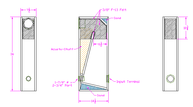

To make this work with a very long midrange tap, you'll want to mass load the tap.
http://www.pmillett.com/images/jx92_dwg_view.GIF
This is a mass loaded transmission line.
Now, you're probably wondering, why mass loading?
Normally, we use mass loading to SHORTEN a horn or transmisssion line.
In this scenario, we'd use mass loading because it allows you to make the exits of the midrange tap much smaller.
For instance, you might have midrange taps that measure 12" x 1/2", but at the very last moment, at the exit of the Unity horn, the taps would 'neck down' to 6" x 1/4".
The idea is that we get the effect of a horn mouth that measures 12" x 1/2" but with a much smaller mouth, just 6" x 1/4".

Patrick Bateman 7th September 2019 12:18 AM
What I describe could be used to horn load the midranges, the woofers, or both.
The "trick" is that you're putting the midranges or woofers into a horn, and then using DSP to line up the wavefronts as they enter the Unity horn.
Similar to what was described in the first post:
https://www.diyaudio.com/forums/atta...4-07-37-24-png
