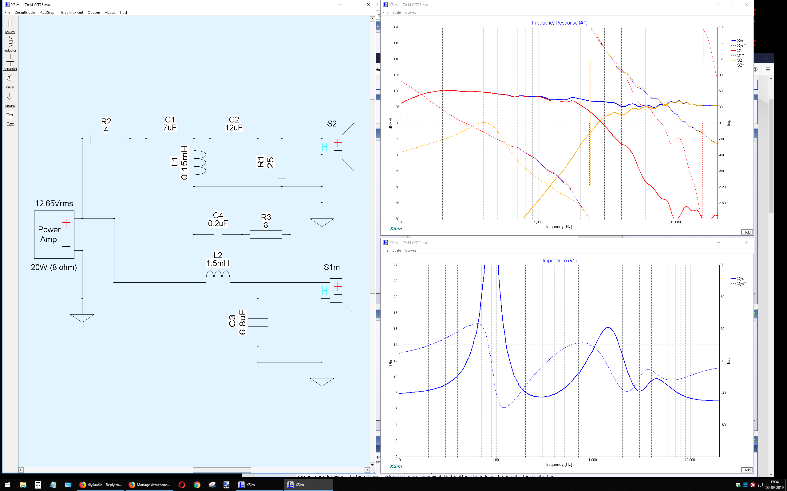

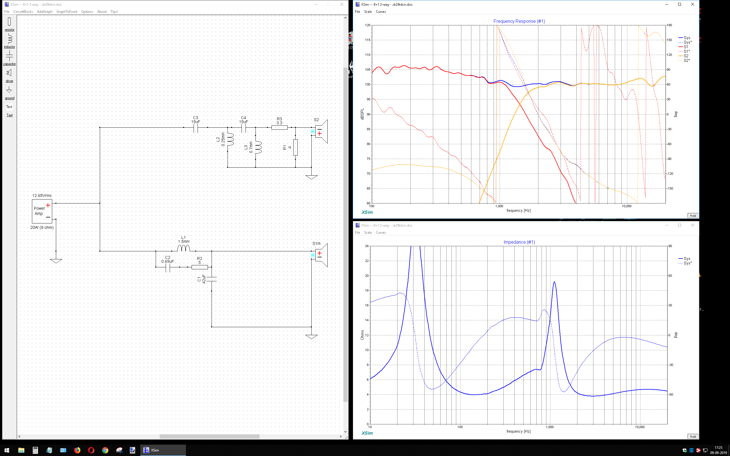

I'll try and illustrate using a theoretical simulation. I do not like the construction complexity of tilted or stepped baffles. When I desire time alignment I will put tweeter below woofer or 'fix it' in the crossover.
I have attached two pictures, each is for a 'phase coherent' system with drivers tracking phase reasonably well (for a multi-driver system on a flat baffle). All FRD/ZMA files were traced from manufacturer's IB measurements, and the bump at the low end is to compensate for baffle step. Both driver sets are totally different, and time offsets have been manually entered.
In picture 1, notice the two drivers track phase very accurately right upto the point the the woofer starts going crazy due to breakup. Though in FR terms it is contributing very little to the output, this is not going be winning any awards for good performance. It will be a little rough up top.
In picture 2, you will see the drivers tracking much better all the way till 40-45dB of attenuation, with very little phase difference till we get past 9k. This will be a better product (provided drivers have low distortion etc and if I manage to get the time to actually finish the crossover and buy parts).
IOW, phase coherence alone does not make a speaker sound good.
