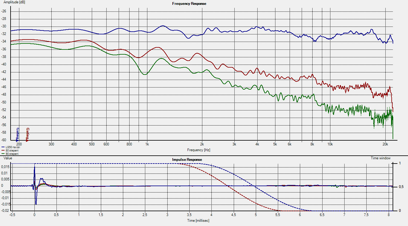

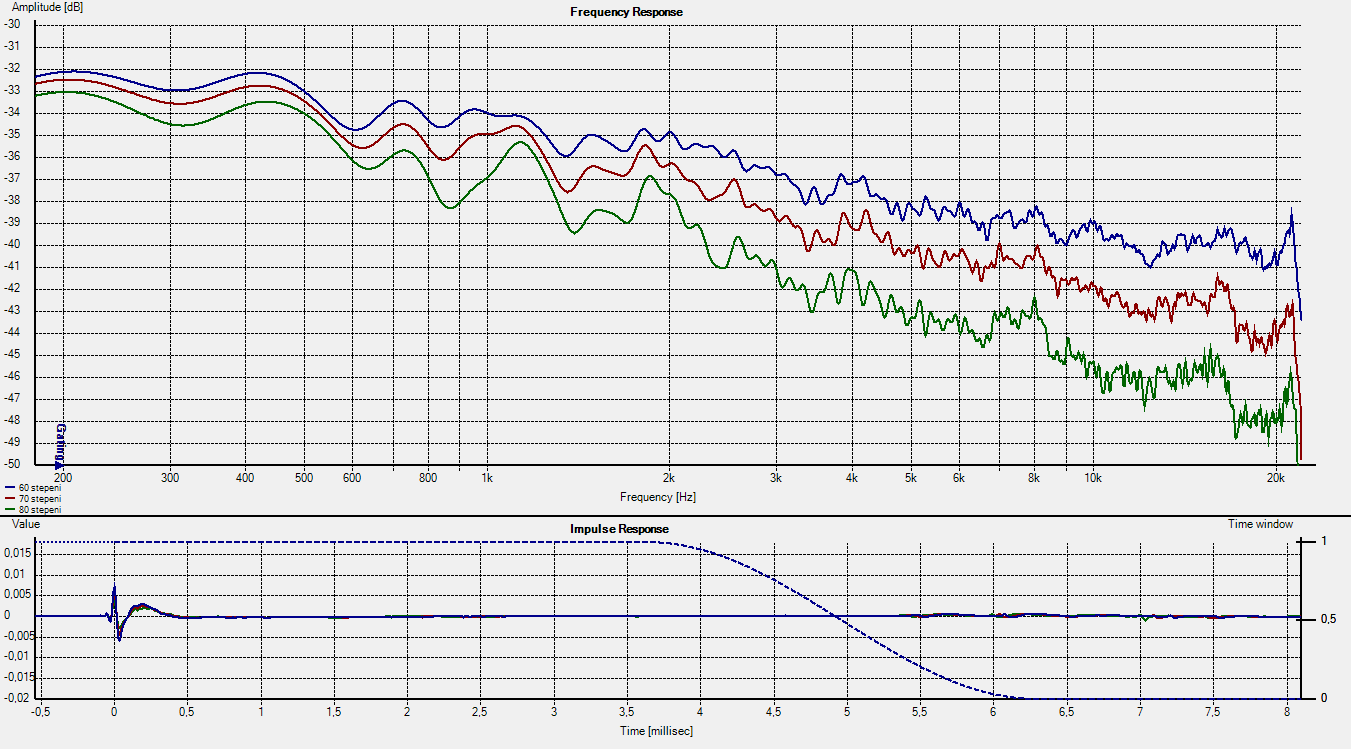

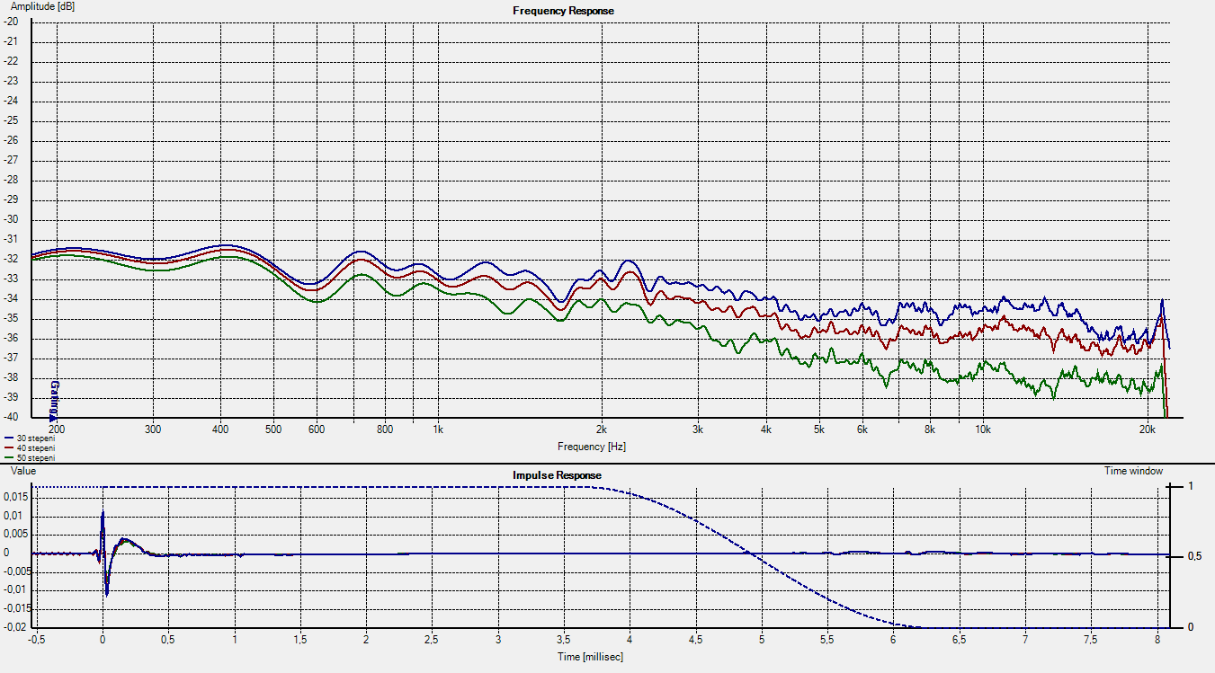

TBTL 4th September 2019 12:49 PM
The Denovo Vortex also loses most of its upper treble when going off-axis, see these measurements: Vortex Speaker Kits | HiFiCircuit
krivium 4th September 2019 01:00 PM
Tbtl, yes but isn't it a common character for this kind of drivers? The graph looks pretty smooth to me. For my own preference i do not listen on axis, something like 15* off axis and despite the fact my system 800 are designed for nearfield and i'm using them 'midfield' ( 2,5m away listening spot) i don't find the high gradual roll off to be bothering to me. Other flaws are much more disturbing to me with this particular drivers.
