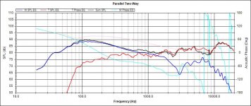

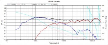

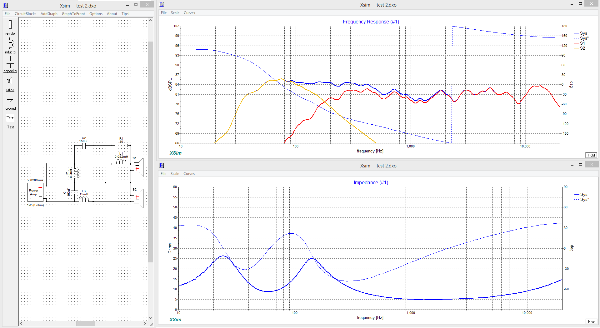

I was recently gifted with a pair each of MarkAudio Alpair 6m Gen2 and Dayton RS225-8 and would like to build a set of FAST (WAW if you will) 2-way floorstanders.
Before you ask, I don't have the equipment to take direct measurements myself, so I have been designing the crossover based on the manufacturer graphs. I have included .frd and .zma files I have been working with. Dayton has actual files from partexpress and I used a tracer program for the Alpairs.
I want the front baffle to be 10 inches wide which would be a baffle step at around 450 Hz. As such, I figured that would be a good crossover point. I have been playing around in WinPCD. I tried to do first order on both, but I didn't like how the response looked. So I tried first order on the woofer + zobel and second order on the Alpair (with polarity reversed) and think they look better.
Woofer: 4mH coil, zobel 20uF + 10ohm. Tweeter: 35uF + 2mH.
That said, and I'm sure you could tell, I don't really know what I am doing and would greatly appreciate any recommendations on the design.
Also, if there is anything else you need to know, please don't hesitate to ask.
Thanks so much!

You aren’t crossing that low so a passive XO is doable but typically you want to have the woofer 43-5 db more sensitive than the midTweeter. With this combo and a pasisve XO you are likely going to have to significantly attenuate the A6.2m.
10” gives a nominal Bs(-3) ~ 456 so XO between that and 0.707 times ~320 Hz. Without measures exactly where is bets for the combo to deal with BS. I would probably start XO at about 350 Hz.
An acceptable passive XO is way harder to do than active, and as you go lower in frequency it gets more & more cost effective to biamp. (i rarely design passive XOs).
And ideally you want to keep the XO at a point where the C-C distance between drivers is less than a quarter wavelength of that frequency.

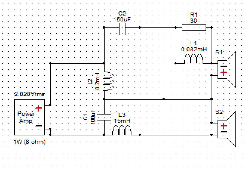

I have amongst the same speaker you seek. Design is all worked out and RS225-8 is a superb woofer. Almost any 8ohm 2.5in to 3.5in full range can be used with appropriate level adjustment via resistors.
10F/8424 & RS225-8 FAST / WAW Ref Monitor
Here is the XO:
656203d1515700364-10f-8424-rs225-8-fast-ref-monitor-xrk971-10f-rs225-fast-schematic-jpg
Put the woofer on top for best time alignment.
Looks like this:
756284d1557709163-10f-8424-rs225-8-fast-waw-ref-monitor-cb7e495f-65c0-4d77-a7e9-fbbede3e4857-jpg

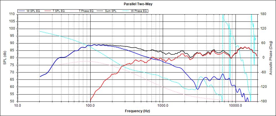

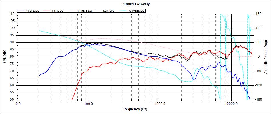

As nerdy as i am, i messed around with this data for maybe an hour and came to this. It's a second order serial crossover without zorbel or bsc as it looks best without, but with a notch filter to tame the treble. 1st order and parallel crossovers did not work well with this setup for one or the other reason. You find the project files included.
  • MarkAudio Alpair 6m Gen2 and Dayton RS225-8 2nd order serial CR.zip
I like series XOs, one of the times i did a passive i couldn’t get anywhere w parallel, th eseries just popped.
Isn’t this 2nd order:
attachment.php
dave
Yes it is, altough i'm a big 1st order fan, sometimes it's just not fit like here. Th OP crossovers too high to my taste, and the 6M does not go low enough to crossover low with it in 1st order. I do 1st with my 10M and that works, but here a second order is needed.
180Hz as you can see in the graph. That's where i like to crossover FR (the 150-250 band) so there is no crossover in the frequency band where i find it disturbing (the 300-4K band). It's there that the phase issues that every crossover has, are most heared by me and where it disturbs me. Above or below is ok for me altough i prefer no crossover at all if possible...
It's because i crossover so low that i need a 2nd order, a first order would cause gaps in the lower part of it as the 6M does not go low enough.

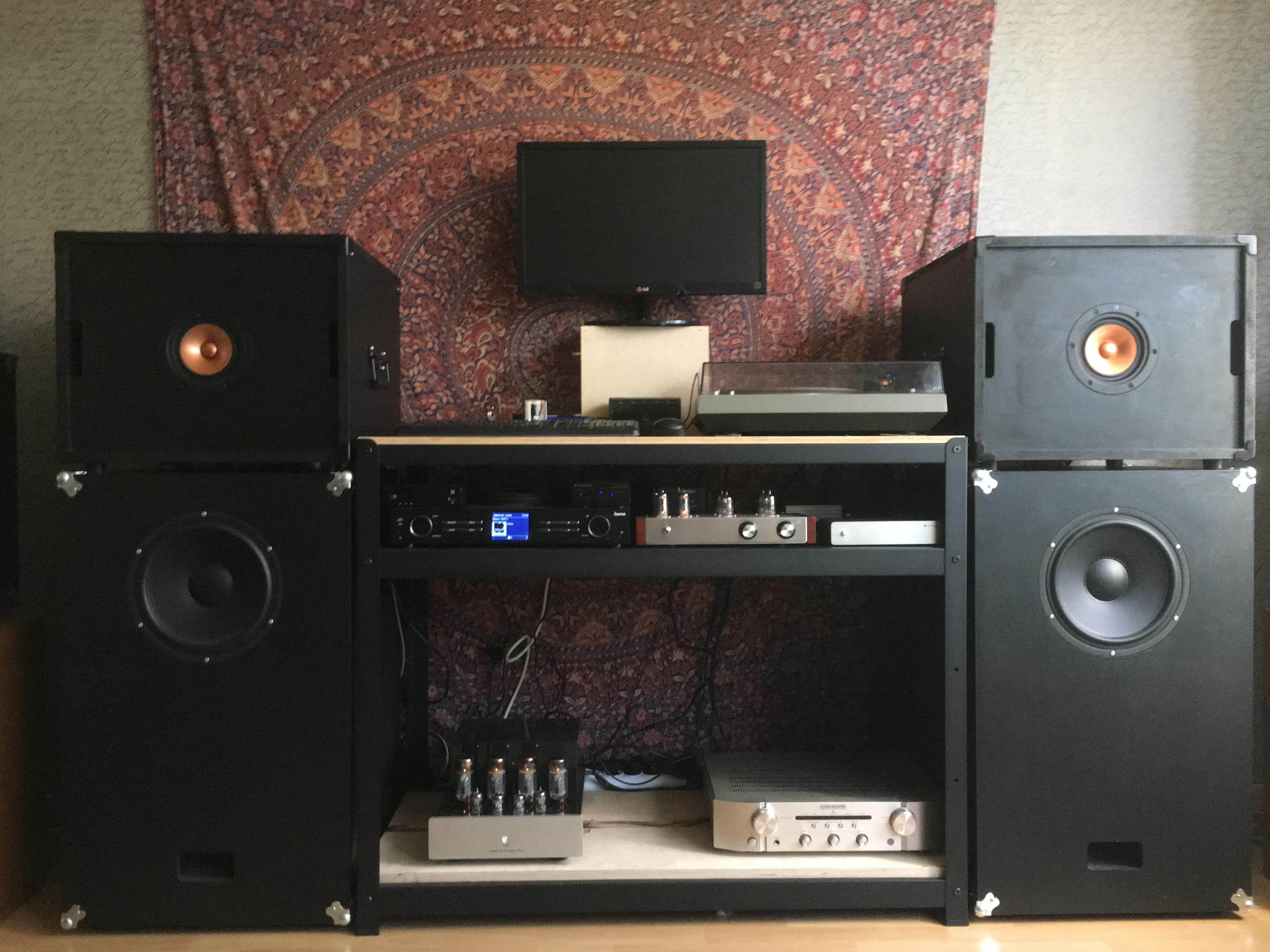

Well, my best sounding box for this alpair 10M driver (nominal 6", in reality 5.5 or so), is a 50cm wide ported cabinet with 2 ports on the side of the front, like seen in this picture. It's a 25L cabinet shallow cabinet and on it's own tuned to 40Hz, but mostly used with the subs below it. The total box is bigger because behind it is the space for the crossover network in a seperate space.
