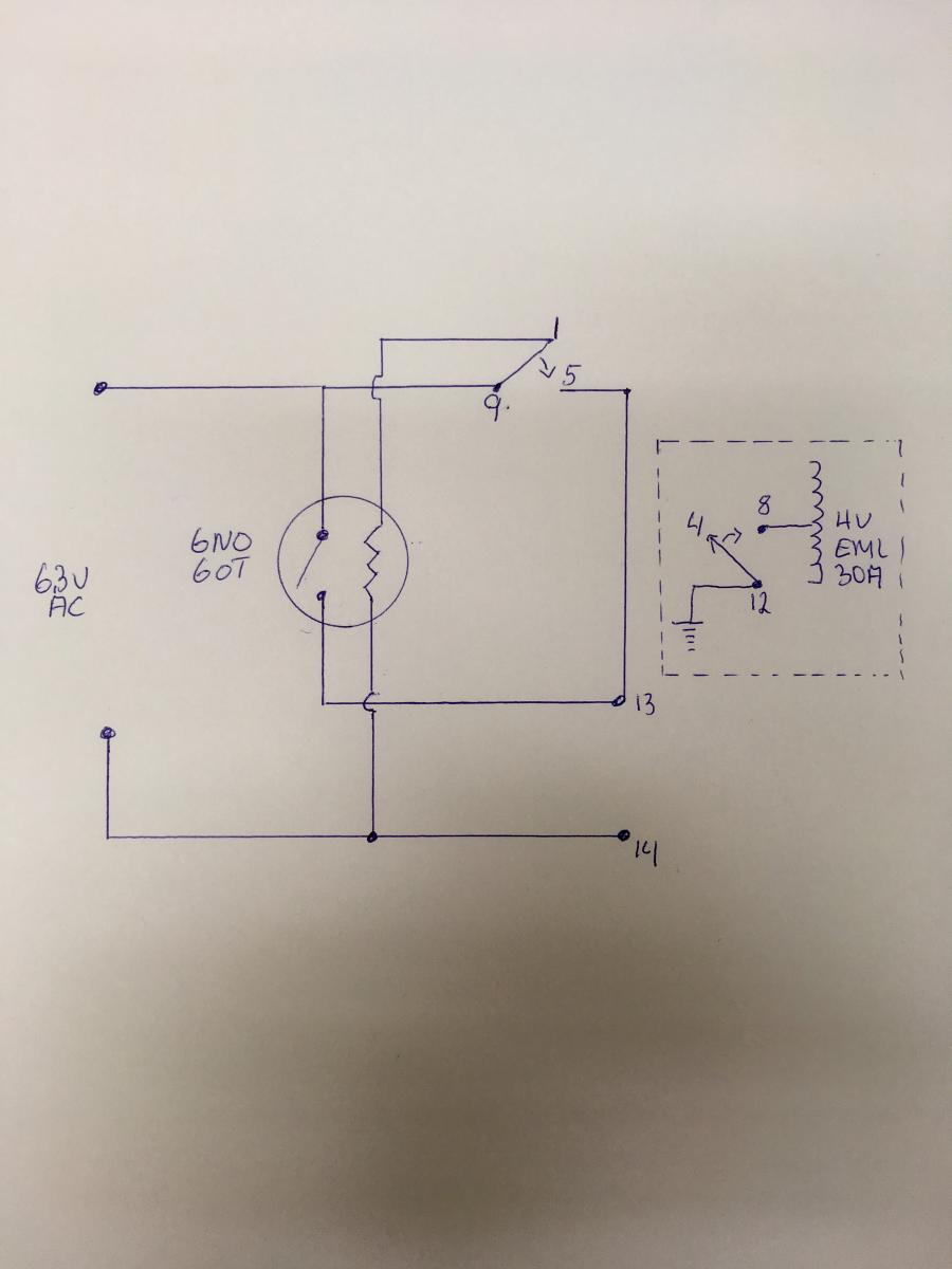

Be careful of the spec sheet. Not all SSRs switch at zero cross. The ones that do will specify such. The ones that don't may say nothing.
Using a 240V switch to power a 240V relay to power the amp seems peculiar unless the amp takes so much power than such an arrangement is necessary. For an EL34 amp it is not necessary and simply adds cost, complication and unreliability. There is no need for a stand-by switch; it may do little harm if you get it right, but it won't do any good. For over 70 years ordinary domestic amps have used a simple mains switch, because that is all that is needed.
20 years production of tube-based TV sets with silicon diode voltage doubler power supplies too. No tube rectifier warn-up lag in those to avoid stressing the other tubes warming up.
BUT:-
1. Delaying HT switch-on does give a small tube lifetime advantage - a somewhat larger advantage in larger more expensive power tubes - that's why Tektronix for example had a thermal relay (Amperite) to delay HT switch-on in their more expensive CRO's.
2. In stage band applications, musicians like to have a "standby" feature - where the heaters are kept warmed up and ready, but there's no HT and a completely silent amp until it's that musician's turn to play.

Using a 240V switch to power a 240V relay to power the amp seems peculiar....
My understanding was that he proposes a rotary switch to sequence the start-up. Off, Heat, HV.
Since high-current rotary switches are a hidden corner of the world (motor controls, not electronics), he's using common rotary switch for the logic sequence and relays for the power.

An old alternative (Dynaco had it on the BIG tube amp) is a relay with a time delay. This needs no user training. It won't stall at hot cathode and dead HV, kodabmx's objection. Time-delay relays are now hard to get.
Of course there are situations where you leave the heaters hot (or half-hot) with dead B+: instant-on TV the notorious example.
I use these for time delay: DC 12V Relay Module Adjustable Delay Time Switch 0-10 Second Bo NE555 W3W6 P8J2 | eBay
