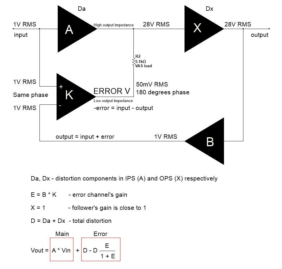

Is there a thread or post somewhere explaining the “Only Distortion Negative Feedback” ODNF concept - with schematic? It sounds really interesting.

Hi X!
Here is the initial thread:
No-global-loop amplification
Here is the post with some theory:
https://www.diyaudio.com/forums/soli...ml#post5328425
Simpelstark V1.1 post:
https://www.diyaudio.com/forums/soli...ml#post5347597
Very good discussion with Brian (traderbam) and Hugh (in the background) helped a lot to clarify my own understanding of what really happens in ODNF setup.
Version 1.1 was tested very successfully, however, later on, I introduced some further improvements in the output stage - current version is V1.3 (you can see the building guide with schematic in the store, being logged in).
The key idea - design an amplifier as linear as you can, having no global loop at all, providing the gain you need (e.g. 29db), and then add 18-20db of ODNF (overall gain will not change).
This is the very promising approach - I continue working on some pretty cool new designs, based on it.
If you will have some questions - please let me know.
Valery

Thank you, Valery. This is good stuff!
https://www.diyaudio.com/forums/atta...nf-formula-jpg
