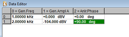

I think the AP can do that too in the multitone generator. You can specify individual tones for amplitude and phase.
Need to check.
Edit: yes it can, see attached. Powerful!
