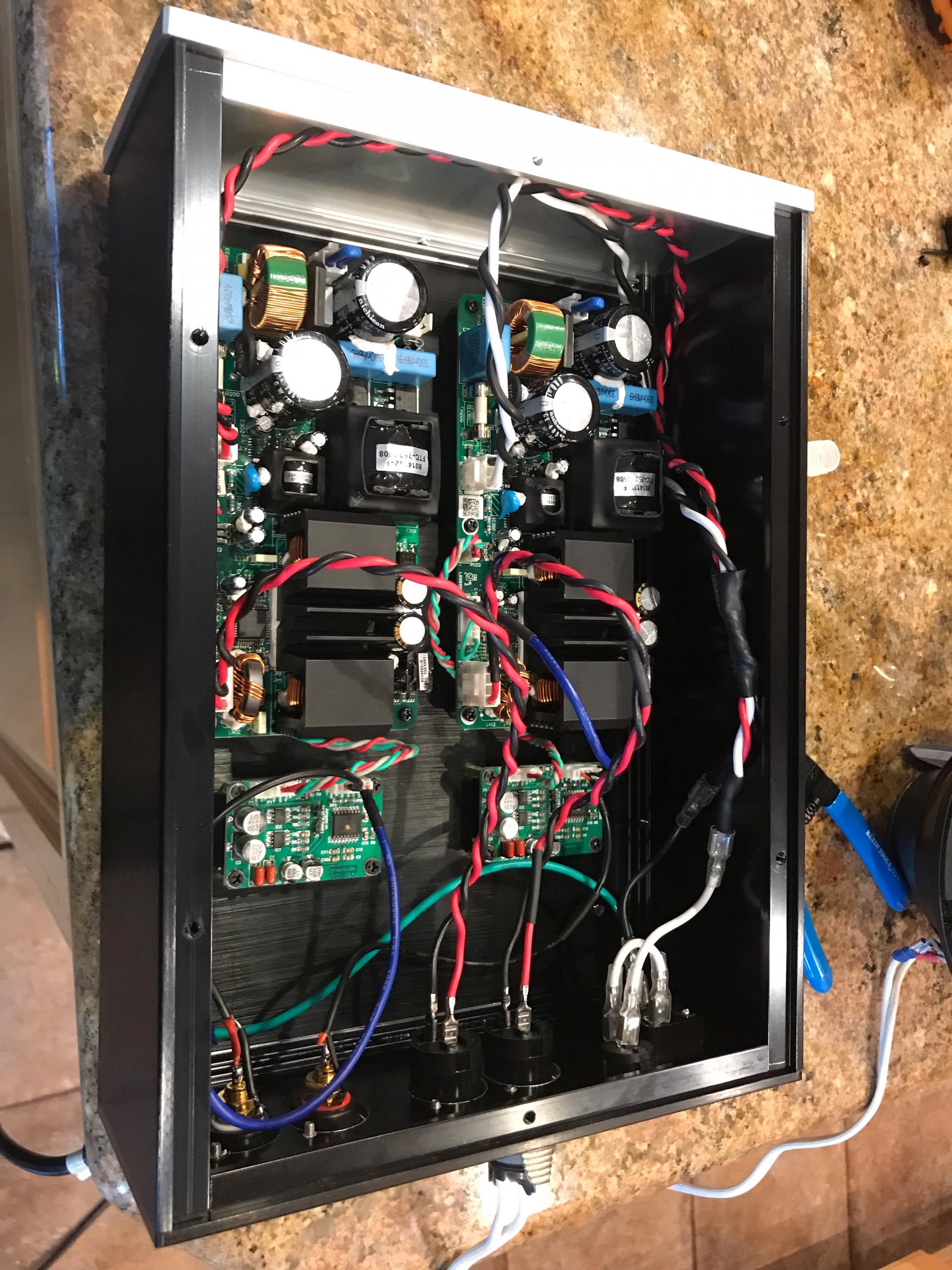

I built two amps. One uses a single 125asx2 in stereo mode. Connected the single ended inputs direct to the amp module with no buffers needed. The second is a dual mono with two 125s in BTL mode, which requires differential input into to the amp to drive the positive and negative side of the bridged output. For this I used a converter buffer from Ghent audio: ghentaudio --- RTX (unbalnced RCA to balanced XLR Converting) Module
Here’s a picture of the dual mono amp with the buffer modules. Since the amp you ordered supports bridged output, there must be a buffer or transformer to generate the differential input needed by the amp module. I may order a couple of these today. If they have 125asx2 module in them they’re worth the price just for pulling the module out. Otherwise if the input stage sounds good then these are a real bargain.

The sound of ICE amps can suffer without a buffer, if the souce is not low impedance. If you have a preamp that drives them well, you do, off course, need no buffer. Some models may sound better if driven symetrically from a strong buffer, as the input stages are not build to be used single ended. So, this is a "maybe" situation. Some commercial amps with ICE modules use transformer inputs.

You have to have balanced input to the amp module for bridged mode. And you must wire the bridge mode selector pin and speaker outputs correctly.
