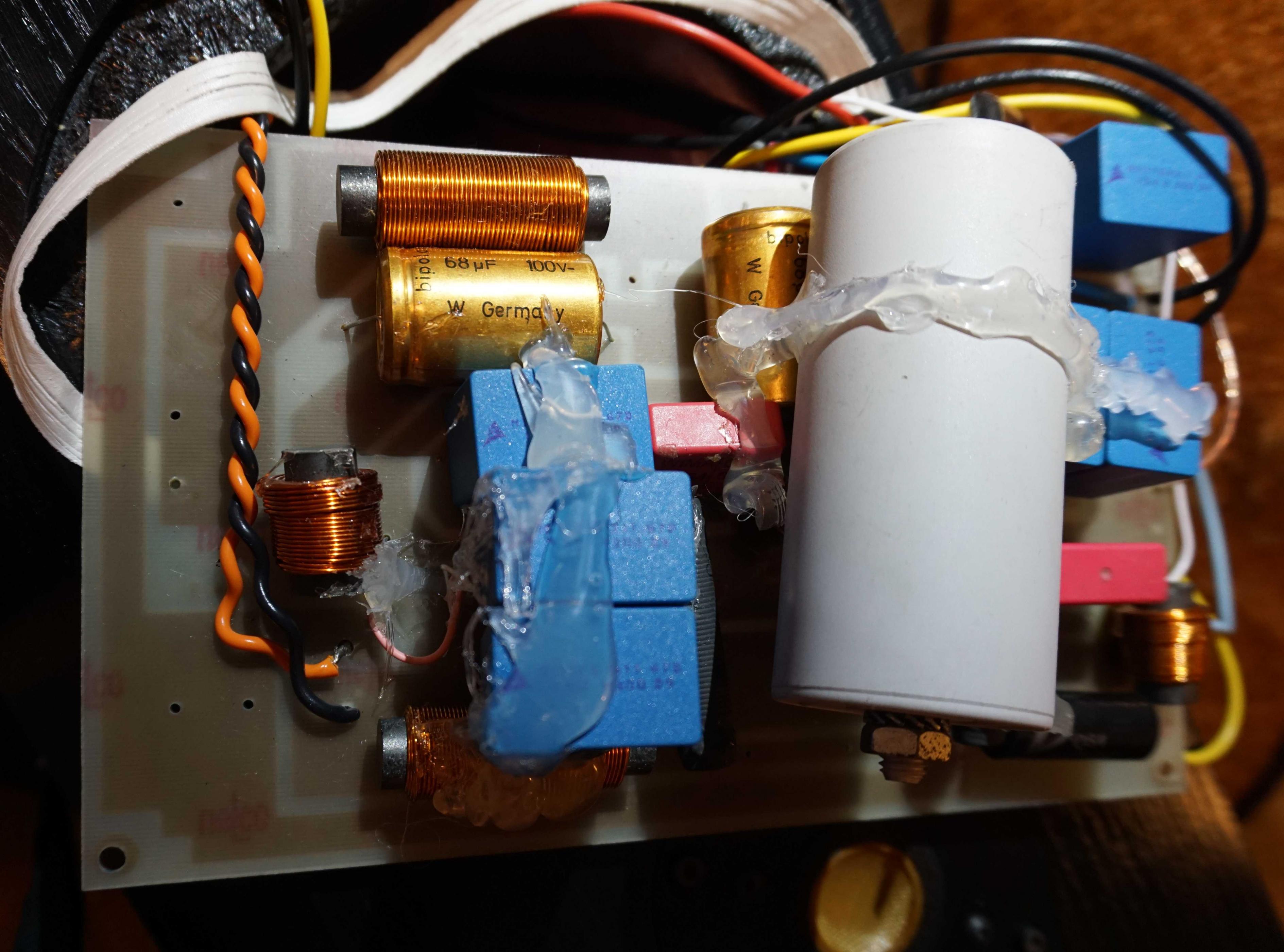

Help for JM Lab crossover repair
Hello,
Asking for help.
Can anybody send me actual schematic for JM Lab Olymp K2 loudspeakers' crossover?
I have bought the pair spekers and I found the sound of the them to be very strange. So I unscrew the mid-bass speaker to have a look at the crossover and found it to be in very poor condition (see the picture).
I can repair the PCB but must have the original schematic for the crossover to reconstruct it.
Thank in advance for your effords,
Jarek
The physical condition looks OK to me, just a bit messy because of the hot glue applied to hold components in place.
The only components worthy of changing would be the non-polar electrolytic capacitors (the cylindrical ones). You will find the required values written on these capacitors.
What's written on the big grey cylindrical thingy?

Hi again Jarek!
I can't locate a circuit diagram or even an alternative photo of your crossover
It is possible that the previous owner has modified the crossover and that may explain the untidy hot melt glue.
That's why I am interested in discovering more about the grey cylinder which looks out of place to me.

Hello Galu,
I have the photo of original crossover (unfortunately I cant read the lettering on some elements) which certainy differs in many details from existing one:
1. No big inductance in bass section. Was replaced by capacitor.
2. No third power resistor on the PCB. Empty drilled holes.
3. Original PCB has some gaps grinded in few places. Have some extra winding jumpers too.
4. Big grey cap is a 40uF/450V one. They are using such components in fridges to start asynchronous motors.
My conclusion is the tweading job was done by a bungler.
