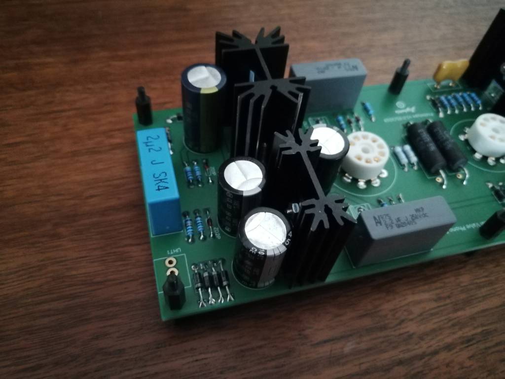

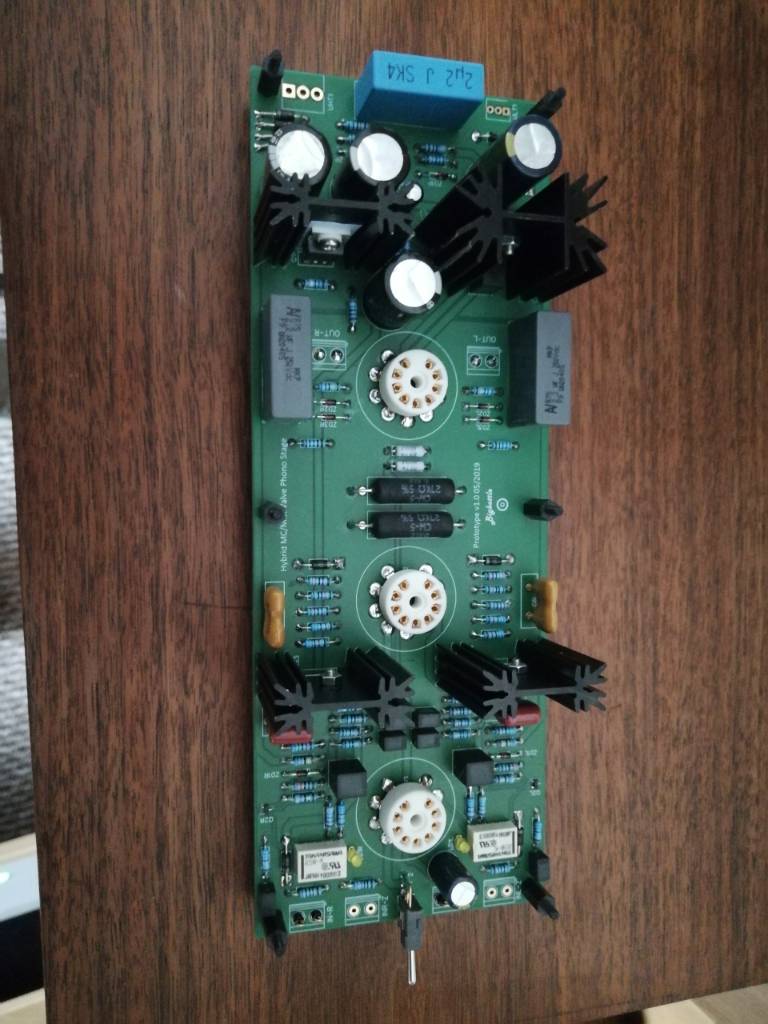

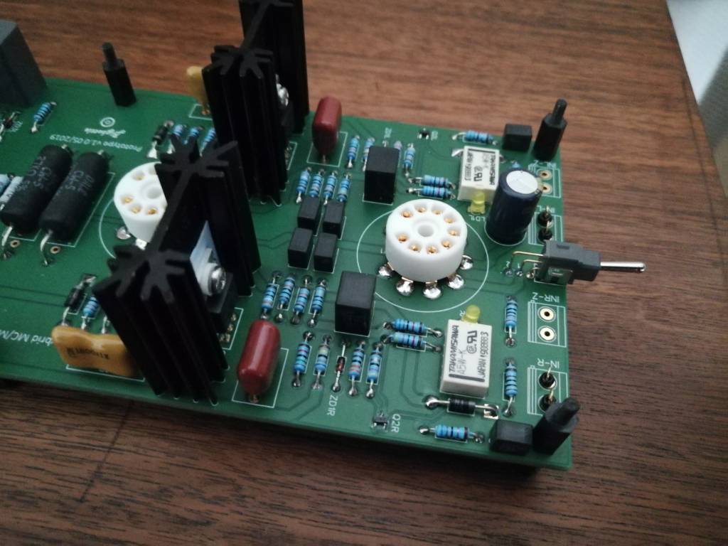

Bigman80 4th August 2019 11:41 AM
Here are a few pics of the board.
https://i.ibb.co/HdMnJYt/IMG-20190804-123415.jpg
https://i.ibb.co/12FrMf5/IMG-20190804-123410.jpg
https://i.ibb.co/N1HLHmY/IMG-20190804-123406.jpg
https://i.ibb.co/n1td39B/IMG-20190804-123426.jpg
https://i.ibb.co/Pcgw7L9/IMG-20190804-123421.jpg
https://i.ibb.co/RYLsBMM/IMG-20190804-123434.jpg
https://i.ibb.co/YZ2FX7s/IMG-20190804-123401-1.jpg
https://i.ibb.co/8Yh8HJT/IMG-20190804-123450.jpg
Please note, a BOM will be provided to anyone looking to help with the Beta testing.

Jazid 9th August 2019 04:35 PM
Good solid board. One point I have found needs addressing so far; the ECC83 valve filament (pins 4 and 5) is traced as a dead short on the board. Haven't looked further back. The PCC88 filament traces seem ok.
A question; what is the function of the switch SW1 or is it some hangover from the MC board. It limits the case that can be used or maybe I'm up a gum tree?
Bigman80 9th August 2019 04:44 PM
Quote:
Originally Posted by Jazid (https://www.diyaudio.com/forums/group-buys/341001-bigbottle-mm-mc-hybrid-valve-phonostage-pcb-post5878397.html#post5878397)
James,
Use my email address as DIY is doing my nut in lol
The switch is there so you can use the phonostage in MM or MC.
You only need to connect "1 & 2" and as long as a switch is wired in, you can put a case mount switch in place. So I'm told lol
O
Jazid 9th August 2019 05:19 PM
Ignore my previous post - pins 4 and 5 are wired together as ECC83 has a centre tap from pin 9. For some reason I can't edit my post above.
Bigman80 10th August 2019 02:09 PM
Yep, no worries,
It's due to the different voltages that are required for the valves. As you know now anyway lol.
