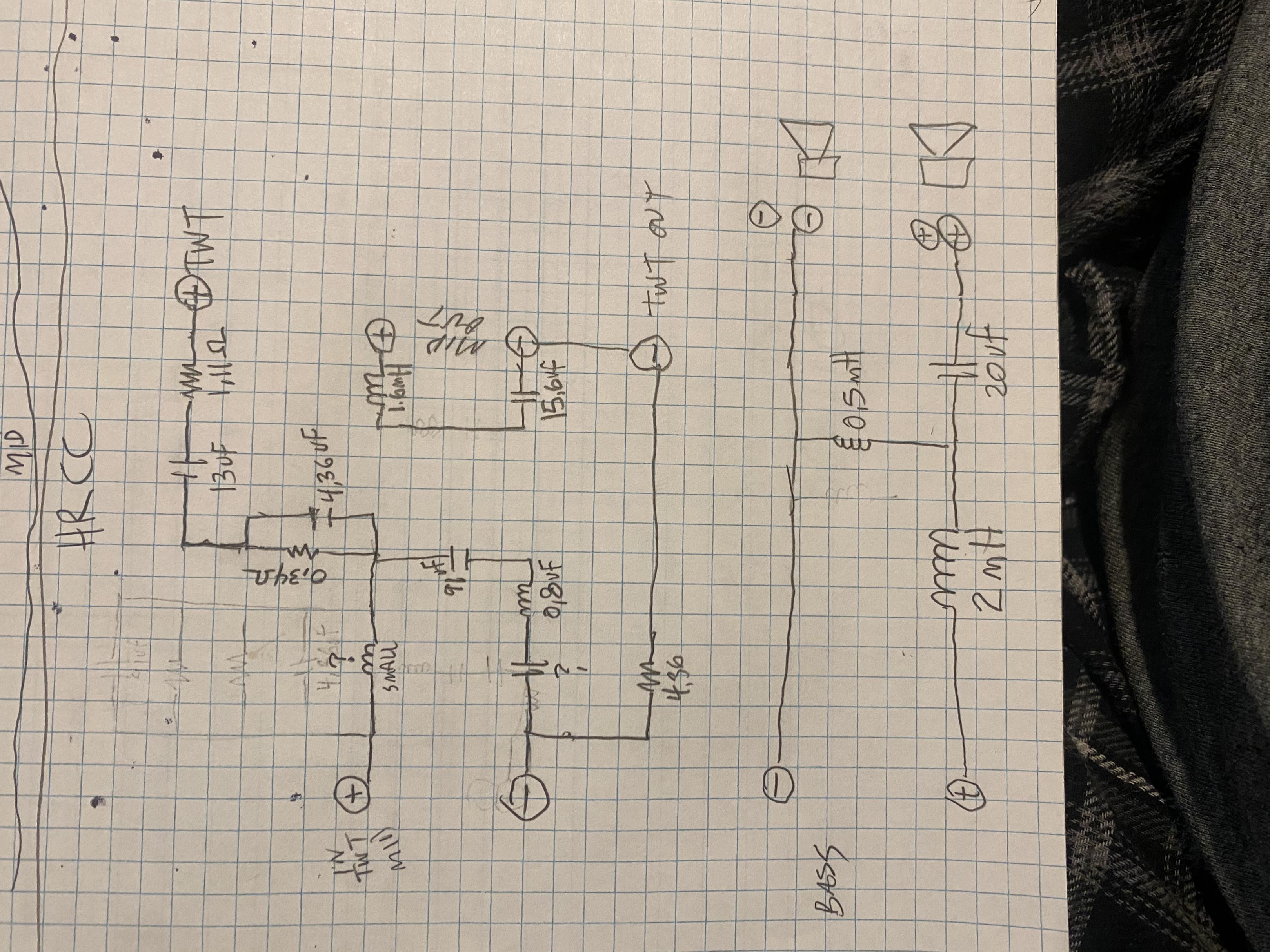

I have a few Dunlavy SC-1's and plenty replacement drivers for each.
I have recently purchased a few Scanspeak 25W/8565-00 10"drivers and have been considering building cabinets to house a 10" woofer above and below an SC-1 to make it similar to an SC IVa , Or as I already own a Dunlavy built HRCC crossover (driver matching aside) Build an HRCC center channel and I have enough Scanspeak 10" woofers left to build a pair of "pseudo" Dunlavy Alethas, They are similar to an SC-IVa
The difference is an Aletha has a single 10" woofer firing down and a SC-IVa has 2 10" woofers firing forward.
My general question is: would doubling my inductor value and cutting resistor values in half get me in the ballpark of using just 1 woofer instead of two?

The crossovers in a genuine Dunlavy is indeed tailored to it's drivers, so it won't do much good to add different drivers and expect it to work. But it can be done, with some care, measurements and input from this forum. Would you be able/willing to take/make measurements? Key factor of the Dunlavy speakers are their first order crossovers, which usually is one of the hardest types to get right.

As you are talking about a lower crossover, you could make some concessions. Baffle effects are on the out. Response discrepancies can be greater. You could use a higher order crossover.

Just at a thought exercise, Let’s say 2 of the same woofers in parallel requires 1 50mH inductor to give 6dB roll off at 70 Hz does that mean a single woofer to get same crossover point require a 100mH inductor? Electrically?
Yet acoustically the single woofer downfiring would acoustically would require some more tweaking.
I guess the easy way of thinking of it is making a 3 way a 2.5 way.

Yes that is right, however the one woofer would be 6dB lower in level.2 of the same woofers in parallel requires 1 50mH inductor to give 6dB roll off at 70 Hz does that mean a single woofer to get same crossover point require a 100mH inductor?
A 2.5 way is no different except for the nominal disbursement of the duties of each driver.I guess the easy way of thinking of it is making a 3 way a 2.5 way.
You mention 70Hz. Perhaps you are trying to avoid issues in the vocal range. You are also going down into the room controlled region. You could gain benefits without having to cross your main speakers, but the way to do this might be to follow the 'multi-sub' procedure, as long as you stay at lower frequencies.

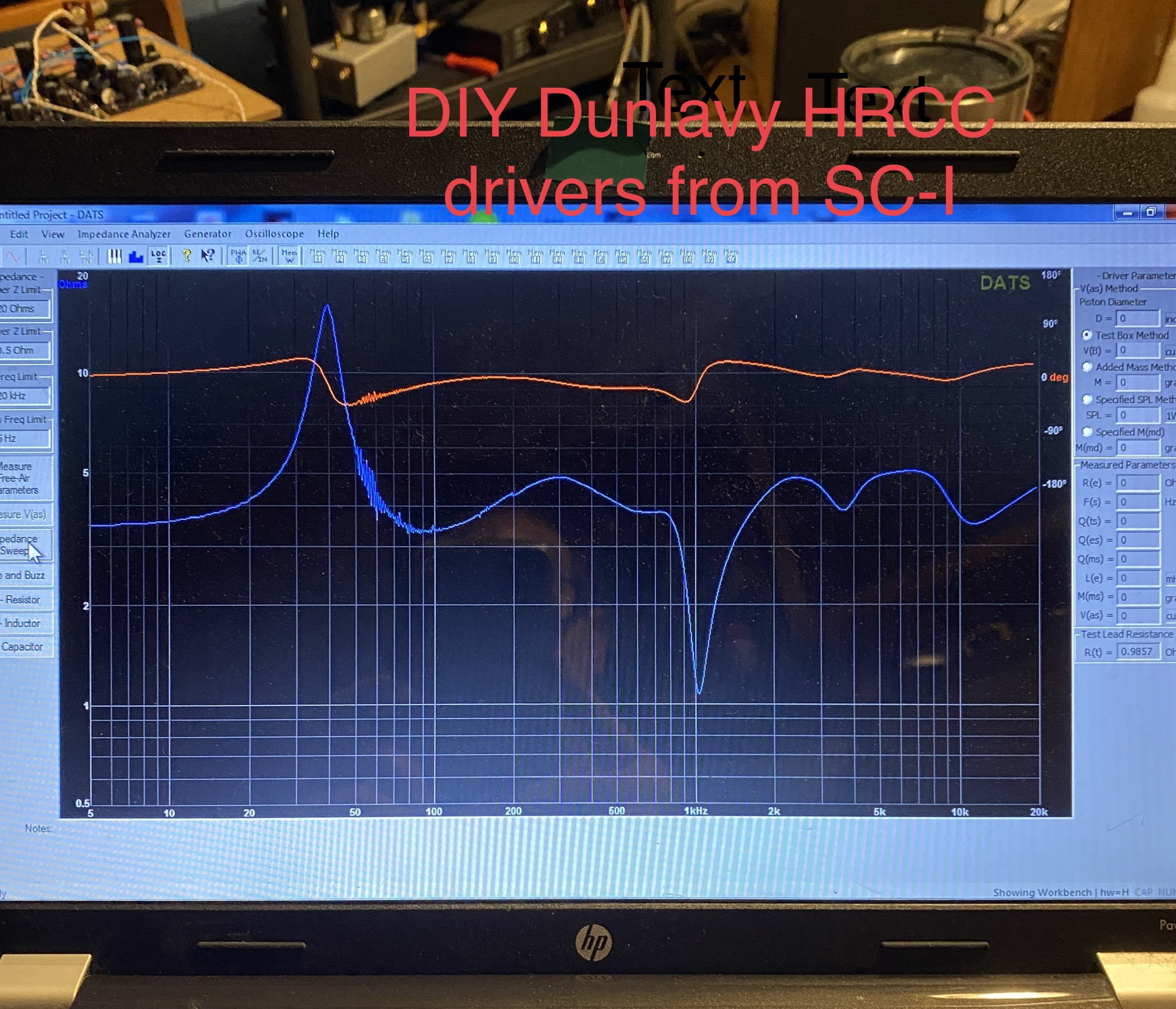

I have since started using REW and purchased a mic.
Hoping to build a test inclosure and will do some measurements.

That Scan bass needs a steep crossover, IMO. Maybe a notch too. I don't think John Dunlavy would have specified it for his style.

Yes I remember JD saying in Stereophile that he has a tough time getting the scanspeak woofer to work in his design.

I have thought to just take the above schematic and just double the mH and cut all resistance in half and go from there, but man those big inductors are expensive!

Johnny, hang in there. Like I say, I'm no expert but I would suggest you not make a bunch of changes based on a hunch. I, and others here, are using Vituixcad 2. It's a bit of a slog at first but it is very fast, robust and produces usable design very quickly.
You should also learn how to use winisd - the 950 version - for cab design. There's a lot going on with speaker in cabinet impedance and it's interaction with your crossover and you need to have an impedance plot that is as close to accurate as you can get before you buy parts.

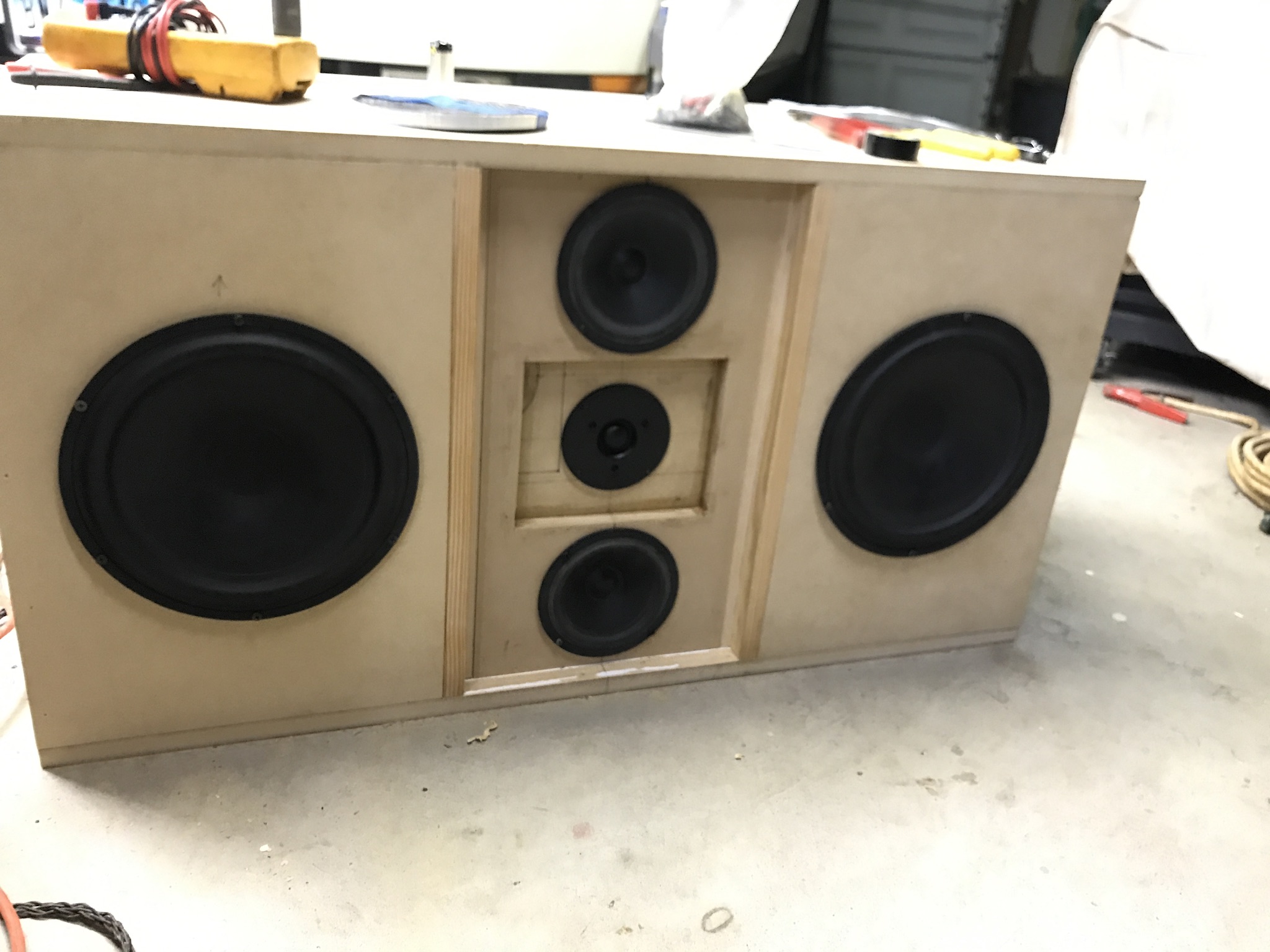

Well, I have started building my boxes that will house the Scanspeak 25w/8565-00
They will be built to act as stands for my Dunlavy SM-1’s to sit on to mimic the Dunlavy

I will start with 14.5mH and zobel and go from there.
I have found many quotes online stating that there was not a high pass from 10” to 6.5” ‘s so this gives me hope of not being too complex.
As the 10” is down firing through slots-almost a band pass fashion it may be easy to hide upper resonance of woofer.
