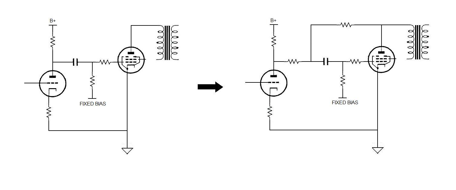

I was investigating about generic feedback and its use and I ran into a particular local feedback loop between grid and cathode of a tube (triode, ecc.). I noticed it's employed especially in certain guitar amps. I wondered if it has any use in tube audio systems too. And how to calculate the the proper cut-off frequency for a generic case. Some informations of the subject are messy.

That appears to be feedback between anode and grid. Sometimes nowadays called "Schade" feedback, although it is actually just ordinary voltage series feedback. See any description of opamp inverting mode.

To work, there must be an input series resistor, or at least a significant output impedance from the previous stage. If driven by a voltage source, the feedback resistor would have no effect.

Yes, this is what J. Broskie - among others I guess - also points out More Hybrid-Amplifier Design Although I understand the high source impedance mechanism and the related formulae, I wonder why in the low source impedance scenario the feedback resistor won't have any effect. OK, the formulae won't apply, but still a feedback loop. What do I miss?
rayma 19th July 2019 08:02 PM
A very low source impedance (with no series resistor) shorts the feedback signal current to ground,
instead of developing a feedback voltage proportional to that current.
