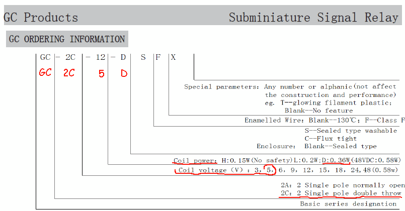

I broke one of these relays:

None of the above. The part is a 5V relay.
Golden Relays site (mostly in Korean)
Dongguan Golden Electrical Appliances Co., Ltd., in English
GC relays datasheet
