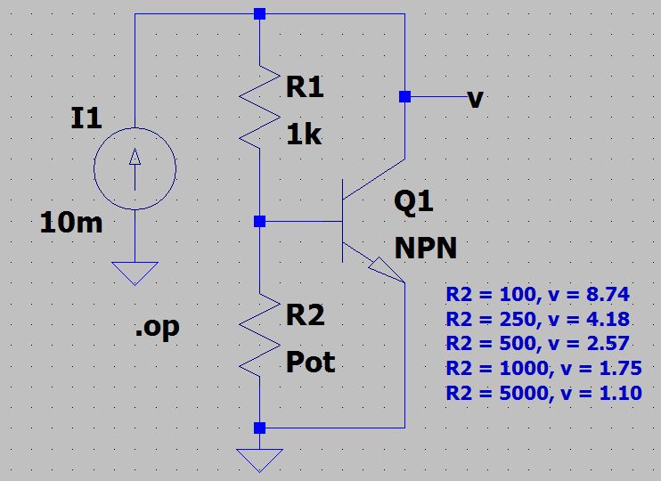

Attached is a typical Vbe multiplier. The pot (rheostat) is normally installed at location R2. As you can see, as the value of R2 increases, the voltage at v (the amount of bias) decreases.
If R2 would totally fail and become an open circuit, v becomes 0.93 volts.
But the pot *could* be installed at R1, or it could replace both R1 and R2 with the wiper on the transistor base. But what I posted seems to be the most common, and is fail-safe.

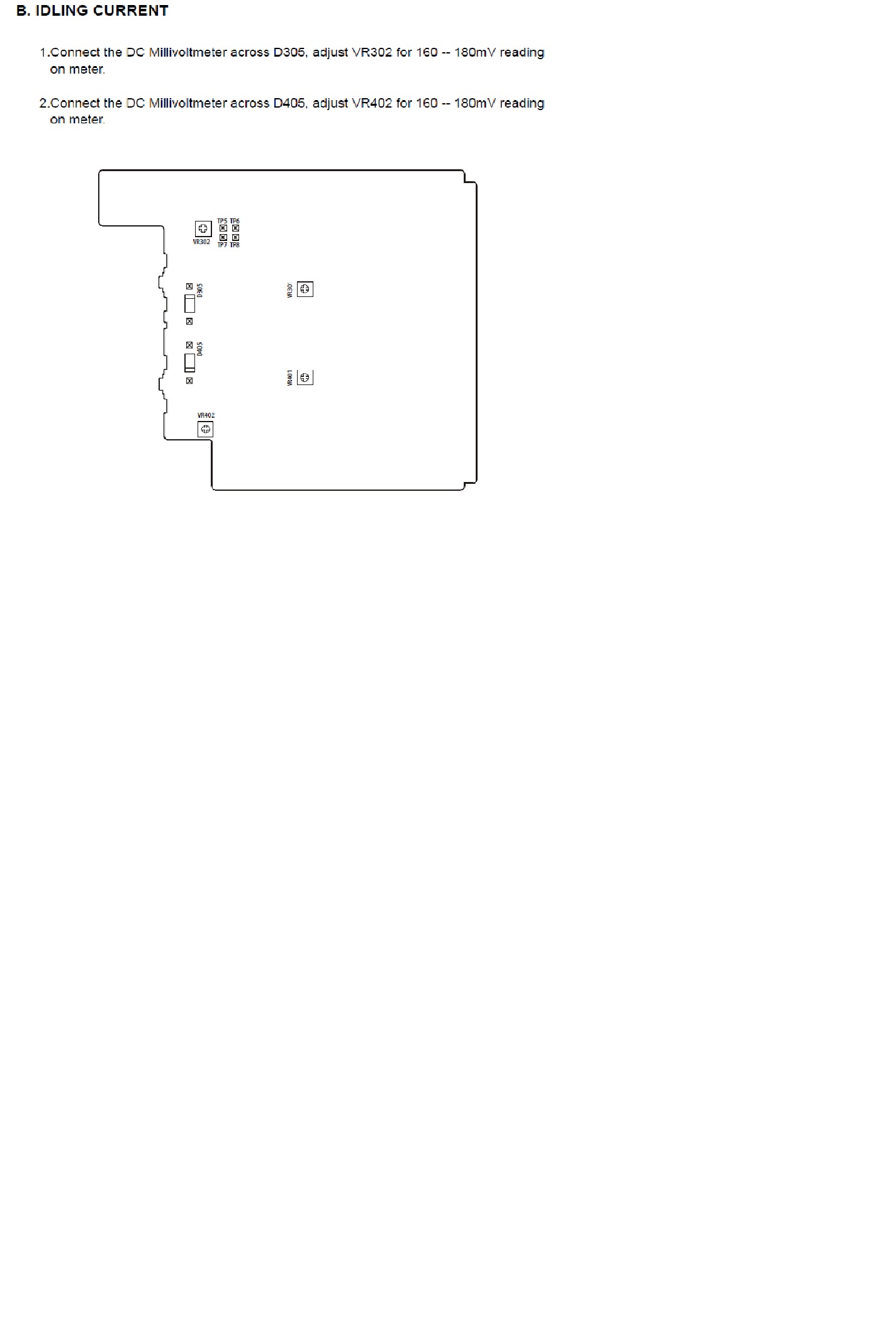

If you don't have a circuit but you thought all Vbe multiplier circuits were the same, then I assume it's a commercial product that you are tinkering with so most likely, the direction is CW for increase and this would be specified in its service manual somewhere. So, what is the make/model?
Alternatively, you could simply power up as presently set if you haven't changed every component in the amplifier already. Attach your multimeter leads securely across one of the large emitter (or source for mosfets) resistors connected to the output transistors. Using the lowest voltage range, adjust the pot. setting slightly while watching the change in the small voltage of only 5-30mV usually. Polarity is unimportant. This is the basic procedure for all bias current setting. You would then be certain which direction, either CW or CCW, was correct for minimum setting.
As the procedure will be detailed in the service manual, there is no cause for concern about reading mV instead of mA since the small voltage drop across the fixed resistor(s) is analogous to current, by Ohm's law.

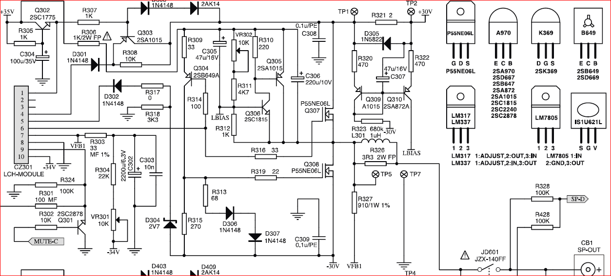

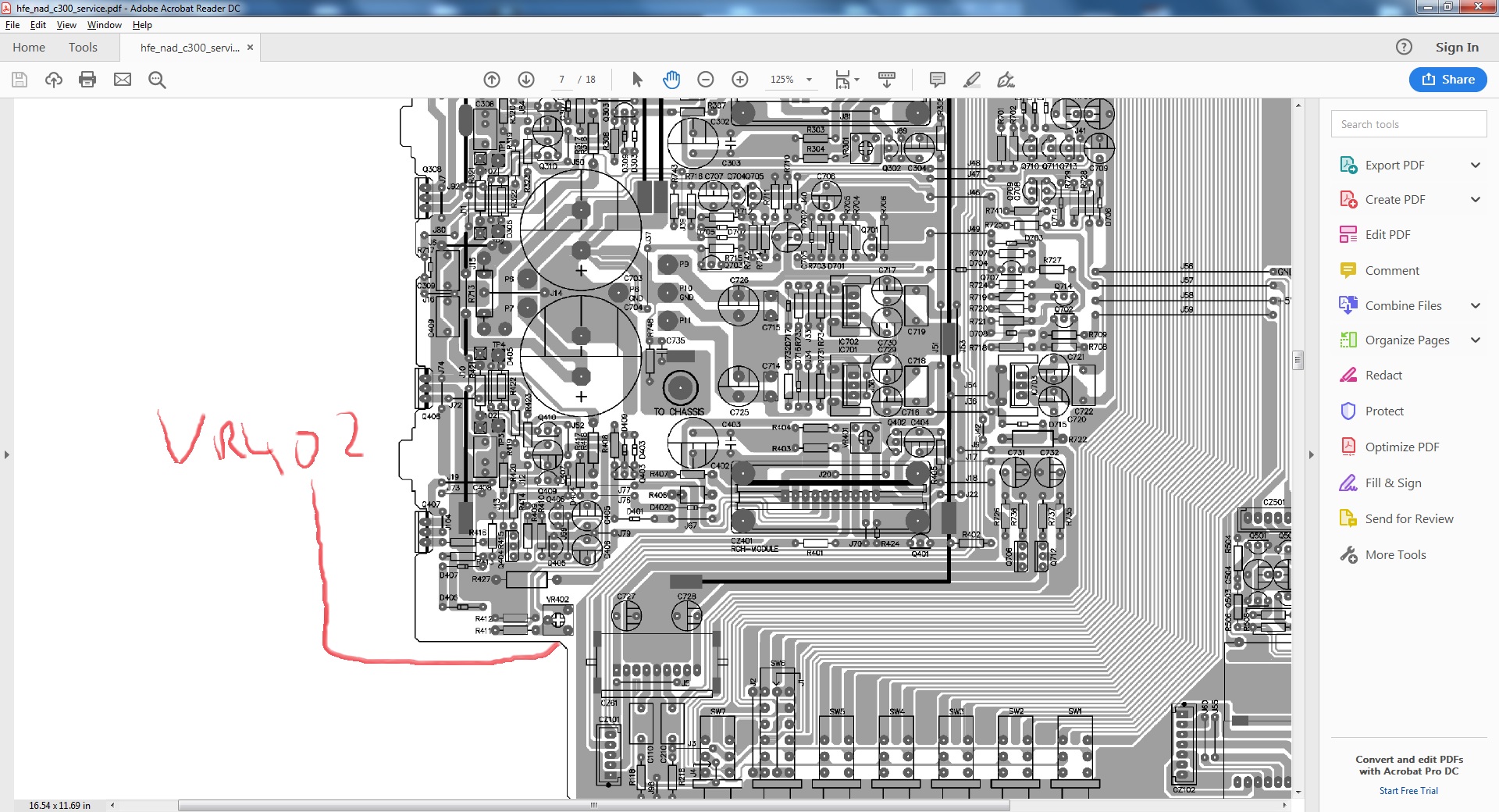

It's just as well that you told us the model because C300 is a mosfet type and this one has no source resistors from which to monitor the bias current anyway. The bias current is controlled by a separate, current regulated power supply and you'll have to assume that its adjustment is CW for increase, facing the top or front face of the pot. as shown on the larger attached diagram.
If you had no cause to adjust it, leave it set as it was previously, since this type of bias controller does not operate like the classic Vbe multiplier. Power up and the bias current will likely be close enough for safe operation as is. Then consider whether any adjustment is necessary.

When amps don't have emitter/source resistors they sometimes remove a fuse and measure the current across the fuse holder in one rail.

That's true, Nigel. Here, NAD used a schottky/resistor combination in the positive supply rail for the purposes of both current sensing and providing test points. Attached is a snip of the amplifier output stage schematic for those with keener eyesight.
