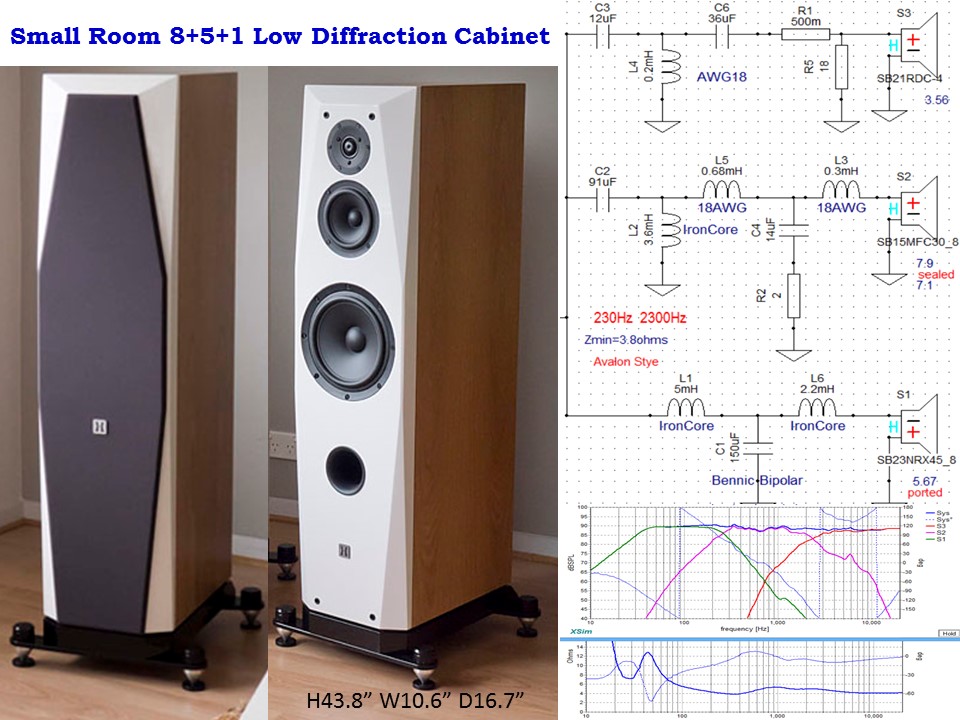

Size? Shape? Construction tech? Designs with free crossover parts values?
A simple well-braced plywood box with a thick front baffle allowing low edge diffraction beveled cuts?
To help focus your personal goals.
Make a long visit to:
DIY Loudspeakers
by
Troels Gravesen, Denmark
"Welcome to my website! Below you will find articles on some of the work done over the last fifteen years."
DIY Loudspeaker Projects Troels Gravesen

Well you asked a good question:
The narrow (10ft) room presents a challenge as early side reflections off the walls are not good for speaker imaging. The corner placement in general is a bad idea unless we are talking some CD horns. Horns are good as a woodworking challenge but get really big quickly. For on wall mounting you could try an interesting build like Cornu spiral speaker (also described on diyaudio).
You can either go with tall and slim arrays on the far (opposite) wall and have those play back at you over the length of the room.
However, if you want to beat any commercial-like speaker, you would be stunned by the clarity and the lack of colorations in a super slim package with LXmini speakers (designed by the late Siegfried Linkwitz). And then you can add a subwoofer separately later on some place in the room.
These are not a woodworking challenge (unless you make it so in your version). They are also an active speaker which means they require a digital crossover (MiniDSP 2x4 HD) flashed with Siegfried's file and they require 4 channels of amplification. i.e. two stereo amplifiers (plus one channel if you decide to add a sub).
for commercial-like DIY passive Xover designs Troels G is a good reference.

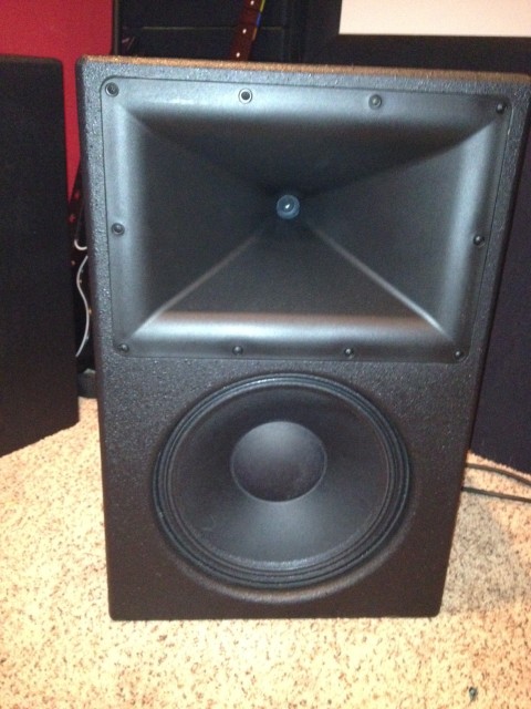

For Barney's 10' x 20' sized room a CBT24 array will have important characteristics. Don Keele reports that his CBT arrays exhibit 3D sound radiation with constant beamwidth, constant directivity, constant coverage, and constant radiated power. Thus anywhere within the space of his shop will have exceptional sound. No small sweet spot but anywhere within the shop: he will hear great sound throughout.
You not forced to sit in a single chair which is carefully located to hear optimum sound.
Popular horn tweeters have a controlled directivity of Horizontal = 90deg and Vertical = 40deg. If you overlay the L=90H x R=90H patterns on your floorplan, you may be able to focus this soundstage to the work area and avoid some side equipment reflections. If you mount the speakers on the wall, the 40V can reduce floor and ceiling interactions. A large number of free EconoWave designs are available. A 12" midbass with a 1" compression driver would fit your room... could be mounted on the walls.
The $76 12" paper cone Dayton DS315P has been used with a few compression drivers + horns for $200 - $250 per speaker for parts. On the wall, the -F3 is 35Hz. I have proven crossover schematics. PartsExpress has all the parts.
The 12" Eminence KappaLite 3012HO for $202 is one great sounding upgrade.
$202 Eminence KappaLite 3012HO midbass
$65 Peerless 1" compression driver DFM-2544R00-08
$13 B-52 PHRN 1014 waveguide
$40 crossover parts
$320
