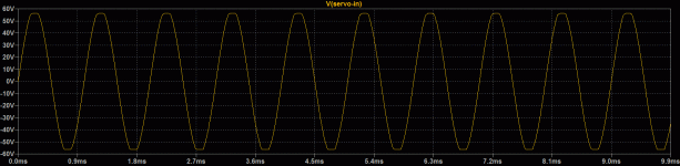

250W under 8 Ohms, 500W under 4 Ohms.

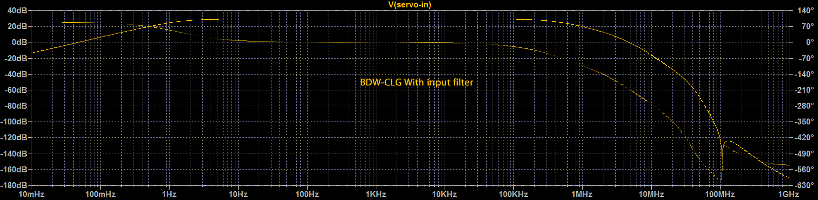

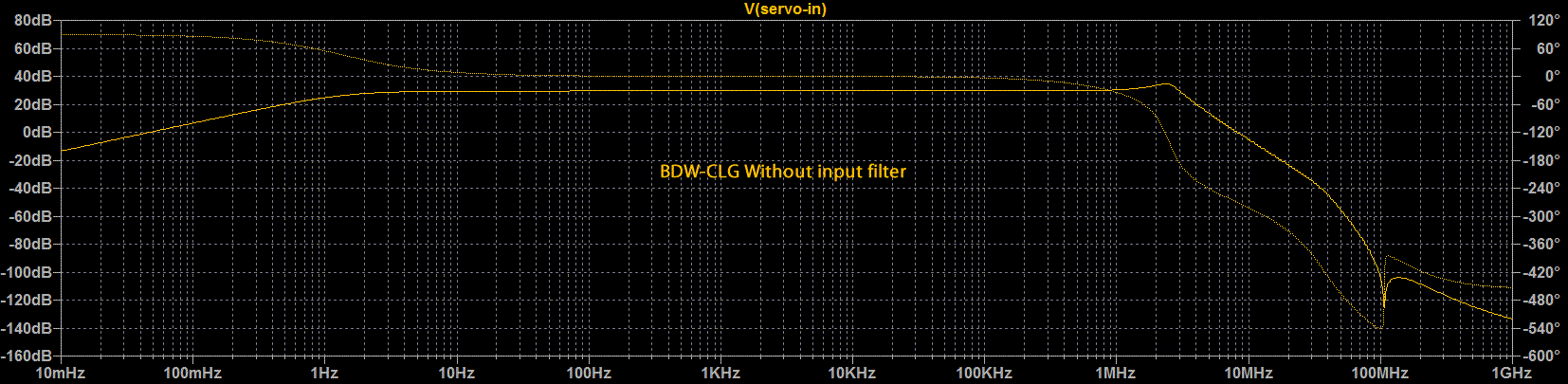

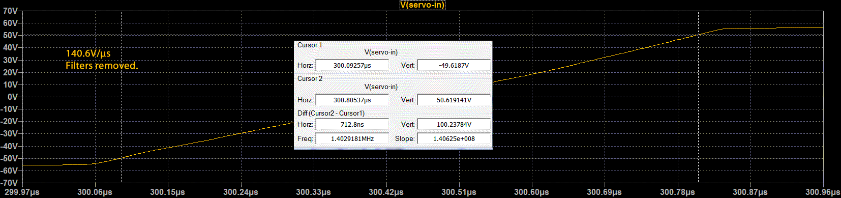

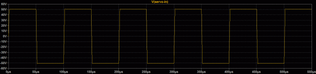

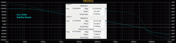

Bandwidth, without low pass input filter: 10MHz (-3dB)*
Phase margin: 60°, gain margin: 13dB.*

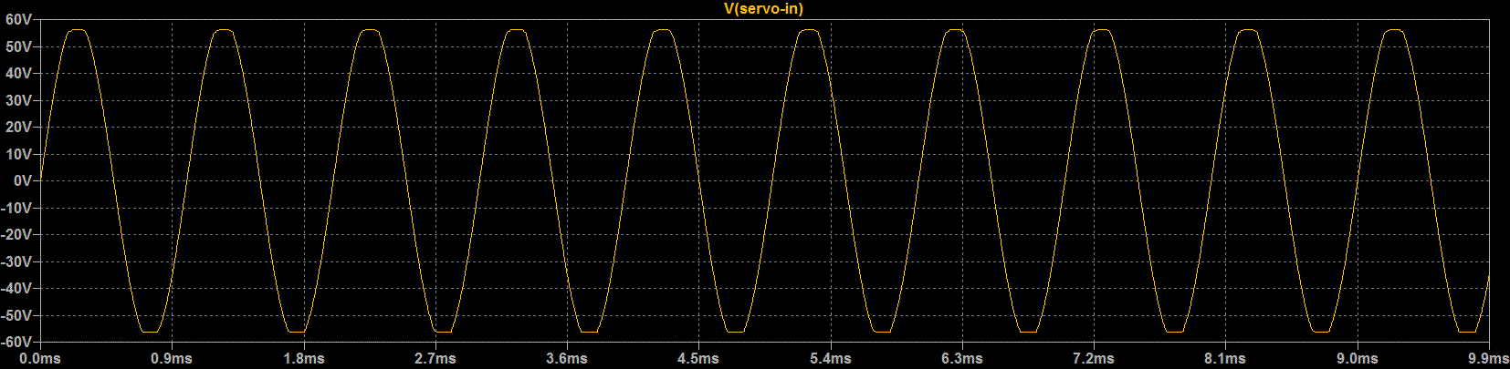

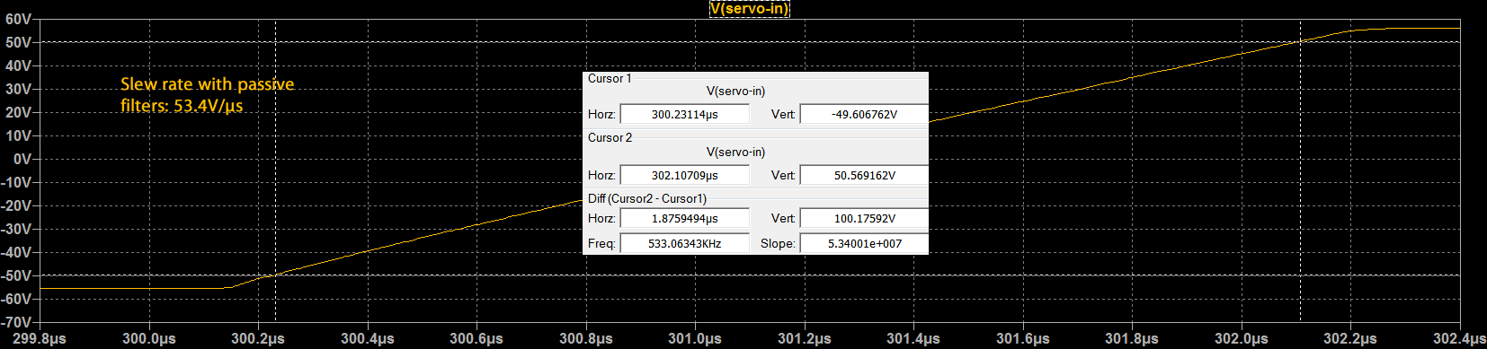

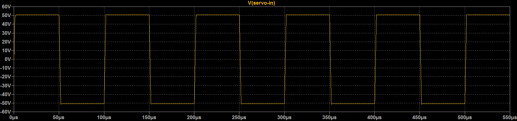

Slew-rate*: 240V/µs (*to be adjusted on the bench)
Loop Gain >100dB up to >1KHz.
0.000002% à 1W 8Ohms 1000Hz
0.000010% @100W
0.000020% à250W

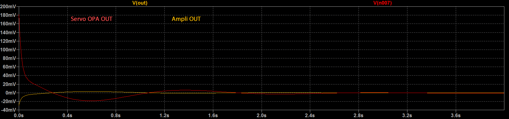

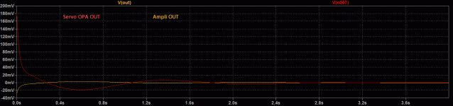

DC coupled with optional added error correction, original Servo, very fast protection(25µs) against DC, internal failure, clipping, oscillation etc that will protect both amp and speakers.
The protection is in Post 378.

This version (V) is treated like a VFA, but keep the "expansive" behavior of a CFA and high slew rate. May-be a more traditional CFA version (C), with a flat loop up to 10KHZ will come to can figure out if any listening difference. And get an idea of the thresholds of audibility of distortion, if loop gains makes a difference on the amp's character and listening experience etc.

What makes CFA amplifiers sound higher definition is the possibility of having higher open loop frequency response . 20khz is very common . You have adjusted it as a VFA op amp of only few hertz.
It is an interesting subject. But I'm not sure. I Made decades ago, a work of comparison IRL. My conclusion (subject to change) was it was not so much the OLG or the ultra high slew rate than the "current on demand" that, probably, makes the character's difference (If any ;-). Who knows. Here, I was mainly focused on distortions. And, I agree, at the end, a little disappointed by the slew rate on the paper: We will see in the listening room.

For better power supply rejection blocking caps C14/15 should not be tied to gnd, but to the corresponding supply rails.
Miller caps should not end at power out, but at the collector of the VAS. This avoids stability issues caused by the output devices.
Considering stability in the critical range of 10~30MHz there must be some room for improvement - for instance driving the gate with an emitter follower without gate resistor is sub optimal.
