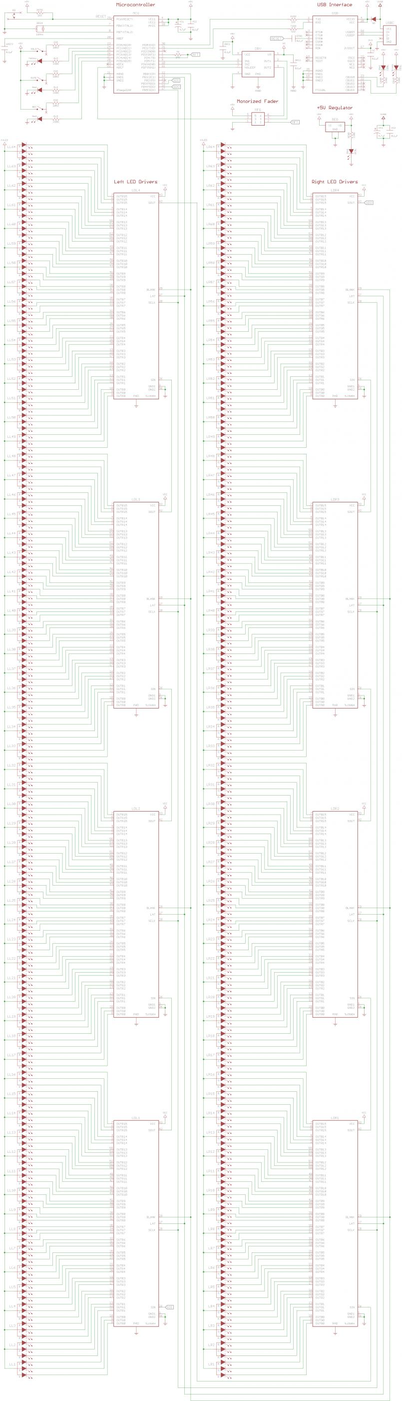

I am currently working on a modular audio interface with the following specs:
- Dedicated ADC board powered by 1 XMOS XUF232-1024-FB374 (isolated)
- Dedicated DAC board powered by 1 XMOS XUF232-1024-FB374 (isolated)
- 8 balanced mono inputs (XLR or mini XLR, TBD)
- 8 balanced mono outputs (XLR or mini XLR, TBD)
- 8 AK5578EN 32-bit, 768kHz, 130dB ADC chips in mono mode
- 8 AK4499EQ 32-bit, 768kHz, 140dB DAC chips in mono mode
- 192 OPA1612 Op Amps for input channels
- 64 OPA1612 Op Amps for ouput channels
- TOSLINK S/PDIF + ADAT Input
- TOSLINK S/PDIF + ADAT Output
- 5-pin LEMO Jack Clock Input
- 5-pin LEMO Jack Clock Output
- CC-BY-SA-3.0 Open Source License (Hardware + Software)
I am making good progress, but I have a few questions:
# Op Amp Selection
- Is the OPA1612 the best option?
- Would the OPA2156 CMOS be a better alternative?
- Should I give the mysterious RT6862D/RT6863 of the Khadas Tone Board a shot?
# Input Buffers Design
I am designing the DAC board following AKM's reference design, which is making things pretty straightforward. Unfortunately, the ADC reference design is using the obsolete NJM5534. Where could I find a reference design for an ADC input buffer using the OPA1612 or any pin-compatible Op Amp?
# Connectors
For many applications, the small footprint of the mini XLR connector is really attractive. Unfortunately, it is more expensive, less reliable, and less versatile (male versions cannot be found in certain for factors). Therefore, I am inclined to mount the input and output connectors on separate boards. When doing so, how should I design the connection between these connector panel boards and the ADC and DAC boards?
# Shielding
Should I shield the ADC and DAC chips? If so, which other passive components should be covered by the shields?
Just for kicks, these interfaces will be connected to a Xilinx XCZU15EG-2FFVC900I FPGA with 3,528 DSP slices for low-latency/low-jitter sound processing, using an Enclustra ME-XU7-15EG-2I-D12E System-on-Module mounted on an Enclustra Mercury+ PE1-300 base board. And for the user interface, I will use a Khadas Edge mounted on a Khadas Captain. All this goodness will be released under CC-BY-SA-3.0 as well.

That looks like the wrong reference design for use with AK4499. It's different from the earlier AK44xx chips in multiple ways, current out instead of voltage out is a big difference, as one example.
ishizeno 6th July 2019 07:14 PM
Quote:
Originally Posted by Markw4 (https://www.diyaudio.com/forums/digital-line-level/339929-8-ak5578en-8-ak4499eq-adc-dac-boards-post5844162.html#post5844162)
I am using the reference design provided on Figure 83. External I-V Conversion Circuit Example (Mono mode), page 110 of the 019001308-E-00 document provided by AKM upon registration for the AK4499EQ.
Markw4 6th July 2019 07:22 PM
The document I have for AK4499 Rev. 0 Evaluation Board is akd4499-b0-01e. That shows the Reference Voltage power supplies (similar to Jung regulators) and other necessary things that are also different for AK4499. I/V conversion is only one of multiple issues.
ishizeno 6th July 2019 07:28 PM
Ouch! I did not know about this evaluation board. Any idea where I can find more information about it? At the very least, which Op Amp(s) are they using for it? And do they provide more information about mono mode?
