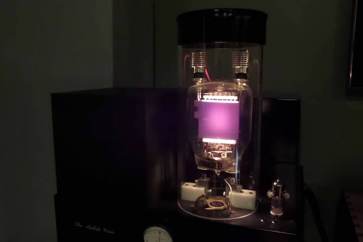

Iím trying to understand the point of an 845, 211, 805, etc. amplifier. Let me explain:
From what I understand, all things being equal, and assuming competent circuit design, parts quality, etc. the more gain stages an amplifier has, the less likely it is to be linear. And, from what I understand, generally speaking, the more transformers involved in a circuit, the more it will suffer from transformer-based distortion.
Iíve never heard such an amp, mind you, so maybe the proof is in the pudding. But as a general observation, all of the amps that Iíve seen that use these tubes in their power section are all preceded by something like an input tube such as a 6922 or 12ax7, followed by a 300b or 6L6 section (described as the driver section), then followed by an 845, etc. Or, it omits the input section and requires a separate preamp. In any event, all of such amps seem to have a veritable village of transformers stacked around these tubes, or because of weight and space limitations, stacked in a separate case.
Are these amplifiers really more linear than say, a El34 ultra linear amp running in class A designed with, again, a quality circuit, parts, etc.? Is there something super special that Iím missing in an 845 SET amp (line magnetic, for example) that canít be achieved in a 6p15 SET (Decware zen Torii, for example) plus a quality subwoofer?

The "super special" that can't be acheived with a Decware or similar amplifier should be quite obvious- it isn't a big, huge, hot "statement" of an amplifier the same way the impractically heavy and large amps are. For some folks they have a biting desire to simply make something that way, so they do.
While the car they drive is different than yours, and the road they drive is different, they still aim to take the same journey to audio enjoyment. It's fun, it's ridiculous, and it's expensive. It's all valid to an extent.
