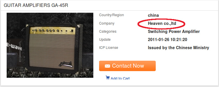

Cute little amp. I dug around and found the completed ebay listing for this unit:
Gitarren Verstarker - Dragon Audio - GA 45 R -mit eingeb.Lautsprecher- zum 2.Mal | eBay
The closeup photo of the controls shown in the listing reminds me of a old Peavey Rage but with a reverb knob added. It would not surprise me if you opened this up and found a 4558 opamp pair in the preamp driving an ST TDA2040 power amplifier loaded with a 3 or 4 ohm speaker.
Stph
It's the same photo...
There are several photos, and they are much bigger than the one the OP posted (mouse over to zoom in.)

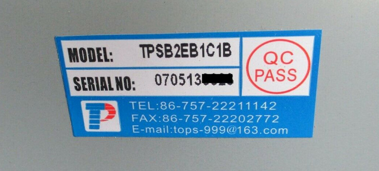

I found contact details for the manufacturer (or maybe only the reverb tank manufacturer?) on one of the images - phone numbers and an email address (see attached image). I would suggest following up on these, see if you can get a schematic or any other useful information.
Stephen Keller's input is very interesting too. Nice detective work! :)
-Gnobuddy

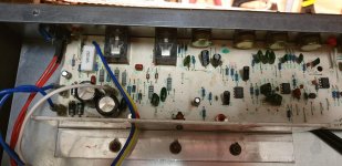

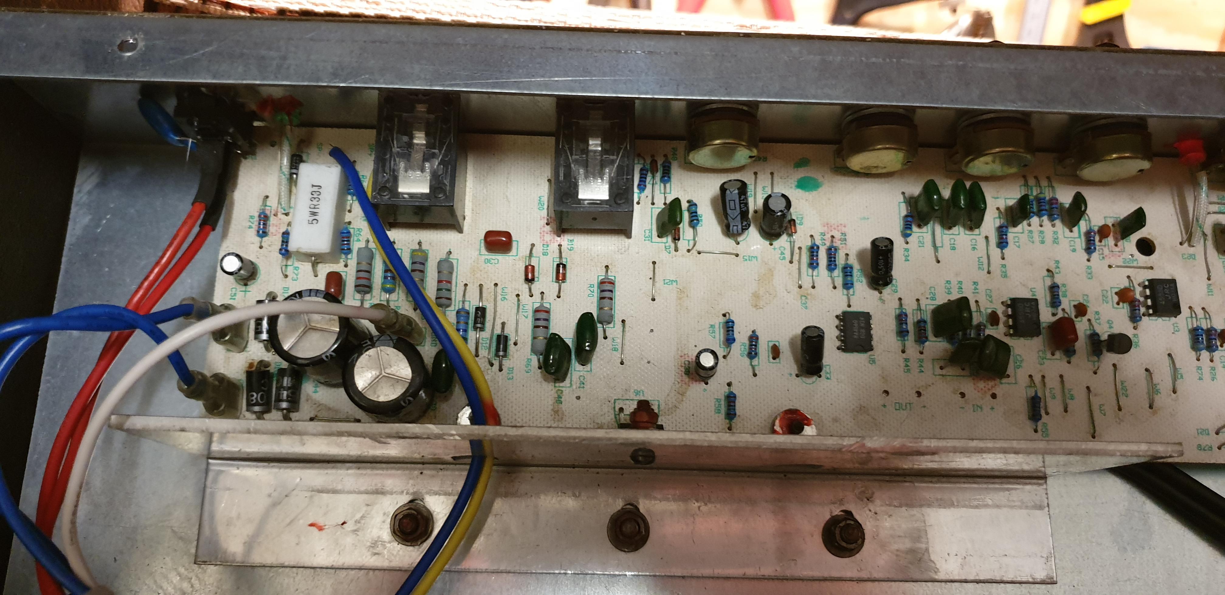

So here's the pic of the PCB.
I notice some of the electrolytic capacitors are lying almost on their sides, instead of standing vertical.
They may simply have been installed like this at the factory, in which case there should be no problem.
But if they were installed vertically and later pushed over by some clumsy person working inside the amp, there is a chance that one of the wire leads underneath the capacitor broke. Depending on the function of that capacitor in the circuit, this could cause hum (if it is a filter cap that normally removes hum from the power supply lines.)
So there's a small chance that your mysterious clean-channel hum is caused by one of these capacitors having been damaged by mis-handling.
I suggest carefully looking at the leads under each of the capacitors that is bent heavily to one side. Don't move the capacitor unless you have to, as you don't want to break leads yourself! Just check and verify that there are two unbroken wires running from each capacitor into the little holes in the PCB.
