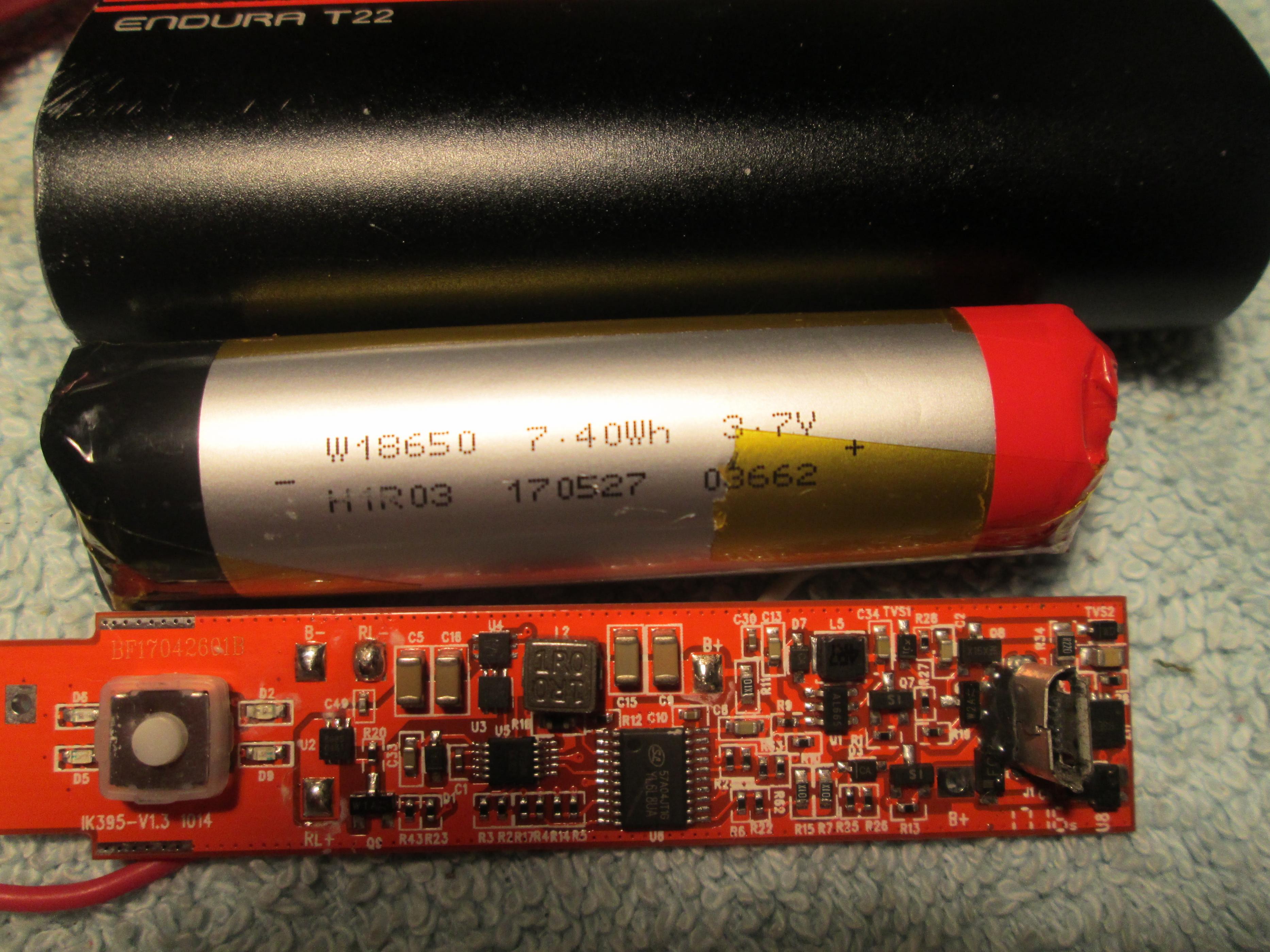

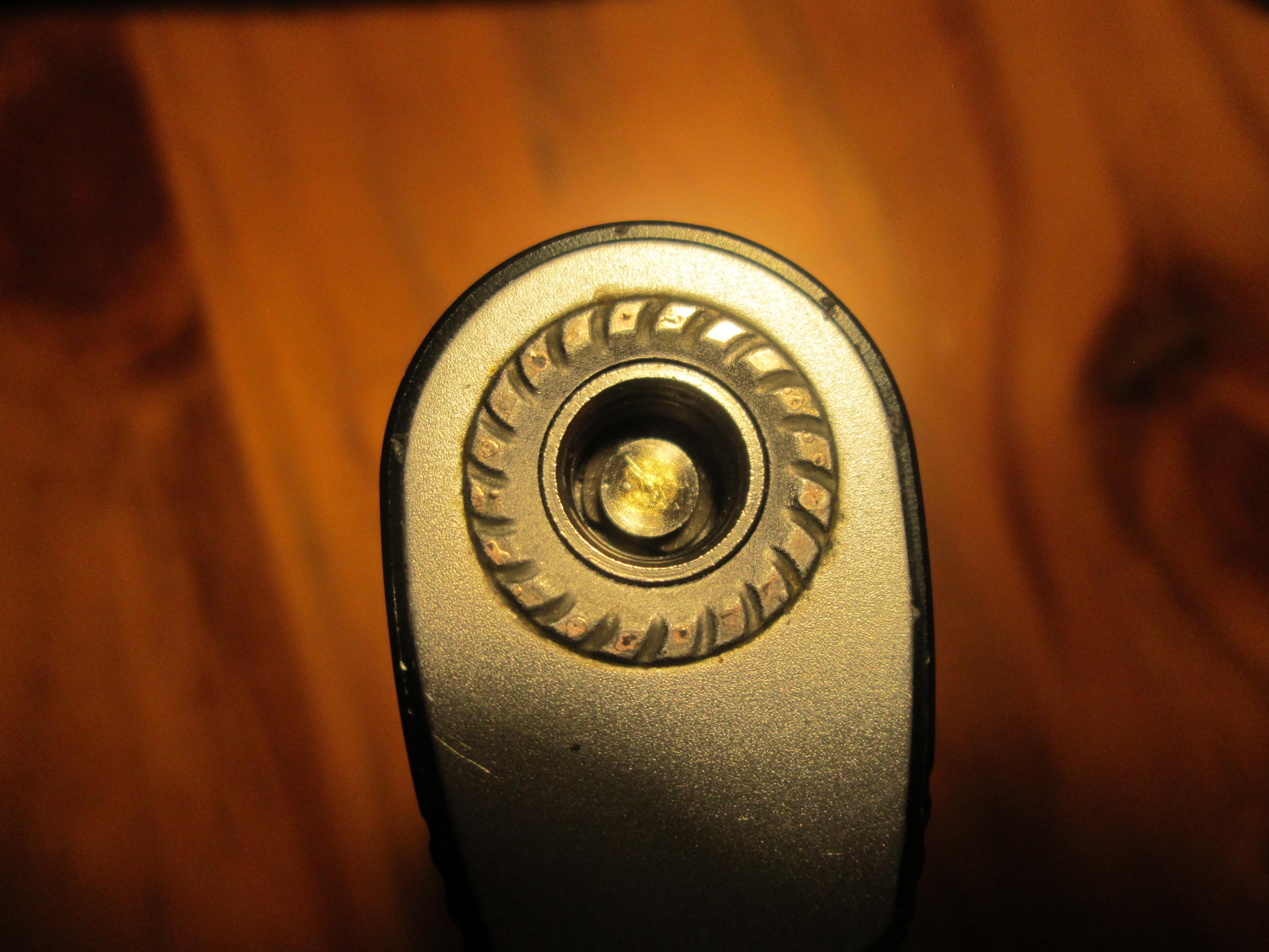

redrooster 5th October 2019 05:24 PM
1 Attachment(s)
Now I've got a vape that consists of 2 x 18650 batteries, it won't charge but I can't figure out how to kick start it? The anode is pushed down to make the connection when the top is screwed onto the batteries. I've pushed down with the positive probe of my Multimeter and grounded the black probe to the edge of the hole with no results? Any ideas on how would I get around this one?
