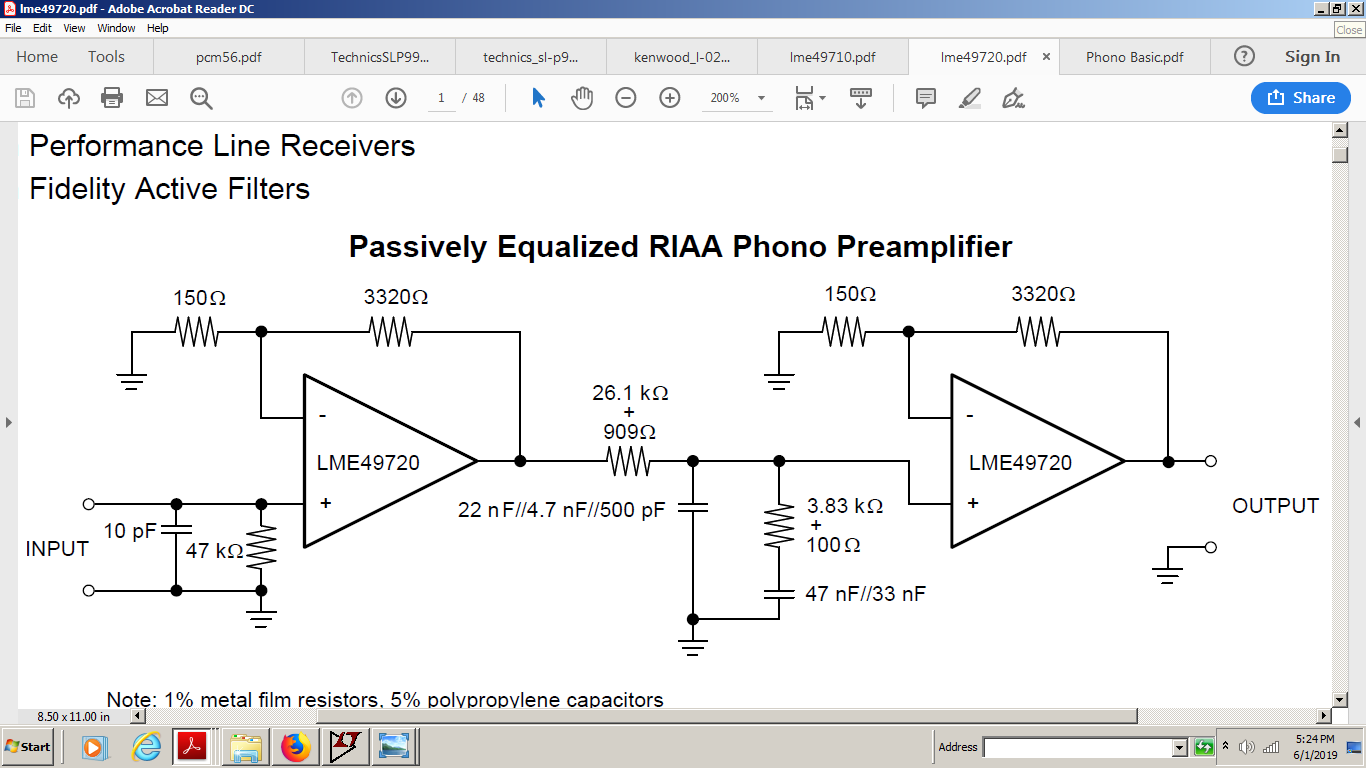

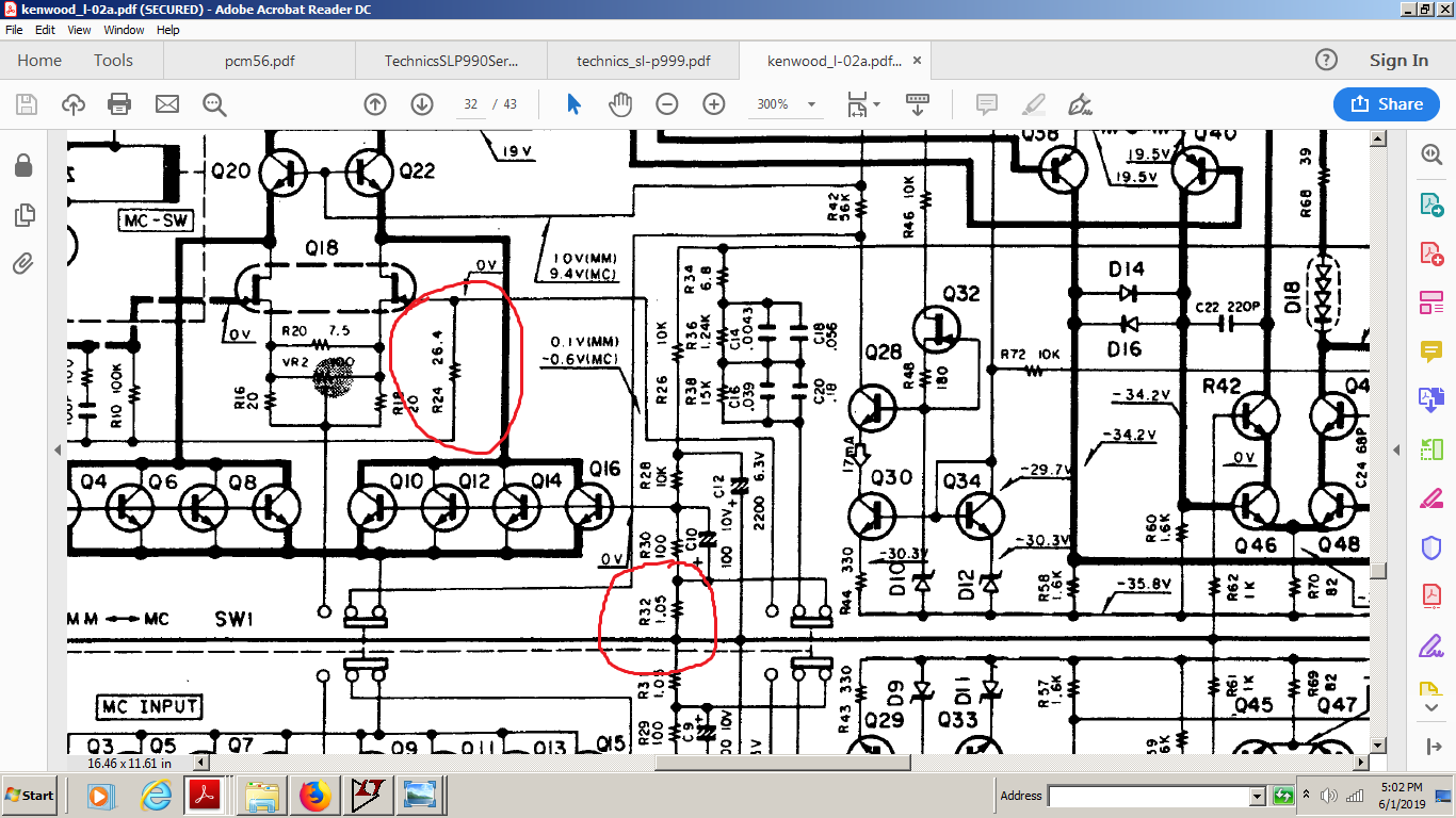

The inverting input has very low value resistors to ground. Would it be prudent to raise the value of these resistors to better match the non-inverting inputon both(!) inputs
Also would then the switching to change the gain be on the feedback resistor itself as opposed to the one going to ground. I realize that both will change the impedance of the inverting input, but would it make any difference to noise?

Looking at the values in dreamth's post, I really think they are at optimum as they are - LM49720/NE5532 type bipolar input opamps will give you as good a result as you are going to get given the source resistances.
The noise issue you experienced earlier after you swapped the opamps out may have been due to oscillation - I am not familiar with the TI OPA type devices, but looking at the 2nd opamp, I don't see any series resistor (typically 47 to 220 Ohms) in series with the output - this is required to isolate any cable capacitance. If you don't do this you can get instability problems arising from the cable/load capacitance.
One thing you could do to try to quieten it down is raise the front end stage gain (is currently 23x) and reduce the 2nd stage gain (its also 23x thus the total gain at 1kHz is ~529) so the total input to output gain remains the same. So for example change the first stage gain 150 Ohm resistor to 75 Ohms (wire a second 150 Ohm in parallel with it) and increase the 2nd stage 150 Ohm to 300 (wire another 150 in series with it).
The passive EQ that sits between the two stages attenuates signals above 2120 Hz at 20 dB/decade. By putting the higher gain up front, you 'shift' some of the the noise behind the 2120 turnover frequency, and that will reduce your overall noise somewhat.
You will sacrifice 6 dB of overload with the above suggestion, but I doubt you will run into any problems.
I can't do this preamp, but fro future reference.
For the second op-amp, you could connect an RC network that resembles the impedance of the passive correction filter in series with the negative input, or you could use a more suitable op-amp. The LT1028 is exceptionally bad regarding current noise with unequal impedances.
