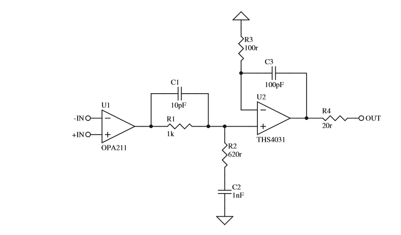

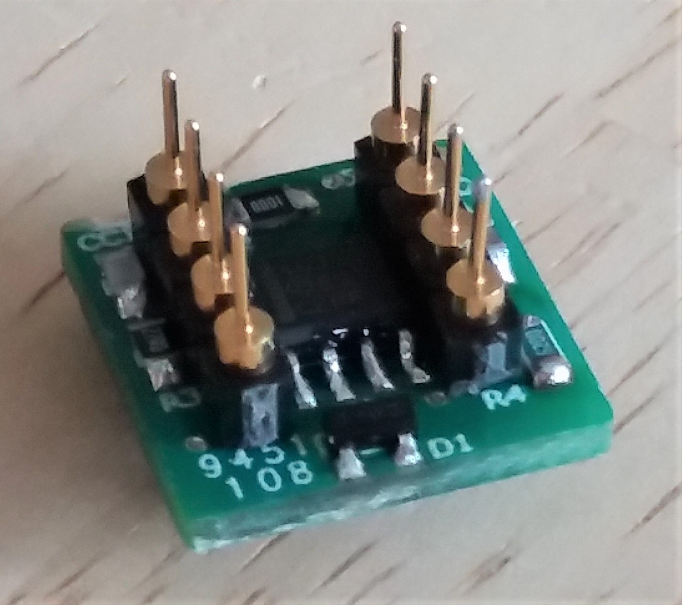

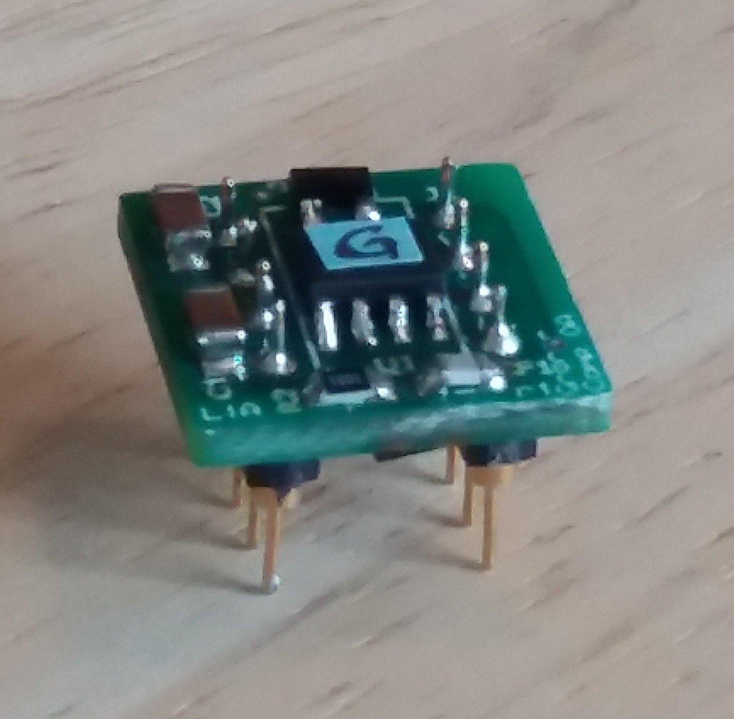

In 2017 Samuel Groner, with Martin Polak, published a new composite opamp design: Journal of the Audio Engineering Society ENGINEERING REPORTS, Vol. 65, No. 5, May 2017: Low-Distortion, Low-Noise Composite Operational Amplifier.
Late last year I was looking for a very low distortion opamp and thought I'd give this a try. I laid out a small adapter PCB for a DIL08 foortprint, see pics. The result was all I expected, an opamp with distortion specs literally out of this world. I was not able to verify the claimed THD < 180dB (yes you read that correctly) but got numers at -160dB and better.
I'll post measurements in my next post.
Anybody here build this as well, experiences?

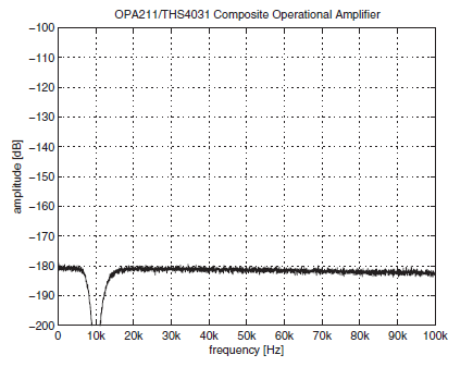

Attached is Samuels' own measurement. Boring ;-)

Interesting.
Both OPA211 and THS4031 are well known for very low distortions, but it is obviously the huge loop gain that is responsible for -180dB distortions.
Since I don't have access to the JAES paper, could you post a few details about:
a) Is this composite op amp unity gain stable?
b) Any results about the open loop gain and phase?
c) Any details about the response in capacitive loads?
d) How was -180dB distortion measured? Is -180dB @ 10KHz as suggested by the graph?
e) Is the -180dB number in inverting or non inverting configuration? That is, are the common mode distortions included or not?

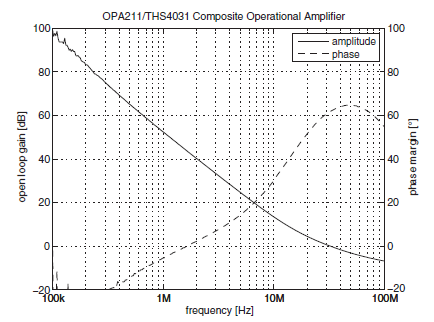

AX tech editor
Joined 2002
Yes, those are the important questions, right. A text excerpt: "First and foremost, it should be appreciated that the novel composite operational amplifier is conditionally stable only. Sufficient phase margin is (except at very low frequencies) only available near the unity open-loop gain frequency. The composite operational amplifier must thus be operated with a unity loop gain frequency close to the unity open-loop gain frequency. In many cases this implies the use of an additional feedback capacitor instead of a purely resistive feedback network." I had no stability issues with 22p across Rf. There is also a diode clamp on output of the 1st opamp to avoid it slamming into the rails at switch-on and other transients.

Patrick, the adapter I made has the gnd routed to pin 1 of the DIL08, which I use in the app circuit.
I included some supply decoupling on the adapter between V+ and V- but not to ground to avoid even tiny ground loops.
At -180dB, every electron counts ;-)
And I got pretty good at manually soldering 0805 size parts!

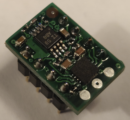

Yes, I have built a version of it. Actually I made a dual version of it on a 10 x 15 mm PCB. Unfortunately I have not found the time to test it yet. Too many projects in parallel I guess :eek:
There are three additional terminals. One must be soldered to ground. The other two are for the clamp circuits. The connection points for these will depend on the external circuit.
I had to use 0402 for some of the components. I prefer not to, but in this case it was needed to keep it small. There are some components on the other side of the PCB as well. The PCB is a 4-layer PCB.

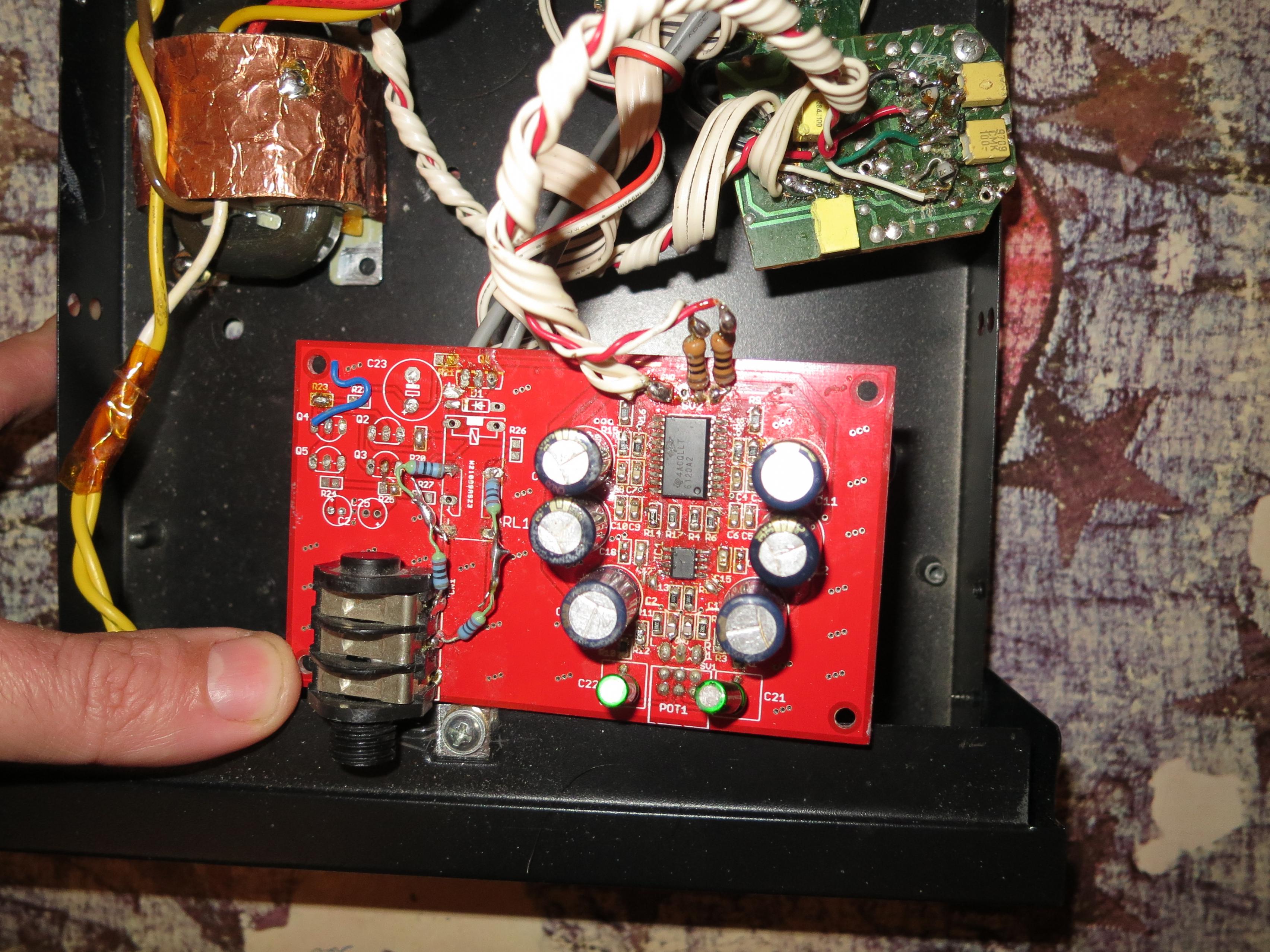

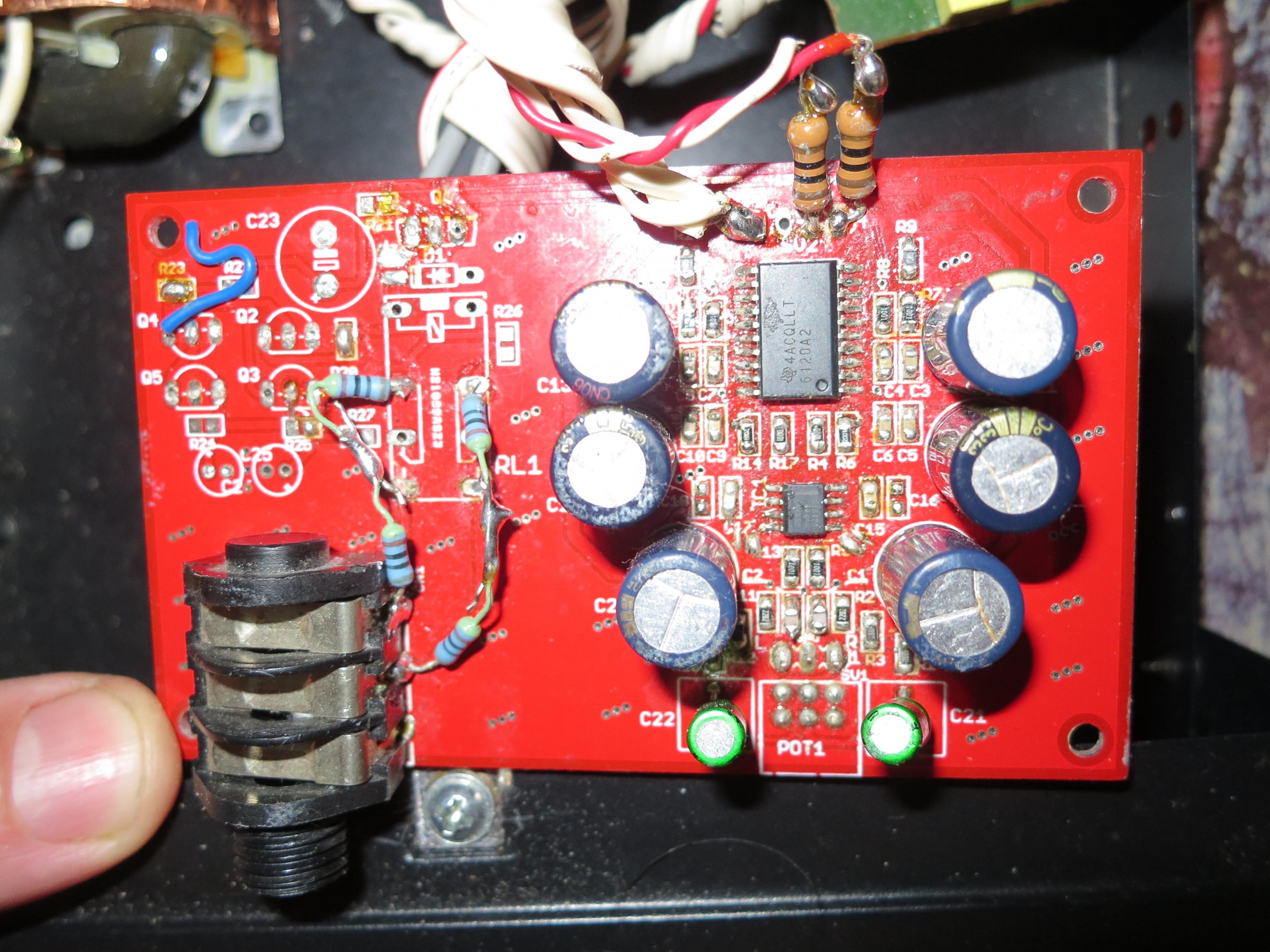

It's 1991 Burr Brown app:
http://www.ti.com/lit/an/sboa002/sboa002.pdf
I have it working in my current headphones amplifier based on this design:
TPA6120 Headphone Amplifier - COMPOSITE TOPOLOGY - DIY AUDIO BLOG, AUDIO WORKSHOP
and modified by a friend of mine for smd input opamp.
I use tpa6120 and opa1642.Of course that opa211 is better at anything just it was too expensive for me.

I have included two BAF199 diodes on the PCB (2 sided) for the clamps. They are really needed, without them the amp starts squegging (remember squegging?).
