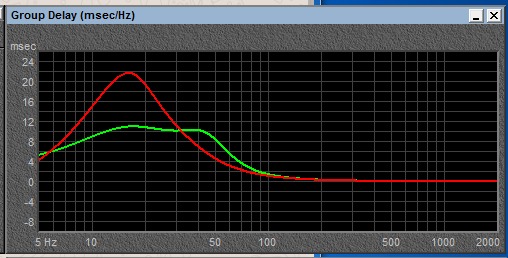

How much GROUP DELAY is acceptable in a PORTED SUB to have good TRANSIENT RESPONSE?
The goal is to design a sub with tight bass to the extent possible.
The sub should work reasonably "ok" for both movies and music in a HT.
I know everything is a trade off in subwoofer design and the room modes play a role too.
But in the design phase, "in a very general sense" what is the maximum group delay we can restrict to?
As an example.... in the attached image, RED is large box tuned to 25hz
And GREEN is small box tuned to 36hz. Obviously GREEN graph has better transient response. But how much group delay is too much in general ??

Actually it’s the red line that has the best group delay not the green.. to understand this you need to know where most of the bass frequencies are in movies and music.
These frequencies tend to be at above 30hz and below 100 hi with a very strong bias for the 40 to 80 area
All these places are where the red line is lower than the green.
Also to throw another one in, the lower the frequency the higher the output has to be for your ears to hear it. And group delay is less important.
So basically, go big and tune low. A 20hz tune is good for movies and music.. the group delay won’t really get going for music

Thats an interesting point. !!! Thanks a lot.

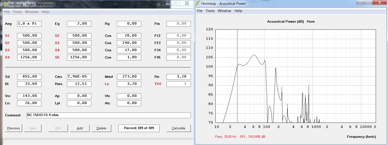

ROAR with Helmholtz front resonator
Layout, prototype of something similar but with another driver and passband, and measurements of the prototype.
With a pronounced peak centered around the midbass you get a very tight punchy and tactile character. Very usable for both music and HT.

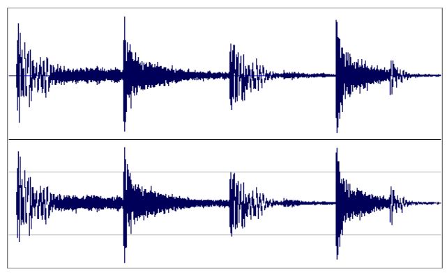

Even bass notes dont build up suddenly and take time. They dont have 'transients', the transient is a higher frequency phenomenon
The why would a well designed basshorn have a better subjective "transient response" when reproducing the bass from a kickdrum then any numbers of 218 BR boxes? (both LP at 100 Hz 24 dB/octave)
Why did audfrknaveen specify "good TRANSIENT RESPONSE" in the name of this thread if bass is only steady state sine waves or similar droning sounds where "transient response" only effect higher frequencies?
The wave shape of drums sure looks like transient peaks with a reverberant decay to me..... Those transients does define the sound of a drum. Take the transients away and it becomes a somewhat complex decaying sinewave oscillator.
And if you want to make the transients a pure high frequency component then please explain how a 1 inch dome can displace the same amount of air as the skin of a hard driven kick drum in a matter of a few microseconds?!?
Agreed.
No, I didnt intend to mean this.
The drum produces a complex music. It has more lows, little midrange and very little treble too. A 1" tweeter CAN reproduce the harmonics of a drum. An FFT can show the frequency spectrum, pls see frequency domain, not time domain. To reproduce a drum faithfully, a much wider bandwidth is needed, from lows to mids to highs. The drum has lots of energy in the lows needing a big LF source to reproduce, this LF source does not need to have the kind of transient response being discussed here. The mid components will need a midrange, and the highs will need a tweeter. The whole spectrum is now reproduced and appears similar to the graph you have shown.

Bass reflex cabinets have relatively poor transient response, causing "smearing" or a longer resonance of the bass notes. Though the sound coming out of the port may have the same phase of that from the front surface, but it can never be at the same time, thus, the extended bass energy is really noise disguised as signal. The disguise works only when the sound is a continuous tone
Bass reflex - Wikipedia
If you want to have a good reproduction of a kick drum, then you have to displace a lot of air in a few milliseconds, in the same way a hard kick to a large drum skin will do.
If the bass driver is bandwidth limited and the midrange and treble is displacement limited then the loudspeaker can not reproduce a kick drum....
And since the bass reflex port will lag in its response to the driver, it can not reproduce the transient part of a kick drum with any reasonably definition of a "good transient response".
An FFT will prove that this is not the case. A drum FFT will show more SPL at lows, little at midrange and very little at treble. The energy is very little energy in the treble even for a drum. Since we are discussing spectrum we need to see frequency domain, trying to explain in time domain is going to cause confusion.
BR Helmoltz covers a very small bandwidth, a spectrum where the human ear is very insensitive to GD. If the Helmholtz energy buildup is quicker than the drum (in terms of LF cycles) then whats the problem? Where is the data that this is a problem and BR fails there?
