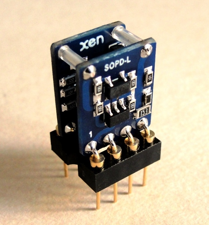

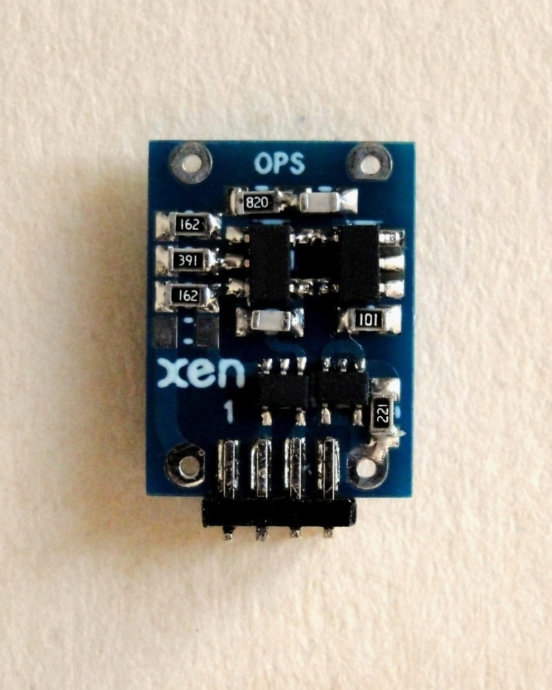

EUVL 4th May 2019 09:06 PM
SOPA
2 Attachment(s)
The first topology that was built and tested, as Dual version.
Patrick

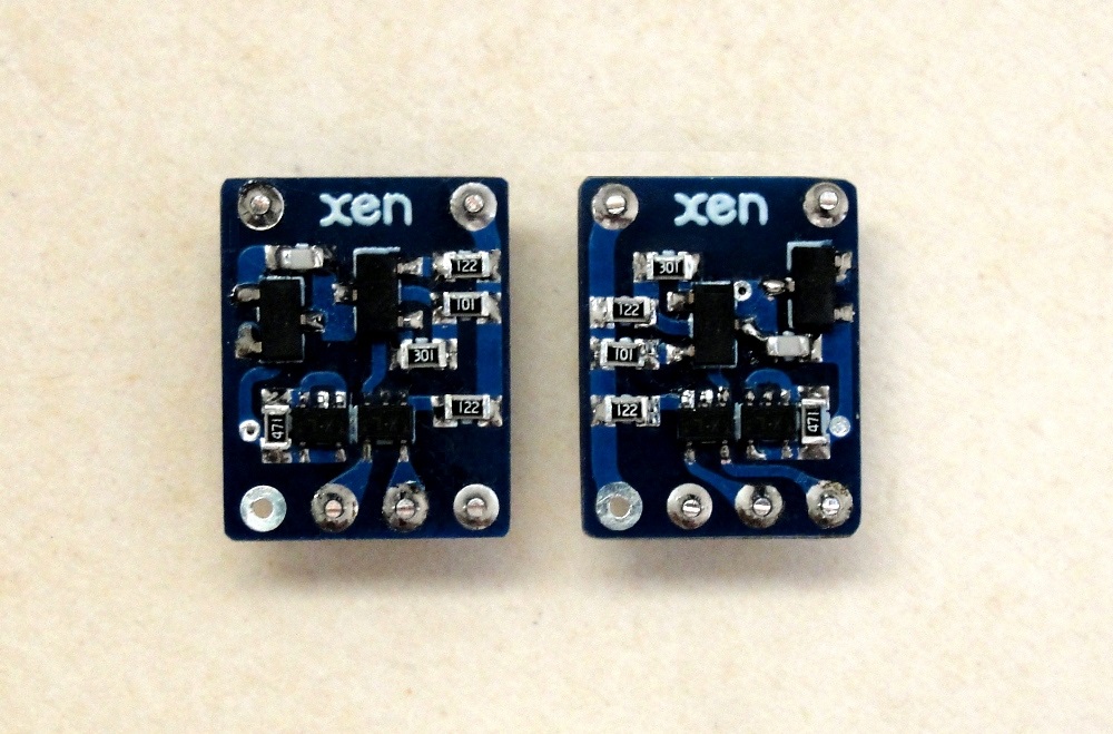

EUVL 4th May 2019 09:13 PM
JCOPA
2 Attachment(s)
The 2nd topology was based on the JC Pro-1.
Just for fun, this one is SOIC8 compatible. ;)
Patrick

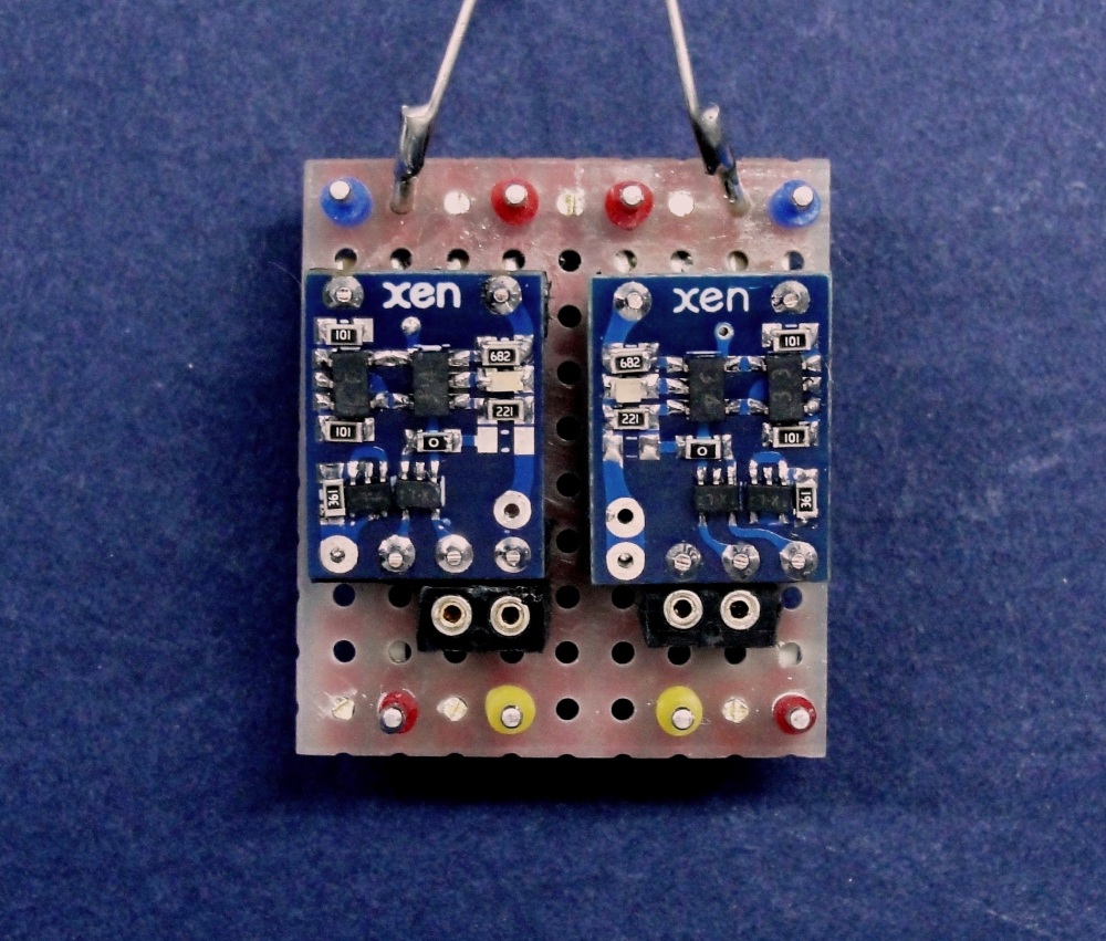

EUVL 4th May 2019 09:18 PM
J-797
1 Attachment(s)
The last (but not least) has just been built today and shown here on test fixture.
Distortion measurements still have to be made.
But all basic functional tests were according to expectation.
Patrick
