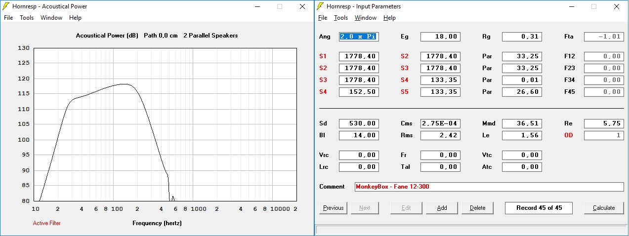

1 Attachment(s)
It's not going to be huge SPL, the frame of reference for my brother in law is perhaps a bit schewed, since the only PA stuff he's ever heard is not very good quality.
I get 109db per box in halfspace at xmax for the Fane 12-300, ca 50 watt input. Down to 107db at 30hz. If I xo at ca 200hz there will be sort of a "party hump" from over 110db at 80 to 112db at 150hz when using a 4th order BW LP.
It's not set in stone, but this will give "good enough"sound for a decent party, and does not require expensive parts of any kind.
Budget is very limited around 1000 NOK in drivers per channel + maybe 2000 NOK in amps. So around 350Ģ, including taxes.

I would like something smaller with better off axis response that can keep up with the 12-300 or equivalent (See image above, or whatever else is suggested that can give more per buck invested).

I think it should be in a closed box, and the response looks a bit wiggly in a BR/TL type thing, but the BR/TL thingy just gives so much more output!
Closed goes 113db to 83hz, vented goes 113db to 55hz, within xmax, per channel. That is a major difference.
Vented also peaks out at 117db/80hz, while closed is at the 113db mark.
I really want to use slot ports, but they absolutely must be off the ground a bit (rats, very fat ones), so round ports a bit up are mandatory.
