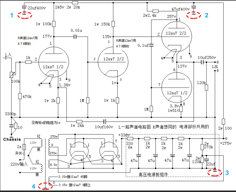

I've just built a valve preamp from a kit I got on Ebay. When I turn it on, I checked the output from the preamp and over a few seconds I see a high AC voltage of 140v which then quickly goes to zero as the amp warms up. After that it all operates fine according to tests I've done using an oscilloscope at around 2v. I am just somewhat concerned about the sudden high voltage appearing on the outputs to power amp as I switch it on. Is this normal?
I've wired all the grounds to 3 on the diagram.

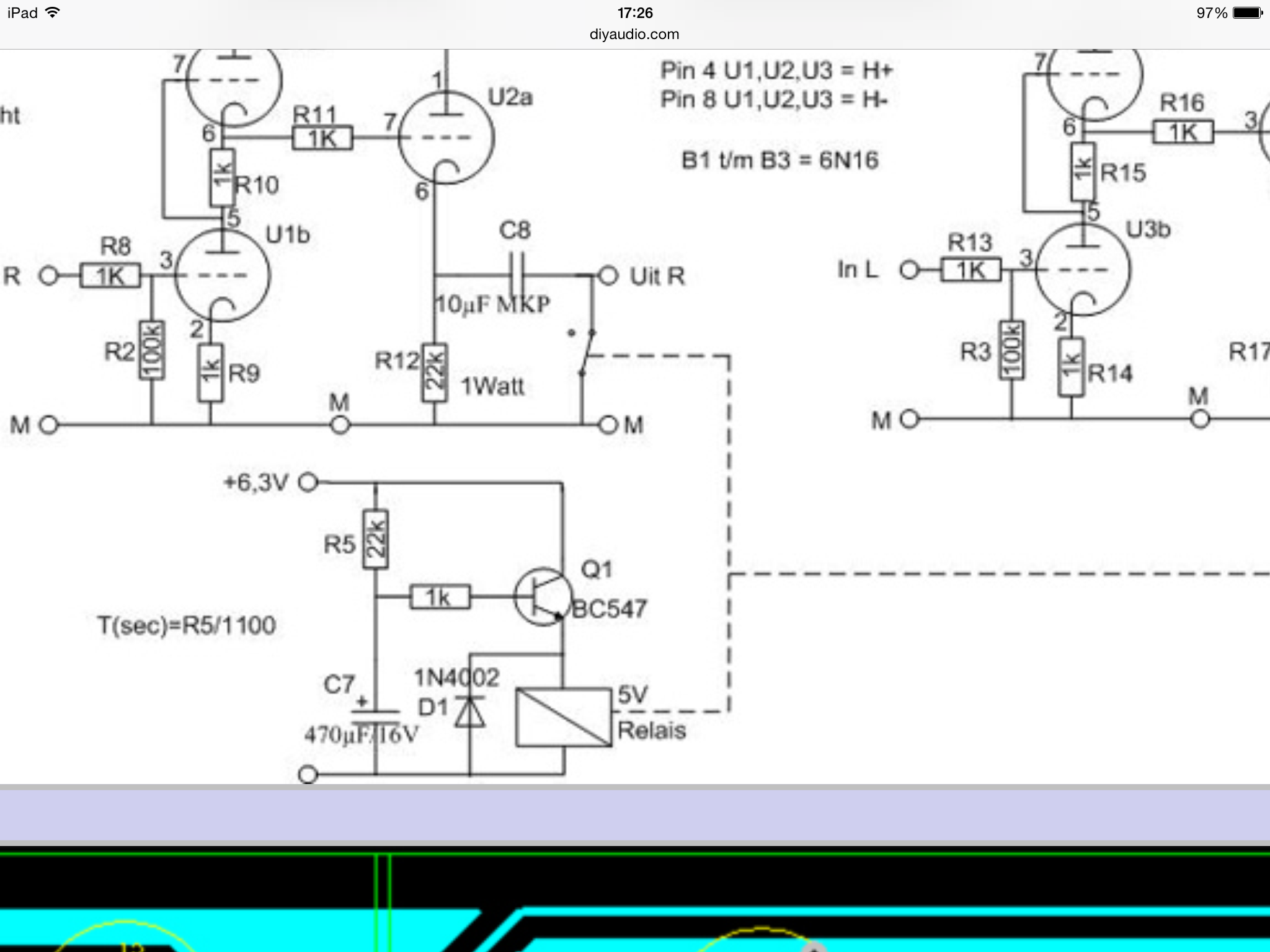

as a rule i always turn preamp/mixer on first and amps last and do the reverse when powering down.
weird stuff happening until the supply voltage stabilizes is common as well as bizarre speaker killing noises when devices are turned off while a power amp is on is one of the reasons turn on delay circuits are so common, sounds like you need something with a 3-5 second delay and relay switch the output.

What you see is a bad design. change 10uF to 1uF, 120k to 12k this will prevent possible damage of the powerstage.Thanks very much in advance for your help
1uF/12k starts to rollof at 13 hz check your math ! And i assume that the users speakers don't go that farExcept with 1uF/12k, LF starts to roll off at 130Hz... As designed, it starts to roll off at 1.3Hz...
Easier to wire a relay or switch to short the output until it's warmed up so you don't destroy the bass...
google"turn on delay circuits" lots of them using 555'sHi,
Thanks for the help, that's great. I was wondering if you could point either to a circuit diagram for the relay switch or is there something I can wire in off the shelf?

Two sections of 12AX7 with a lot of gain then a cathode follower 12AU7. A bunch of loop negative feedback to lower the gain. Silly circuit for a line stage in my estimation.
Build one of Broskie's Aikido line stages. No loop feedback and no coupling capacitor between tubes. Good PSSR. Simple but effective. Even his entry level one with the built-in PS performs well as long as you build the 6DJ8 version NOT the 12AU7 version. Turn on delay isn't needed with the Aikido either.

See also this thread
Simple Time Delay (no more excuses for not having one)
or the bottom right part of the attachment when you really don't want to use any semiconductors at all.

I have just had a look at that circuit and it looks like it might be the NFB capacitor charging up through the cathode resistor of the first stage causing the voltage to rise at the output during warm up. Try moving the NFB line to the other side of the output capacitor and see if there is an improvement.
Refugee1,
If the negative feedback is causing the output spike at turn on, then it would not be more than 1.38V, the input stage cathode voltage.
The output stage cathode voltage is almost 1/2 of B+. I believe that is the voltage that the output cap has to charge up to. That is a large transient voltage.
