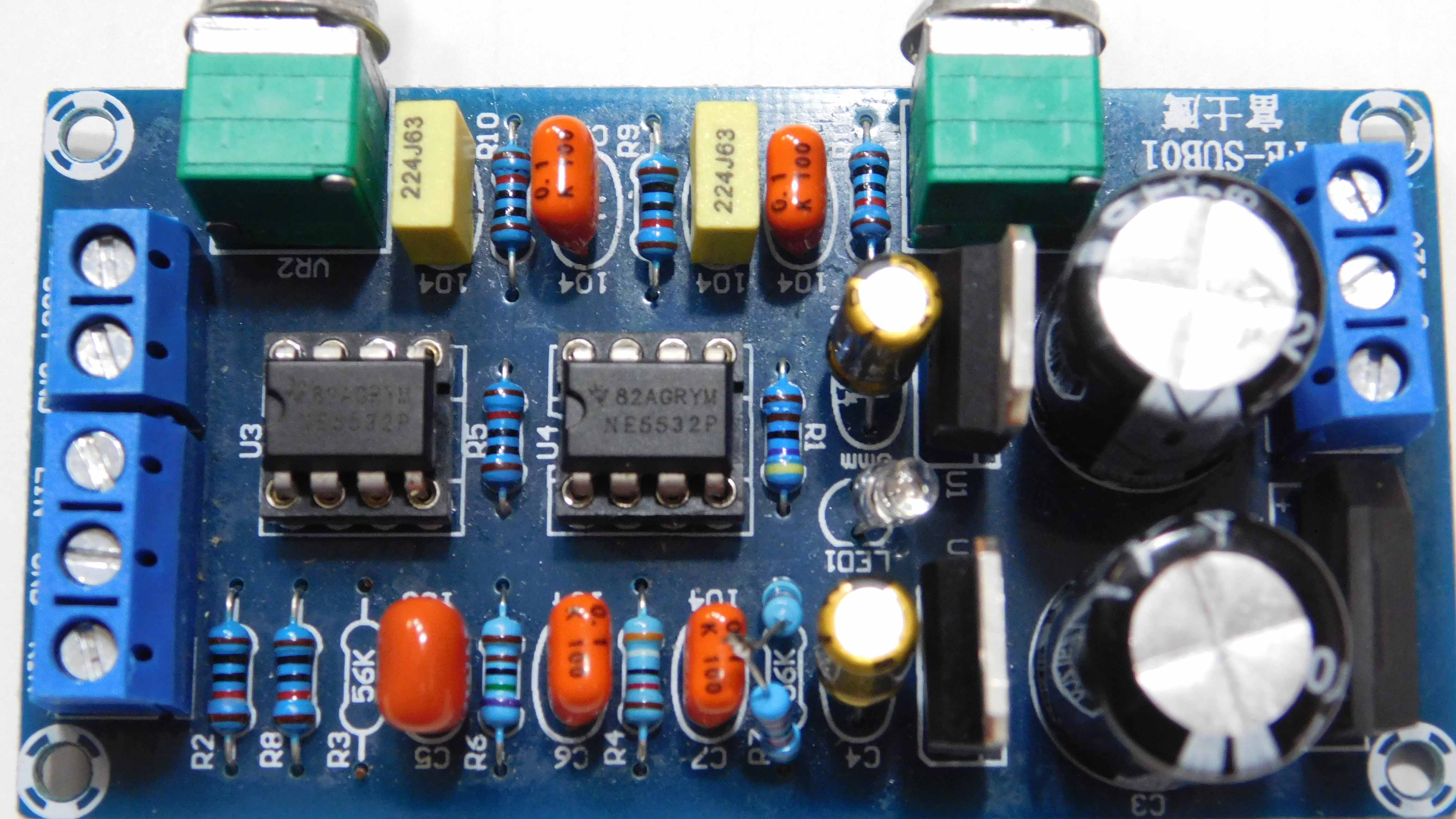

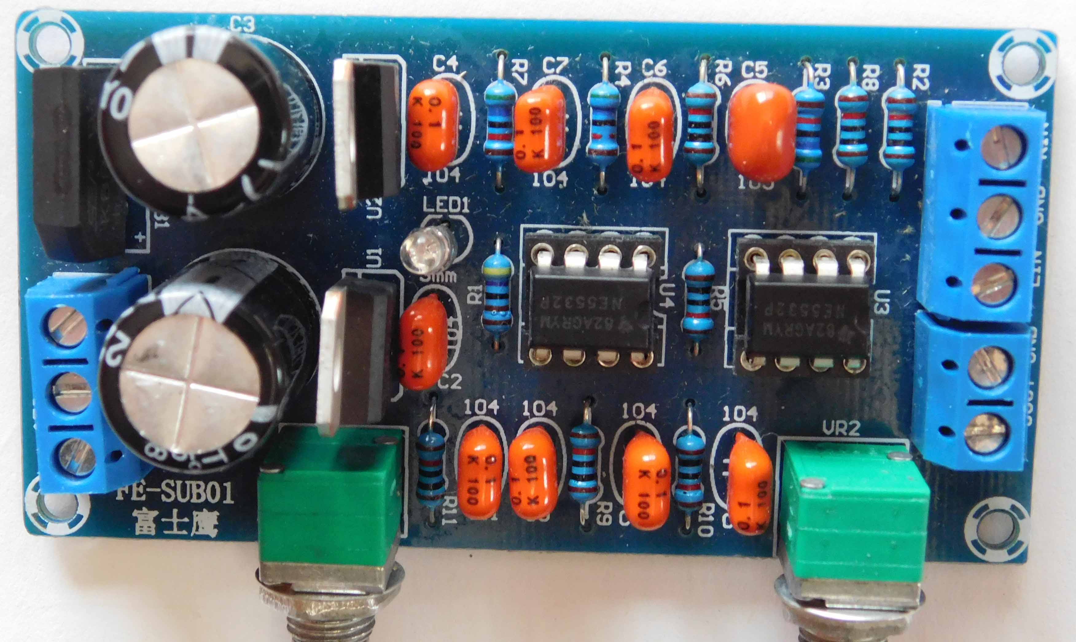

I was looking again for another low cost subwoofer bandpass board. I've already modified one and I was about to modify it again when I decided to see what else was available and roll the dice another time. My previous one is at Budget active subwoofer lowpass, buy, eval, mod and required substantial mods and I'm not entirely satisfied with it.
I noticed a board that had stereo pots on it :). Adjusting a 2nd order filter requires a stereo pot because 2 resistor values need to change at the same time. It also had enough caps to probably be a higher order bandpass and it's <$10 CDN delivered. Zero documentation is a standard for these products.

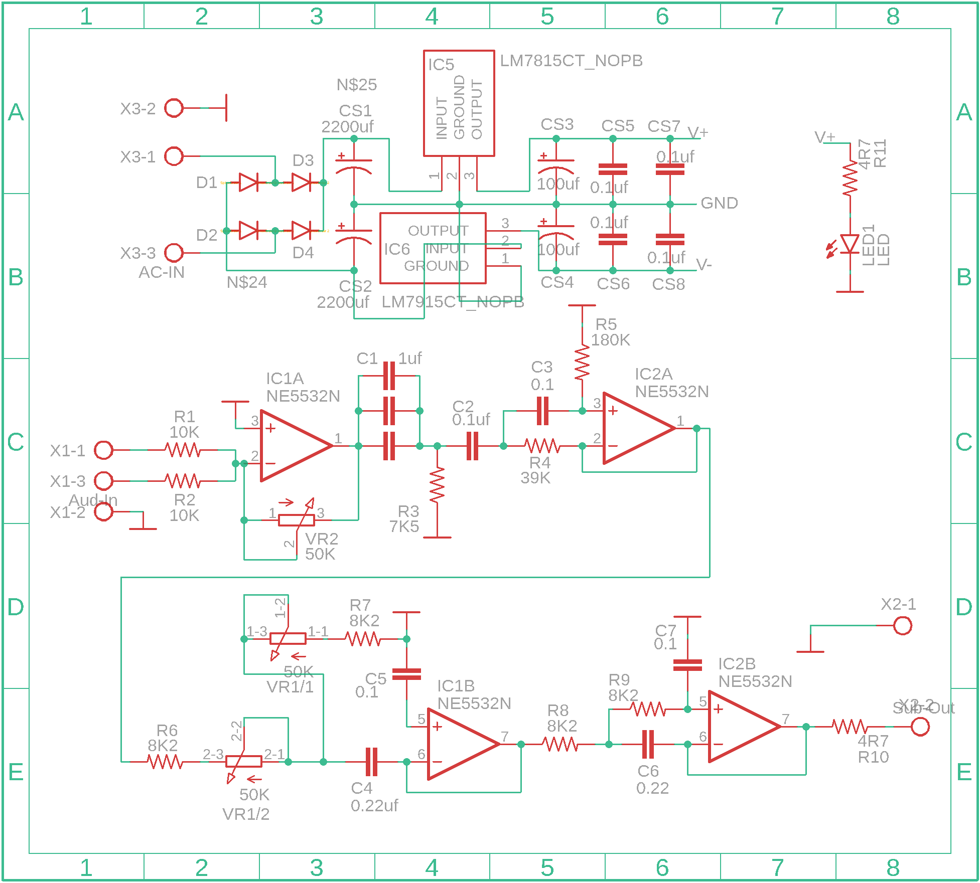

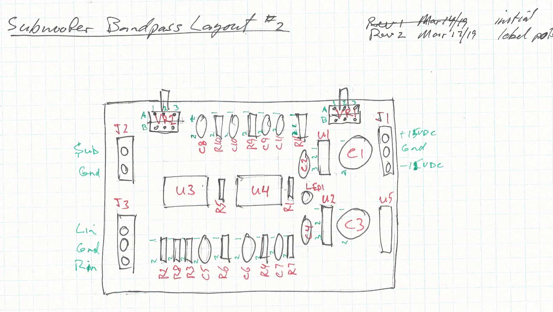

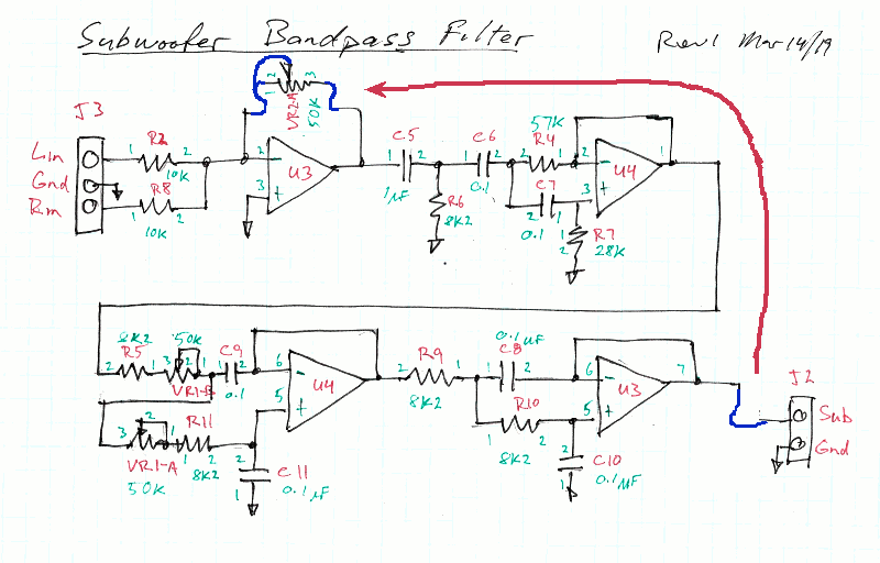

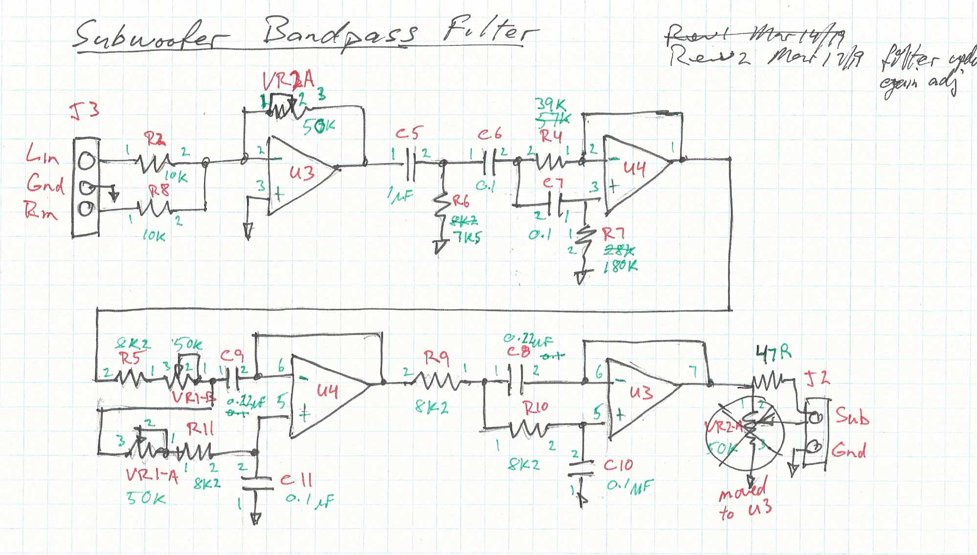

Layout and schematic
So here's the layout and schematic. All vanilla filters.
What's interesting is the one stereo pot is actually used to properly adjust a second order LP. The other stereo pot is sacrificed to volume control. The input summing circuit is also better than the previous one I tried. It comes with 12vdc regulators so I don't have to change them to use my +/15vdc supply. The volume control is unacceptable as the output impedance could be high and variable. Overall it seems alot better than the other model.

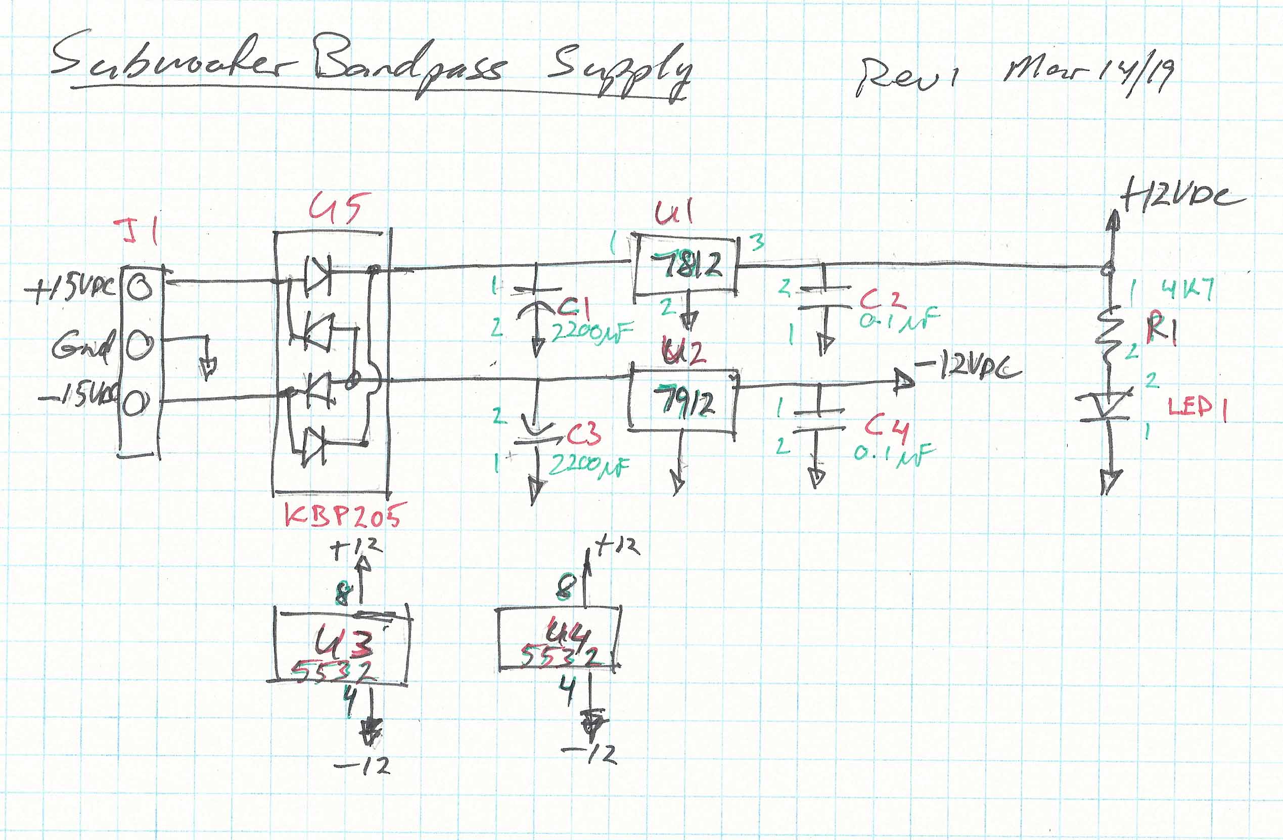

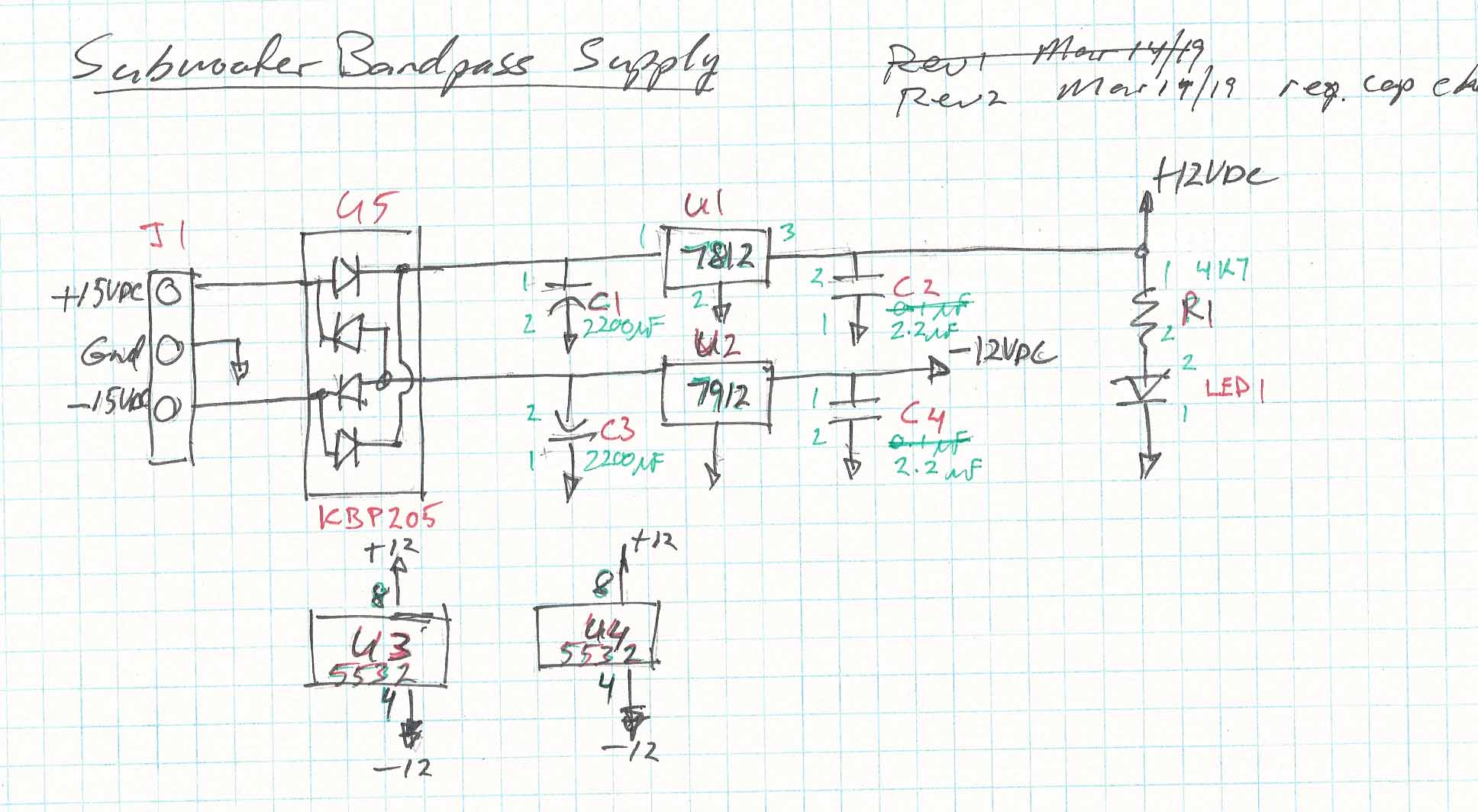

Regulator issue
I powered it up and noticed a 2Vpp sawtooth wave @40Khz superimposed on the -12vdc. I thought it was the regulator so I replaced the LM7912 and same problem. Then I noticed the caps on the output were tiny (0.1uF) and lower than you usually use (> 2uF) so they (C2, C4 =2.2uF) got replaced and it fixed the problem. Its not a stuffing error, the silkscreen shows 0.1uf and its too small.

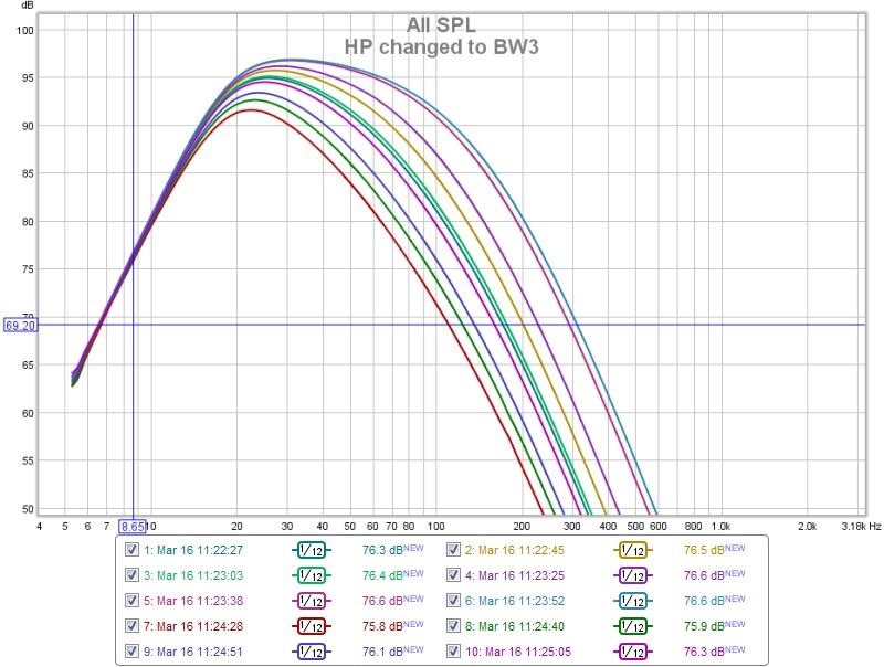

LP changed to BW2 + BW2
There are two 2nd order filters. One is fixed the other adjustable. With the current values they have Q=0.5 and I would prefer BW2 with Q=0.707. I would also like a flatter response when I change the cutoff freq.
Only needed to change two capacitors C8,C9 = 0.22uF. The fixed filter has been lowered to Fc=130Hz which is sufficient for me. The adjustable filter is now BW2 with adjustment range from 20Hz to 130Hz. At 130Hz the two filters becomes BW2 * BW2 = LR4.
Changed capacitors C8,C9 = 0.22uF.
Those changes are correct. I'm happy with the filter and cut adjustment now.
There's nothing special in this circuit, is all vanilla, and it works. I only made a few component value changes and those should have been done in the factory and it would not have changed the cost.

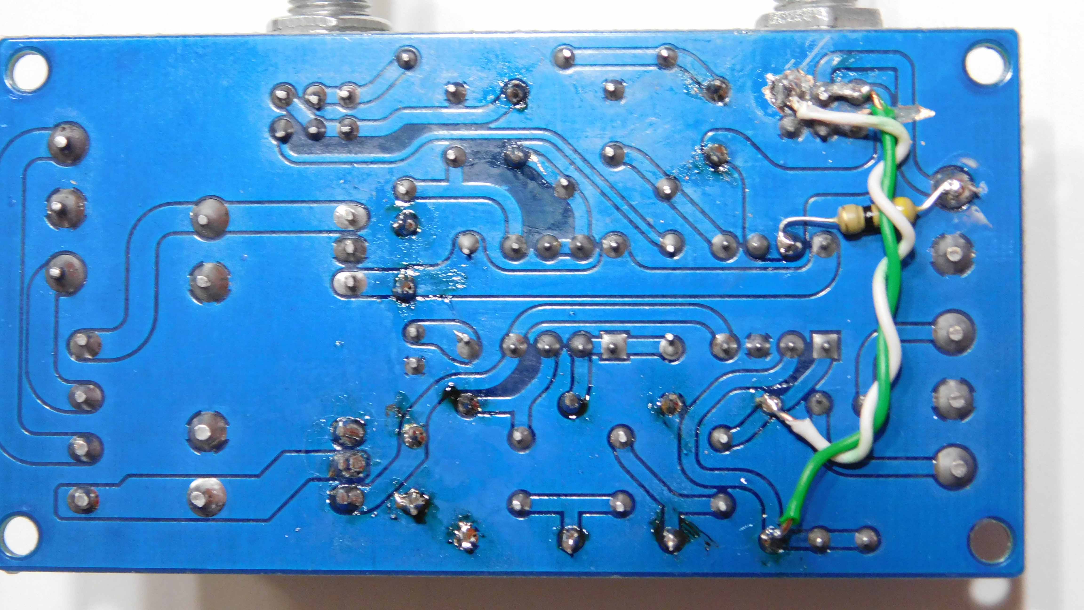

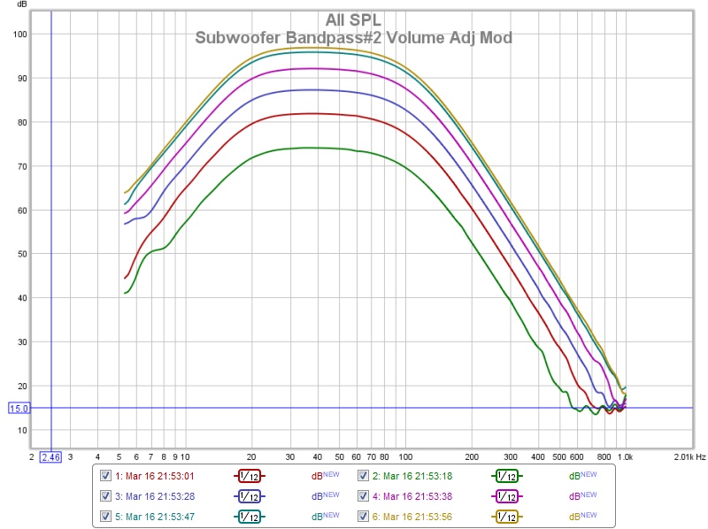

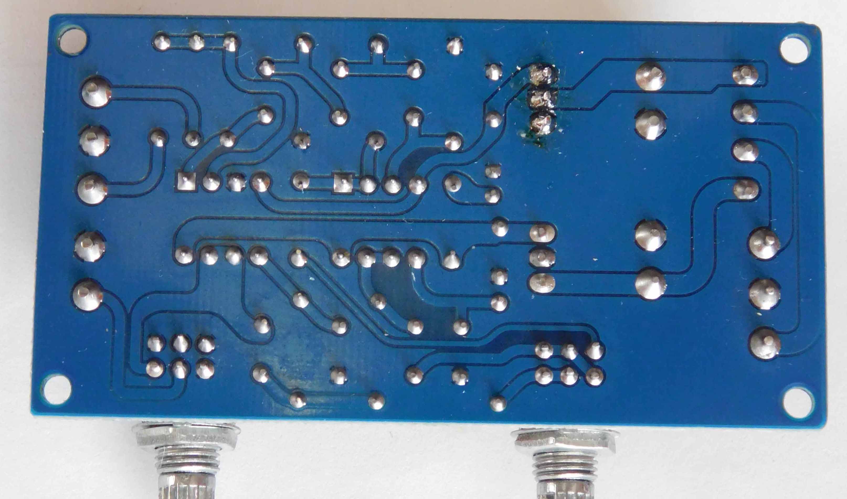

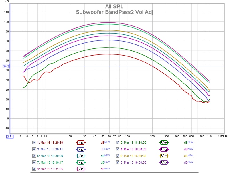

Vol adj and fixed output impedance
I cut two tracks to VR2a, and cut an island around the ground plane connection to its 3rd pin. VR2a pin#1 and #2 were connected so that impedance (and gain) increases when the pot is turned clockwise. R3 was removed and replaced by 2 wires to VR2a-1 and VR2a-2. VR2b was left untouched with all 3 pins still connected to ground.
A 47 ohm resistor was connected from U3-7 to Sub_out. All changes are on the board bottom.
The modification provides gain=1 (0db) to gain=10 (+20db). The measured results are below. It's now exactly what I wanted. Beer time. :D

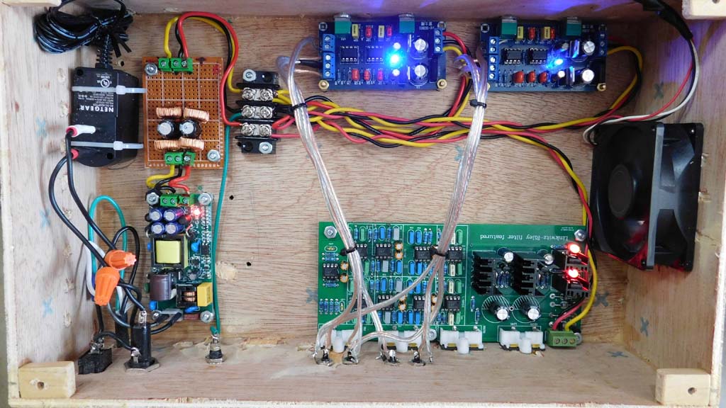

PS filter and 2nd board added
My +/-15VDC SMPS had too much residual switching noise so I added a 4th order power filter @fc~500Hz. The module's on board linear regulators (LM7x12) have sufficient PSRR to reject the remaining LF ripple. When I short the filter module inputs, and power up my amp, the speakers are silent.
I also required a 2nd subwoofer BP board as I needed to independently control 2 subwoofers. The second board has the same modifications as the first.
I did have an unexpected problem with the total supply capacitance causing the SMPS to limit inrush current and power cycle a few times at start up. So input supply caps of all 3 modules were replaced with smaller 1000uF caps. These boards were originally intended to rectify AC and I provide DC so less input supply capacitance per board is not a problem.
There is also a low speed quiet cooling fan added to provide air cross flow. The output air is cold, and the fan speed will probably be reduced some more or maybe even turned off.

Hi @vj_audio
- connect R7 to IC1B +ve , not gnd
- OpAmp IC power connections are missing
- it would be better to have both LP filters on same OpAmp IC2 and both input HP filters on the same OpAmp IC1 (my pre-bought board mixed them)
The rest looks OK.
Joined 2018
Just ordered this board...looks just what I need. Thanks for writing up your findings. I shall implement your mods if I may!
Is there any mileage in bypassing the onboard psu and feeding it something 'better'. I have a spare Studer 900 clone here that gets some good feedback here i wondered about using. Albeit it is about 10 times the size of the subwoofer board we are talking about here!
Hi DonVK,
Thanks for helping me out.
1)- connect R7 to IC1B +ve , not gnd: Corrected, will post a revised schematic once I move both LP/HF filters on a single chip.
2)- OpAmp IC power connections are missing: The power connections are not available at the schematic level but are connected using name command and available at the Board level.
3)- it would be better to have both LP filters on the same OpAmp IC2 and both input HP filters on the same OpAmp IC1 (my pre-bought board mixed them): Should I replace IC2A with IC1B?
