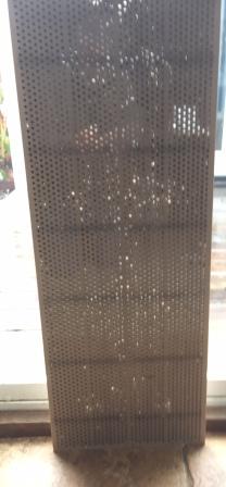

The electrode/stators show quite some loss of aluminum from the diaphragm, mostly down the center line. Interestingly, the capacitance values are not that far off from what was written on the panel edges. They do work, but are very old, and probably should be refurbished before I do much else.
I've scoured the web, and find little information on the Beveridge circuit board electrodes other than that they are notoriously unreliable. I assume they generally follow Beveridge's patent, so use copper on the inside of a PCB (it is backed off from the openings) and insulated with about 250 um of Nylon. The diaphragm claimed in the patent is Mylar (or other PET equivalent) that is coated on both sides with Aluminum. No diaphragm thickness is mentioned, but I assume that it is the standard ca. 4 um thickness. The patent further claims the edges are sealed with a nonconducting silicone elastomer, but if that is used in mine, it long ago has lost its compliance.

FWIW, the stator-stator distance is 2 mm, and there does seem to be Al on both diaphragm sides. I couldn't measure the film thickness, as my micrometer is just too big for the holes. Capacitance (front/rear) on one panel measured 2.83/2.30 nF, whereas the panel had written on it 2.87/3.06.

"The electrode/stators show quite some loss of aluminum from the diaphragm, mostly down the center line."
My question is - How does the loss of aluminum appear? Burned, oxidized or just weak.
I mention this since it somewhat matches the description I gave above of the raw mylar I received.
"possibly oxidized and lost much of its aluminum in the center portion"
2 days ago when I first saw a problem with the coating...faded down the center...I considered for a moment that there was an attempt to vary the coating density but there is so much random scratching and damage and uneven splotchy aluminum I find it hard to believe that was the case.
No random positions of the holes in the center area showing any darker material?

I'll give the picture a try. I stipulate that the image is terrible, as what I'm describing works better with back light. That's not conducive to good photography. If it posts, it should make the point, though.
The picture enlarges correctly. Let's say the process is cumbersome!
