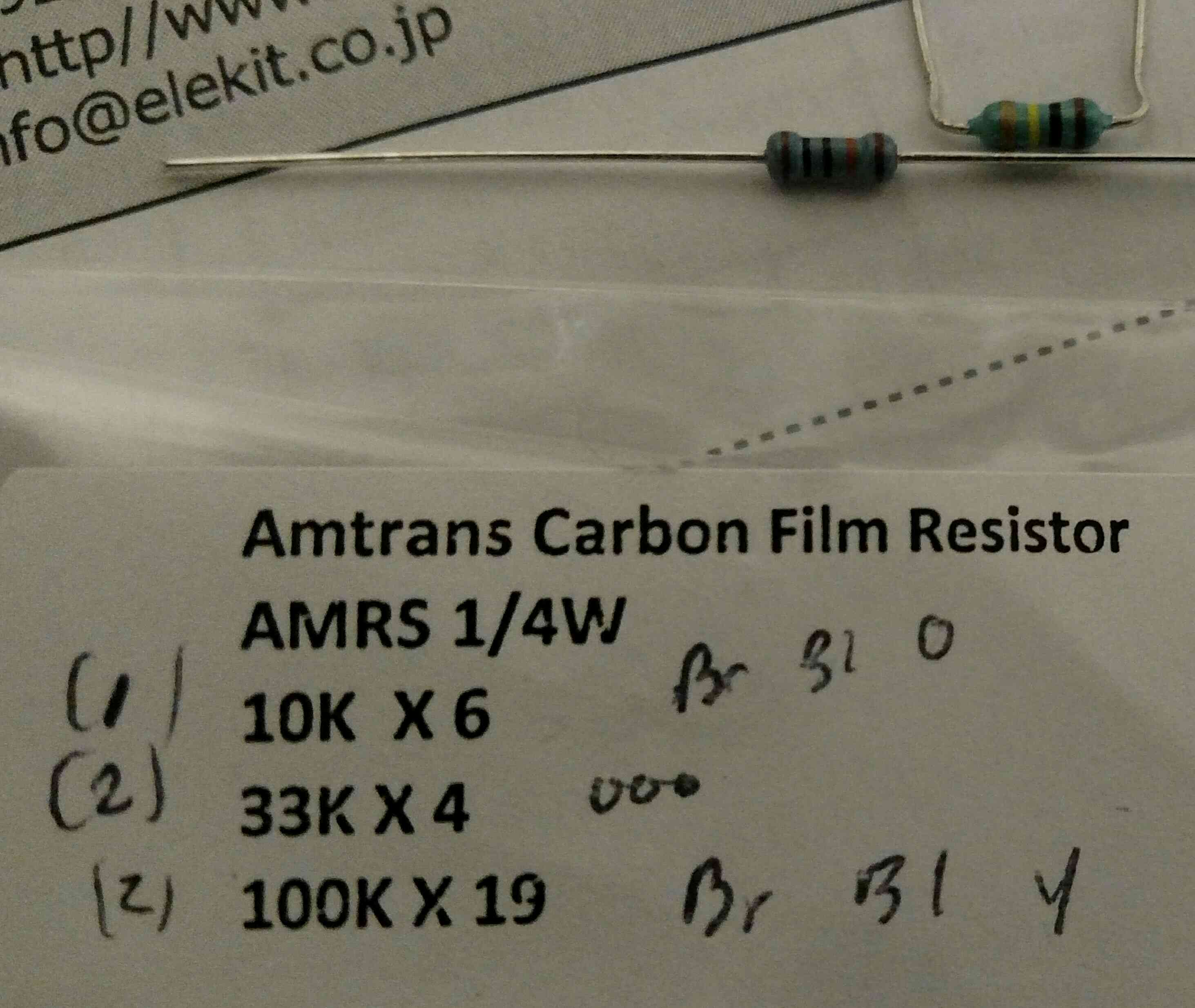

Almost finished with the PCB, and realized I was using 100 k resistors with 5 % tolerance rather than pack with 1 % tolerance which is what their color code indicates.
I think there are 17 in the first step I would have to do over:yikes::eek:
Does it matter? Should I start over or resolder?

Tuberoller 25th February 2019 11:56 AM
Thanks for the reply.
The%5 are already soldered in. Apparently the kit came with a duplicate set of 1% resistors in an unlabelled bag. I am done with the construction and have these 50 -100 extra resistors that are actually the ones indicated by the direction,s color code for 1%.
The solder bridges are across pins on the same component. Can you hear this in SQ or is it a potential problem down the road. Why does a component have multiple pins? Just trying to learn a little.

Attached is the bag that had the 5 % resistors, naturally gravitate towards that as it was the only one labelled. I did measure some resistors and googled color codes , but was not aware of the tolerance variability, incidentally not numerically printed in directions. Would you measure each of 150 resistors? And why, just to see if there is a bad one? I read colors just fine - honest question

paczeltf 25th February 2019 02:57 PM
You do not need to measure all resistors, just one from each group with the same color code in order to make sure you did not read the codes from the opposite direction and did not consider orange to be brown etc.
