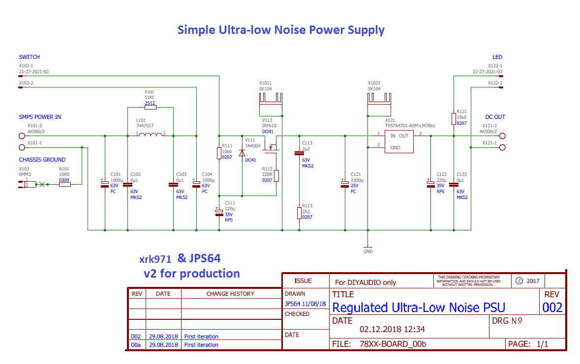

So here is the circuit:
738238d1550875311-gb-simple-cap-mx-regulated-low-noise-psu-simple-psu-schematic-v2-png

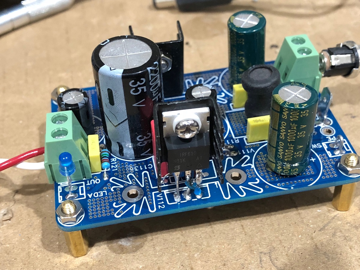

This is what it looks like built up in prototype stage v1:
738239d1550875311-gb-simple-cap-mx-regulated-low-noise-psu-simple-psu-build-v1-jpg

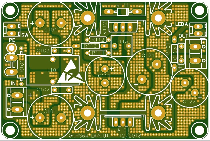

And here is the board will look like for the v2 (will be 1.6mm thick, 1oz copper, green mask, and ENIG finish):
738240d1550875311-gb-simple-cap-mx-regulated-low-noise-psu-simple-psu-top-render-v2-jpg
Here is the top view of the parts placement. BOM for the board is relatively cheap if you are going with just a 78xx. You need an N-channel TO-220 MOSFET such as an IRF610 or the Fairchild equivalent. IRF510 etc works well too. A few caps and resistors, some connectors, and a basic inductor to keep the DC-DC noise even more isolated.
738241d1550875311-gb-simple-cap-mx-regulated-low-noise-psu-simple-psu-placement-top-v2-jpg

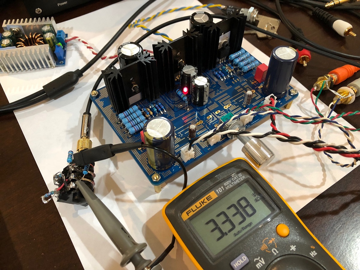

Some supporting info, you can see in the photo below, a hand-made variant of this PSU (without a voltage regulator) powering my Aksa Lender preamp, the DC-DC step up is visible as well. Here I was running 48vdc output so a 78xx regulator could not have been used as they max out at 35vdc input:

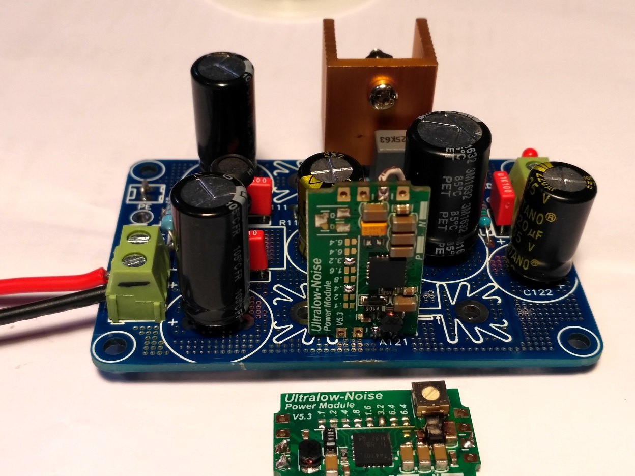

Edit Feb 25, 2019: Member Twocents was a beta tester for v1 and he installed an eBay 5v TPS7A4xx LDO board on it - nice work!

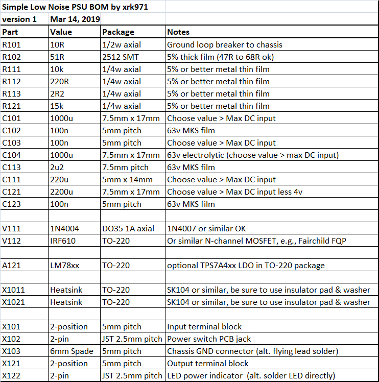

Edit Mar. 14, 2019:
742667d1552511103-gb-simple-cap-mx-regulated-low-noise-psu-simple-psu-bom-v1-png
You can use the Wurth 774701 Choke:
https://www.digikey.com/product-detail/en/7447017/732-1418-ND/1638823/?itemSeq=289294179
https://katalog.we-online.de/pbs/datasheet/7447017.pdf

Hi there
Would you mind telling me what is the value of the inductor in the CLC section? I am checking to see what components I already have and what I need to purchase for this PSU before deciding whether to join this GB. Thanks!
Founder of XSA-Labs
Joined 2012
It’s very flexible what size inductor you can use. The characteristic cutoff frequency of an LC filter is 1/(2 pi sqrt(LC)). If you use a 1000uF cap and say 10uH inductor, you have 1.6kHz filter cutoff - well below the switch frequency of the SMPS by many octaves so the filtering should be steep. You could even use a much smaller cap like 100uF and it would be fine as that is 16kHz and switchers are 200kHz to 400kHz.
Make sure you have a resistor in parallel with the inductor to prevent oscillation. Something like 33R to 47R or 51R works.
The inductor specified in the schematic is a Wurth 7447017 22uH. Or 1072Hz cutoff frequency.
