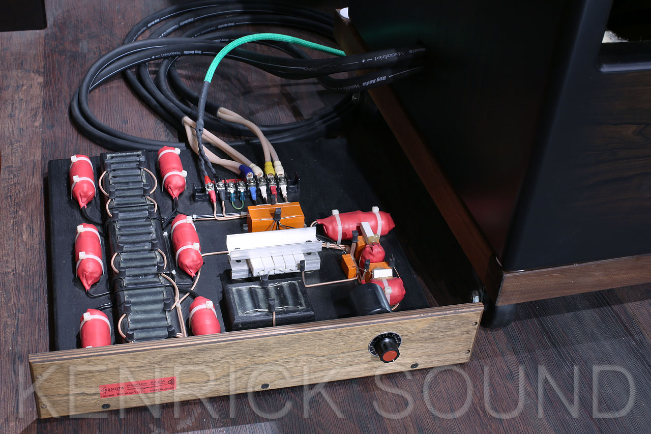

Rey Audio does it.
You mean put identical series components into each of the [nominal] positive & negative legs of a passive crossover? Well, you can do if you like, there's nothing to stop you. You'll need four times the total series capacitance (x2 in each leg) and divide up the relevant series inductance and resistance between the legs. Since it costs significantly more, requires more space as you've doubled the amount of components and provides exactly the same transfer functions, most people don't bother as there isn't much reason to do so.
In fairness, I know somebody who did it, and using extremely expensive components too. He was happy; whether he would have been equally happy with a simpler & cheaper conventional approach is open to question.
Rey Audio does just that, albeit only for the Woofer section of the crossover (which is a 6th order low-pass).
Here's a photo of one of their crossovers (attached).
You can see the six series inductors (three on the "+" leg, and three on the "-" leg) on the left-hand side of the crossover board.

Hi Marco
Do you know the reasoning behind that ? And are those the original inductors shown on that crossover or special ones replaced by Kenji ? Or are they supplied by some Italian salumeria ? ;)
For the OP: Of course you can do a symmetrical crossover but the amp does not care at frequencies from DC up to the ultrasonic range. The slightly asymmetric load condition would only be measurable at RF frequencies.

Hi Marco
In an interview that he gave to the magazine Studio Sound in July 1987, Mr. Kinoshita claimed that it reduces "cross talk" between the Woofer and Mid-tweeter branches.
Those are the original inductors.

Hi Marco
Yes, there can be indeed some reduction in crosstalk but it is diffucult to say by how much compared to a properly layed out ordinary asymmetric wiring (especially if the ground wiring of the latter is properly done).
