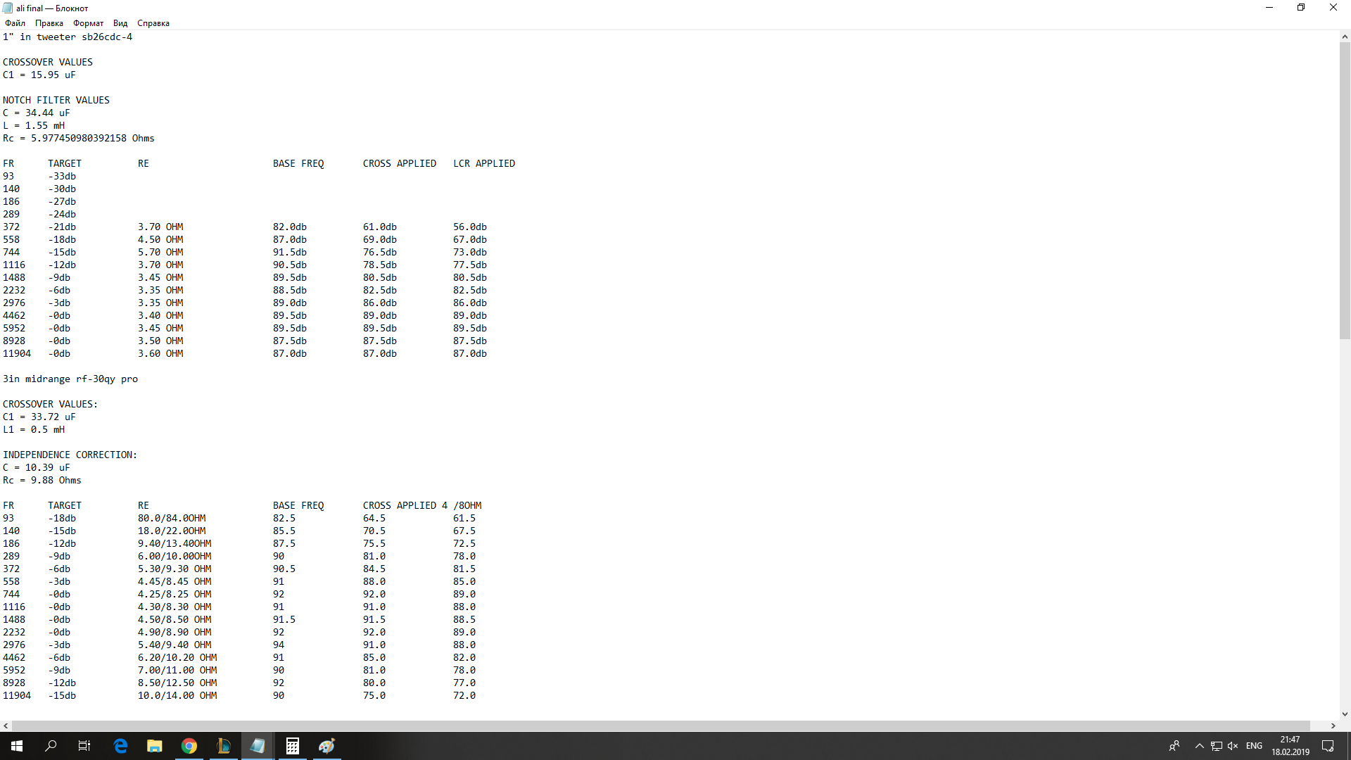

I have mapped all the drivers seperately, and then have combined them into a TRUE 1st order electrical 4-way response graph.
The reasons behind this is that I realised the crossover points between the drivers must be -6db to have a flat response, therefore I have made assymetric crossovers to make sure Im as flat as possible.
The tweeter is already modelled with the series LCR notch in parrallel to the driver, but I havent added the effect of the Zobel impedence equalization networks which are in parallel to the cone drivers.
Thier job is to make sure that the higher frequency zones after the low-pass points to the cone drivers are rolling off at least as intended, if not quicker (meaning 9/db octave instead of 6db/octave). This will even out the bumped kinks you see on the red midwoofer graph, and the black midrange graph past thier low pass points.

MasterSplinterJG54 18th February 2019 06:31 PM

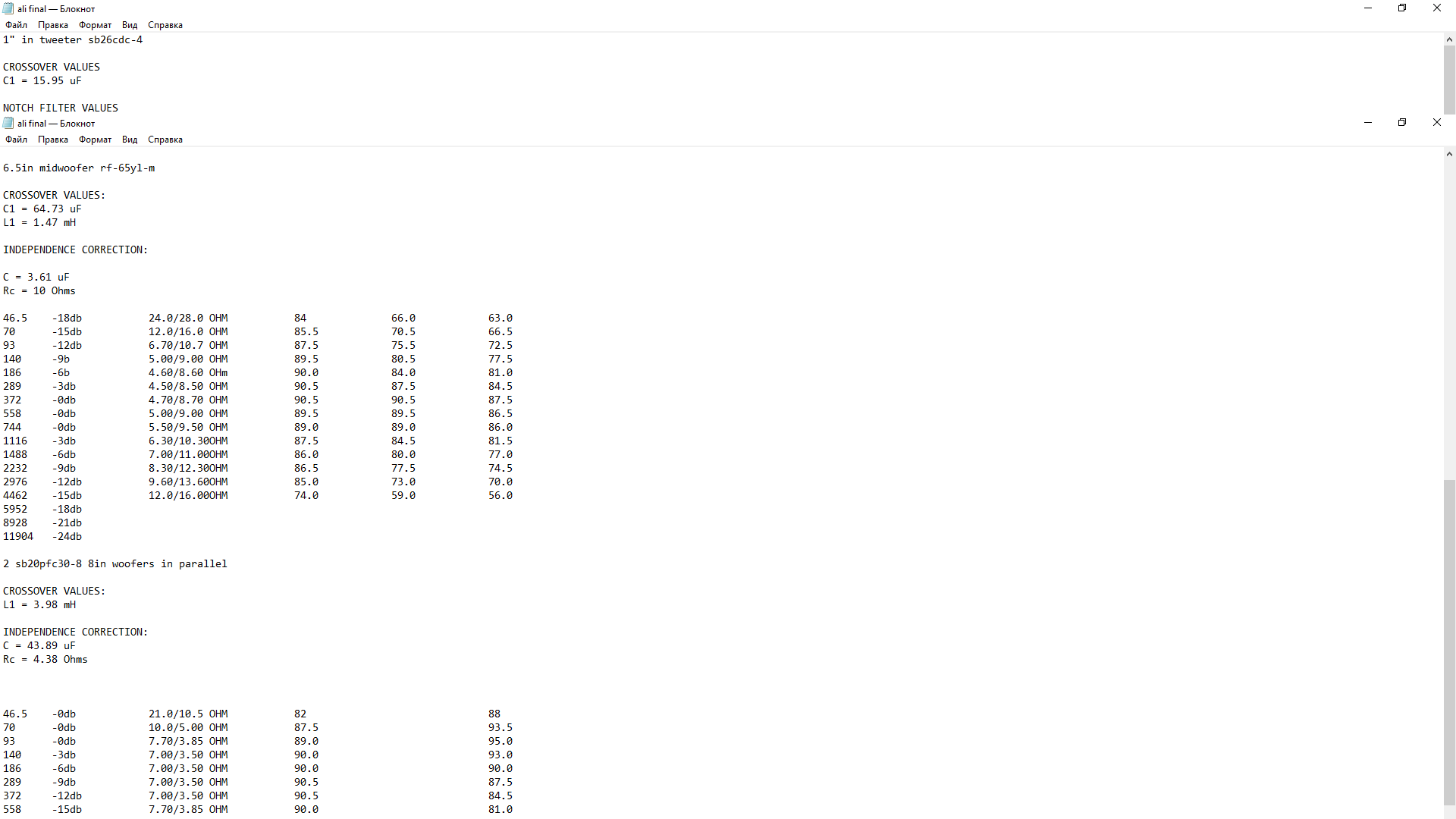

2 Attachment(s)
Here are the calculations for the 8 ohm units
AND THE CABINETS Ellipticor-3

Thanks for your responses guys!
1). I will be using double 8" woofers, with a total of 432 cm2 (around 13" worth of bass). What I win in this situation is: A). Transient response is better on smaller drivers, much less moving mass and therefore more detail. B). Less beaming on shallow slope crossover, allowing a higher crossover point C). Lower cost, especially on shipping.
2). I have settled for a 1st order crossover because Troels said you cant go wrong with phase, and I already have DIY experience in 12 / 24 db octave 3 ways, so setting a challenge for myself, in some terms.
3). In Troels quote Linesource posted about electrical 1st order having 1st order acoustic slopes, I have modelled my drivers acoustically flat (+-1db) not merely 2, but 3 octaves, or 18db to resonance peaks. That is more than his minimums.
Only the tweeter has an LCR curcuit, so its low end will surely be 2nd or 3rd order acoustically towards its resonance of 700hz, so I get additional power handling on the tweeter on a 1st order electrical.
4). The SB Drivers I have chosen have been thoroughly tested, and are perfect value in my book. As for the anodized chinese drivers i mentioned, those are flagship units in Chinese terms.
Yes, SB SS and SEAS may be more proven, but at least 2x the cost, and If i were to upgrade, i would do revelators or satoris, which are 4x the cost.
Being metal, they truly are the usual suspects for cone breakup, but as I said I'm rolling of 3 octaves below resonance.
I'm winning in detail, and bass punch, as we know ceramic cones offer more detail until you reach nasty breakups.
5). I would love to know more about abstracts idea of an active crossover. How can I use op-amps and low-cost parts? Tell me about this, really interesting. The goal here has cost efficiency, so this has my attention. I'm not saying I chose the best drivers, but for 5 units / 200$, show me better.
6). I have a real question guys. I understand I can convert-modify my 1st order electrical low-pass inductors on the midrange, midwoofer, and woofer to LCR circuits. I understand the woofer will swallow alot of capacitor, but this is more realistic on midrange and midwoofer. I simply stick to my inductor values and manipulate caps and resistors to achieve a notch filter if I get audible breakups on my setup without the LCRs.
In this case, the Zobel networks stay in place in any scenario, correct? Or im converting the inductors to full LCR, do the zobels go?
