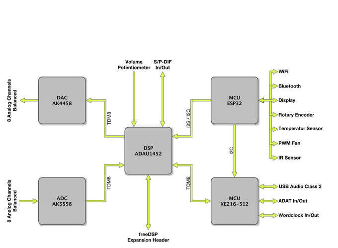

freeDSP-aurora is a one board DSP solution. It all started with the development of a DSP powered subwoofer amplifier. Once the prototype of this amplifier was presented on the German forum diy-hifi.forum.de a fruitful discussion about additional features and ideas started. After two years of development freeDSP-aurora is the distillation of the best ideas.
So here are the features of the board:
  • Analog Devices ADAU1452, 294.912 MHz, 32-bit SigmaDSP, 6144 SIMD instructions per sample @ 48kHz fs, 40kWords of data RAM, 800ms digital audio delay pool @ 48kHz fs, eight stereo ASRCs with 139dB DNR
  • XMOS XE216-512-TQ128 for multichannel bidirectional audio streaming
  • ESP32 for WiFi or Bluetooth control
  • AKM AK4458 32bit-DAC
  • AKM AK5558 32bit-ADC
  • Supporting sample rates between 44.1kHz and 192kHz
  • 8 analog balanced input channels, +6dBu
  • 8 analog balanced output channels, +6dBu
  • S/P-DIF input and output
  • ADAT input and output
  • Wordclock input and output
  • Support for display, rotary encoder, volume potentiometer, temperature sensor, PWM controlled fan, IR sensor
  • One freeDSP expansion header
  • USB Audio Class 2 Bidirectional streaming with 8 channels in and 8 channels out, full-duplex. Works with ASIO driver under Windows 10 and driverless under macOS and Linux.
  • Board dimensions: 100mm x 100mm

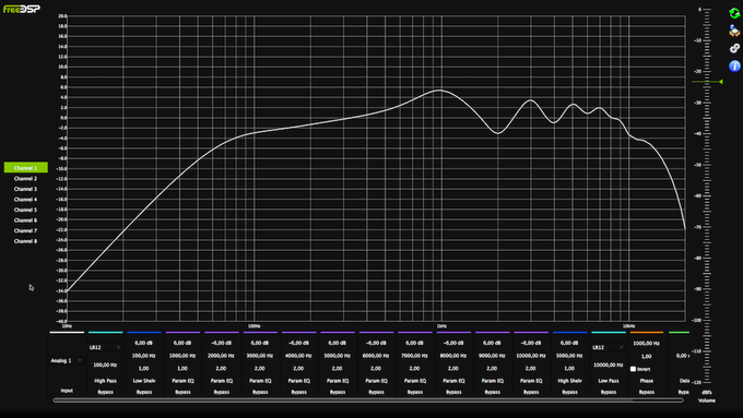

To make using as easy as possible I wrote my own app that controls the DSP via Bluetooth. The app runs on macOS, Windows or iOS. Thanks to the ESP32 framework Wifi instead of Bluetooth is an option.

Looking at your list of supported filter types, one thing I strongly suggest is making something like the MiniDSP "advanced biquiad" functionality - the user can input the five biquad coefficients as real numbers. This makes it possible to make other kinds of filters, like higpass-notch, and lowpass-notch, or anything that can be realized with a biquad.
The other thing to consider, based on my experience with the miniDSP interface, was that there were too few biquad stages available on the inputs before stages that were dedicated to crossover filters. The input filters are used for global EQ and you want them applied to all outputs without having to duplicate each filter in the output filter chain.

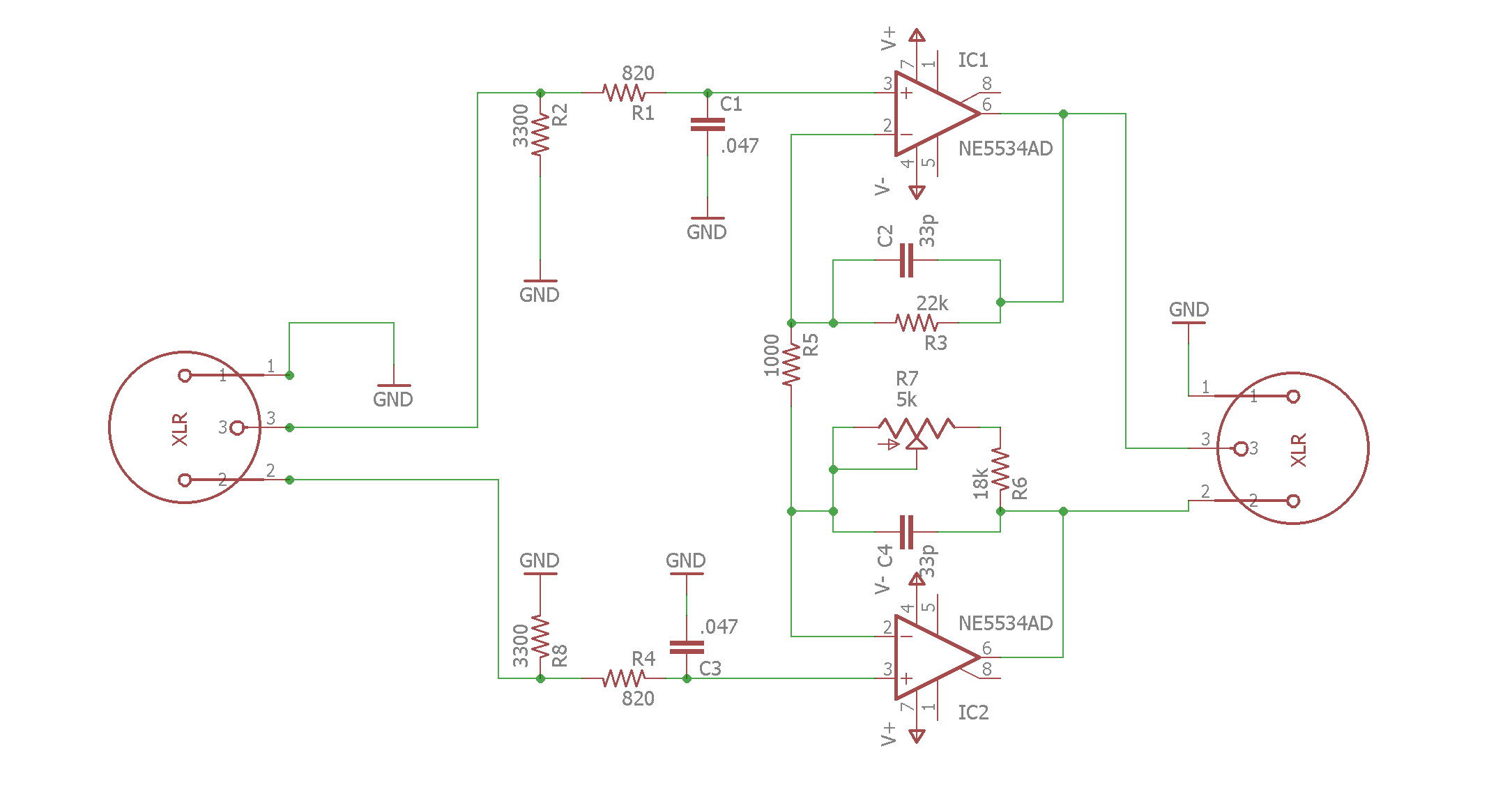

Does this circuit require a mic preamp? Or can the input stage be modified to add additional gain?
How about a preamp like this, but instead of xlr, it would have the analog i/o pinout as seen on the Aurora... A circuit like this would be between the port/jack. We would create chasis mount pcb->Aurora io separately.
attachment.php
Chasis mount xlr> Aurora io > mic preamp > Aurora io > Aurora.
I can help getting some parts into the kicad library, and I can help create some simple conversion boards for different io. What's your thoughts?

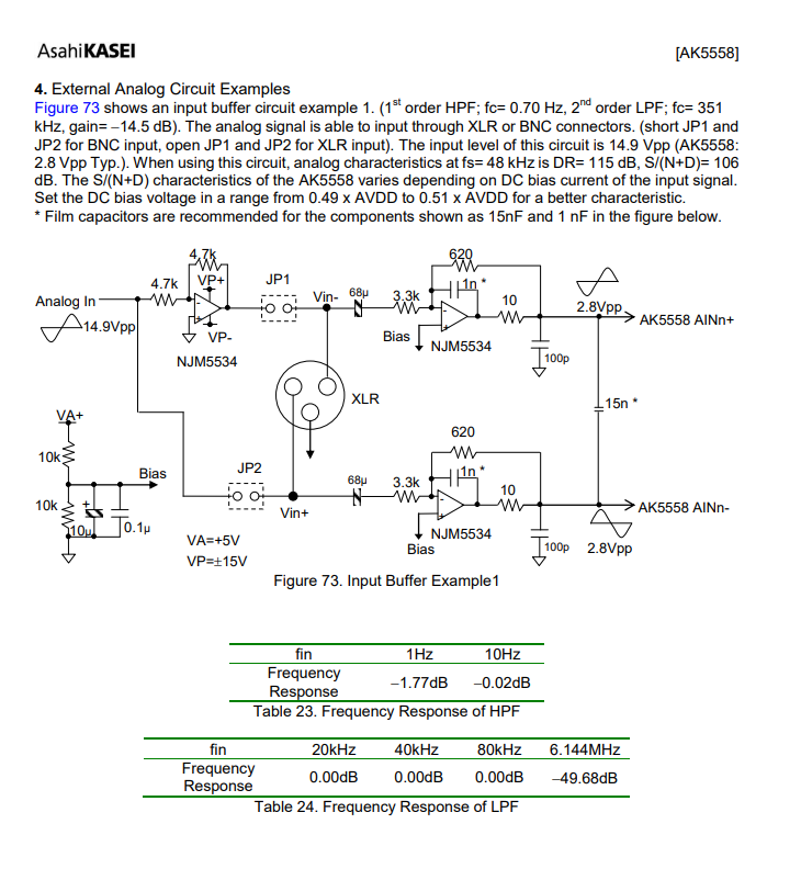

Here is the recommended input stage of the AKM AK5558 32bit-ADC.

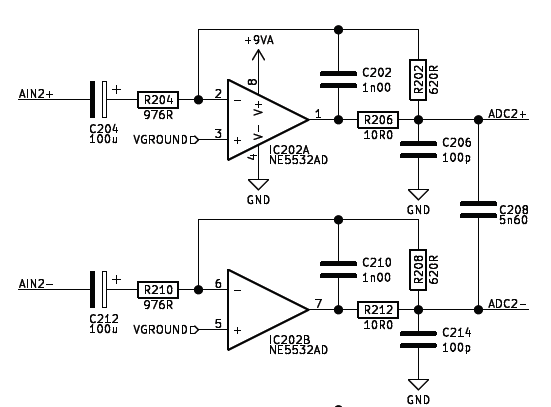

And the input stage of the Aurora.

So it's implimenting the recommended input. My question is whether this input can (and/or should) be modified to allow for preamp gain for my dynamic microphones. I'm also curious if a potentiometer can be rigged to the aurora's existing input stage to give an adjustable control. Please note that for my purposes, I can be OK with a "set it and forget it" gain. I would adjust the overall levels in the DSP parameters, not on the preamp. For some users, a digitally controlled preamp would be nice. Yes, very nice. :)
====Single Ended
I'm also noticing that the datasheet calls for a single to balanced conversion in the case of "BNC Connectors". I'm sure this is a common question, but should we actively convert the single ended inputs? Or should we just connect + and ground -?

In case you want to use microphones, I would recommend to add another opamp stage like you have shown.
The maximum gain of the current input stage is a bit limited. The maximum negative swing is limited by the virtual ground of +2.5V required by the ADC. Therefore, I have also replaced the NE5532A by another rail-to-rail-opamp: OPA1652.
Having said this, an additional stage for the mics will preserve the option to connect line signals.

Power supplies are all LDOs with DSP, USB, analog power for converters and opamp power having each a regulator. The +2.5 virtual ground is provided by TLE2426ID.

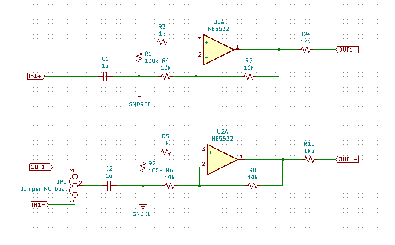

I had an idea while I was sleeping that might solve the need for both of our purposes in one board. What if we were to create a preamp module that would have a series of "input inverters". These input inverters would also have a simple gain control in either fixed resistor or variable resistor format. If designed correctly, we would solve two birds with one stone.
Single ended inputs would be sent through both inverters, one after the next. This would thus create a balanced signal. Balanced signals would go through the same two inverters but in parallel, so that the balanced signal is just reversed. Both the single ended version and the balanced version would have gain control on the inverters (in the form of a fixed, or variable resistor), so you can add gain coming from the single ended or balanced input signal. The idea would be that at the right gain, this circuit would also be a mic preamp.
The result is an input stage board that would offer single to balanced conversions, input filtering (for standard balanced connections), and gain options (for microphones and instruments); all in one neat little package.
I started a project to draw out my idea.... This is a start. Where would the gain control variable or fixed resistor sit on the circuit? Is this a valid way to approach this situation? This would add gain to the mic input correct? Would it be of any decent quality?
