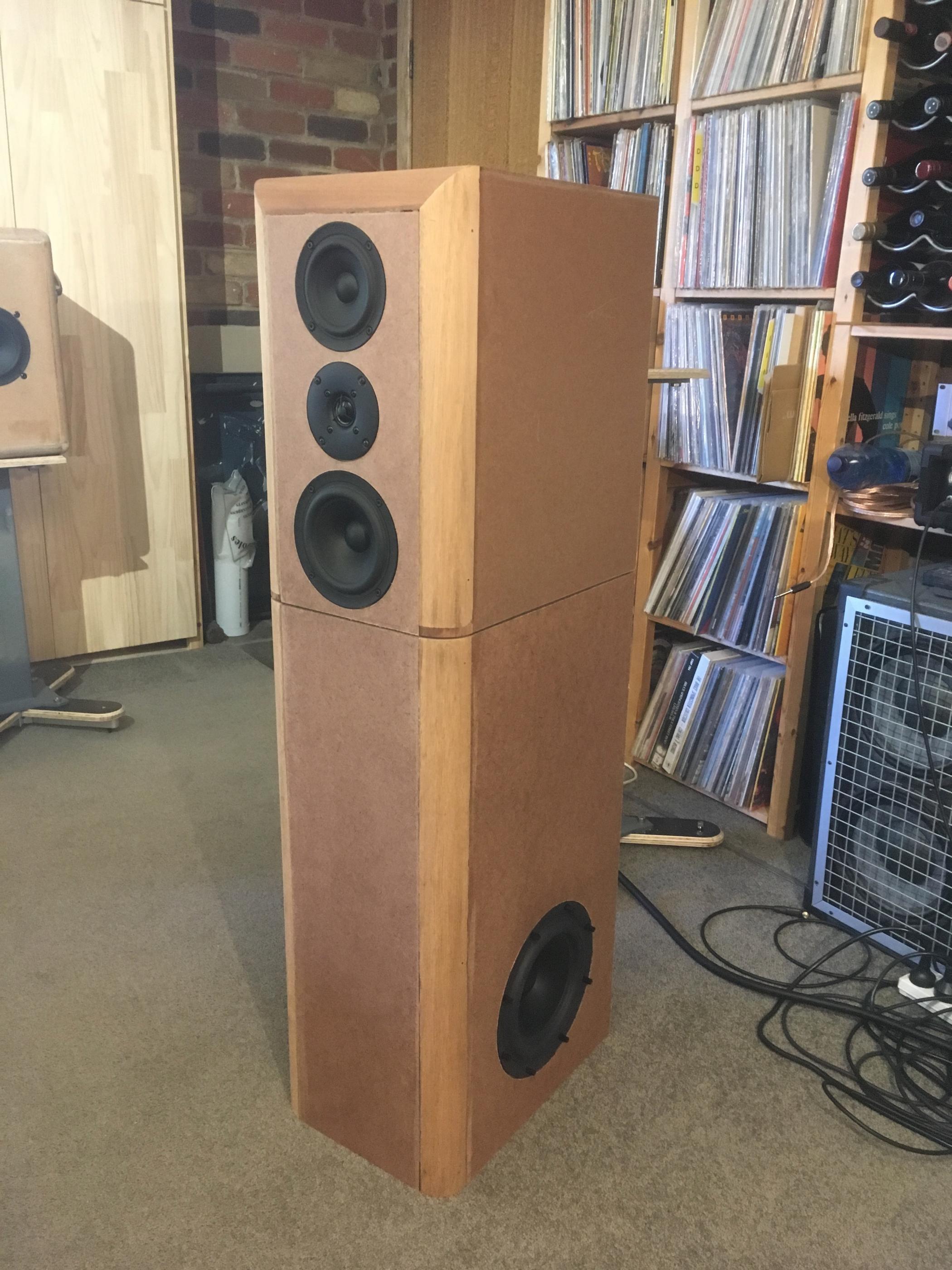

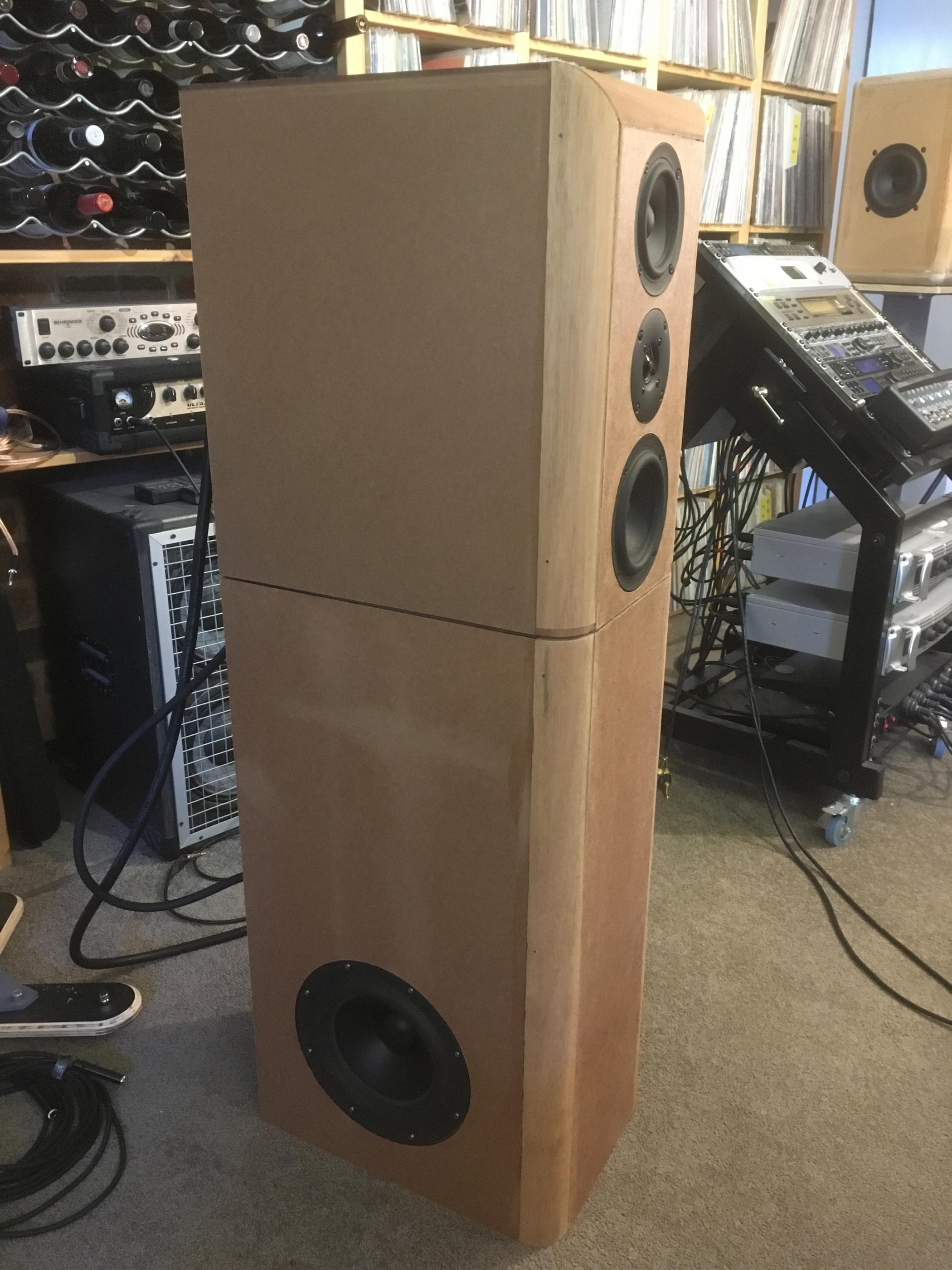

I suppose I should Insurance purposes and all that
A lot od cheap some good some very good but all older than 10 years in storage, it being a long time since I have made anything
