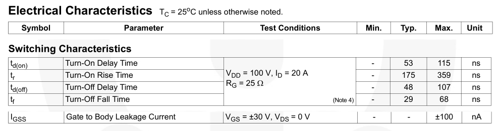

This comes from the Fairchild FDP52N20 data sheet:
The combination of turn-on delay and rise time amounts to (typically) 228 ns or 0.228 microseconds. That is just for the MOSFET to fully turn on.
Then there is the matter of deadtime to prevent a short between the high and low side. When the MOSFETS turn on and off, they produce a transient spike. This is especially critical since both MOSFETS can't be on at the same time due to the dead short situation which will fry them in an instant. The deadtime is therefor inserted and this can be anything between 10-100 ns. You should read this as a period where no information can be captured and is the majority of the Jitter issue in class D and digital audio as well.
228 ns is far from the ideal PWM and the concept of real time in hyper-physics. So here is my question to the community:
What do you consider to be acceptable real-time in relationship to class A's continuous amplification ? Can we accept the 100's of ns time error considering the S/N ratio and THD figures we get via Hypex and Pascal.

One small observation regarding those switching times - you'll note the datasheet specifies the conditions in which those times were measured, among which is a 25 ohm gate resistor and a voltage of 100v across the MOSFET.
Does the Hypex module in that NAD M22 use the same value, and/or the same supply voltage (+/-50v resulting in 100v net across each FET)?

With due respect, this is buzzword bingo. If you have a look at the acoustical section of hyper-physics site there is no mention of realtime or 1nsec at all. Realtime has never been defined by a general fixed time step but system dependent reaction time.A friend of mine is working as a programmer and is dealing with time based functions on a daily basis and he had this to say: "In hyper-physics, real time, as in happening right now, 1ns (nanosecond) is used as the reference."
- Oneminde
And 1ns reaction time correlates with 300MHz bandwidth - audio ends at 20kHz.
