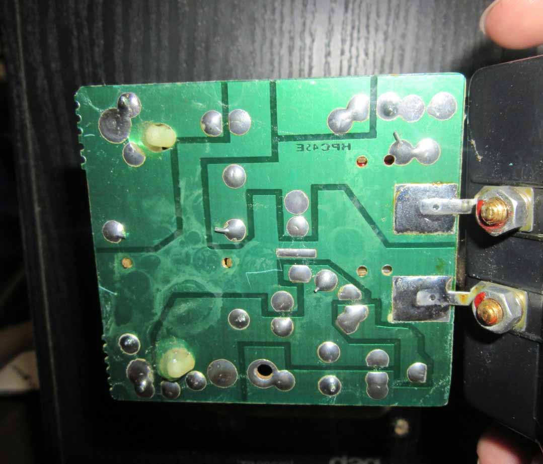

Here are some photographs of the crossover. I replaced two bulging capacitors (6.8µF 100V and 8µF 100V) with new ones (6.8µF 100V and 10µF 100V). I estimate the board size to be about 7cm by 8cm.

So we know (from the photos) 2 caps values [6.8uF, 8uF] and that there are 4 inductors and 1 resistor in the XO. I'm assuming this is the only XO board in the cabinet and that there are none in the other chambers.
First iteration based on what we know and lots of guesses. It's probably a 2.5way XO. I've taken a stab at a typical XO that uses those components and gives you a smooth response, bass boost and reasonable speaker impedance. I used Xsim which is easy to use if you want to install it and try it out. I've grouped the drivers to reflect the biamp connections on your cabinet.
To refine things even furthur. I would need a clear photo (tracks visable) of the bottom of each XO board to get a proper schematic. I would also need to know which drivers those wires go to. I also need the size of each chamber (H-W-L) and the size of each port tube (D-L).

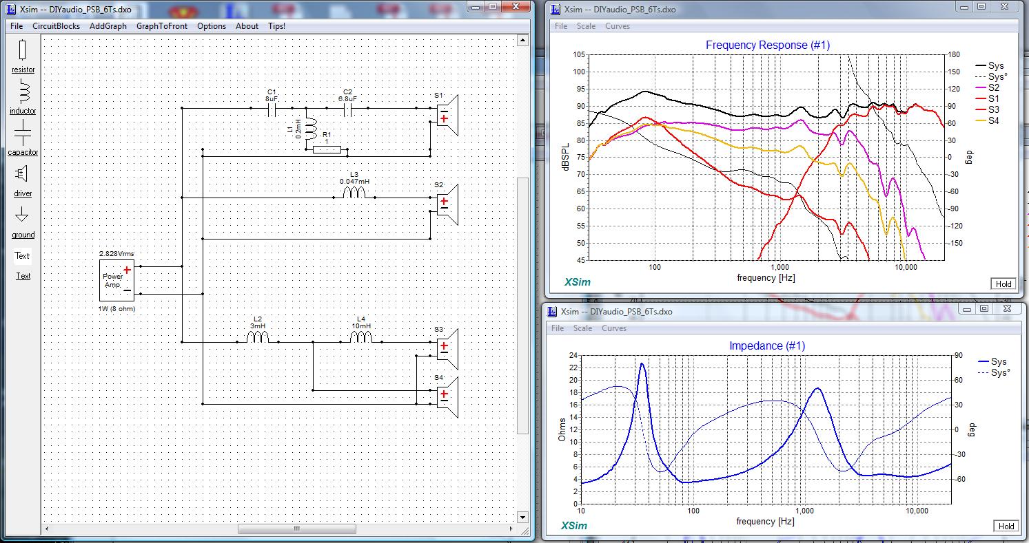

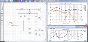

I installed XSim, and modelled the circuit as you did. I then used FPGraphTracer to convert the manufacturer frequency response images into .FRD files. I'm not sure how successful that was, as my Frequency Response curve doesn't look quite like yours (see below).

This is rev 2 based on what I can get from the photos. I think this schematic is 95% correct. I can't tell if the the lower woofer inductors (L3, L4) are in series or parallel, so I put them in parallel this time. The inductor values are a guess based on what seems to work. There is a way to measure them but its not necessary at this point.
The "midbass" circuit physically sits on the upper XO board but is electrically connected to the lower XO board to support biamping. The red+black wires between the 2 XO boards are for this function. There is also a "cut" in the edge of the upper XO board to isolate upper -ve terminal from the lower -ve terminal.
I used Dayton drivers [DC160-8, DC28F] in Xsim as typical 8 ohm drivers because it was easy to get data for them. You can see from the impedance graph there is a problem around 100Hz because many amps can't drive 3ohm. It suggests the original woofers were higher than 8 ohms.

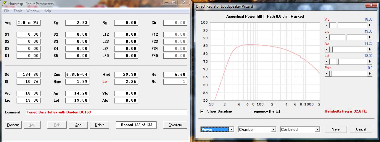

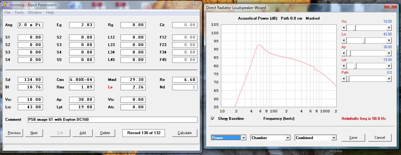

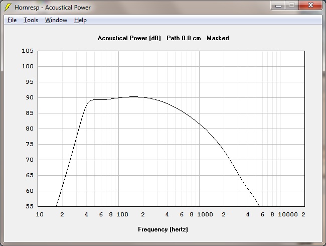

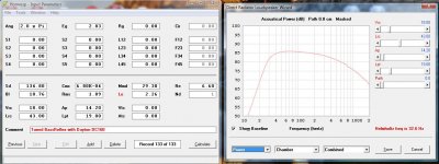

It's the internal chamber volumes that are important to the "tuning" of the system. The driver, the chamber volume, and port dimensions need to work as a system.
The 6T has 3 ports and 3 drivers so I assumed equal volume (18L) for each based on 2cm panel thickness, your dimensions and allowing 12 cm for the tweeter section. It's possible these chambers are joined, or reduced, you would have to remove all woofers and peek inside.
The screenshots are from Hornresp (another free tool) that can calculate box tuning (alignments). The driver you mentioned earlier Jaycar CW2194 does not specify enough parameters so I used the DC160 as an example. Screen capture #1 is the DC160 in your cabinet based on assumptions above. You can see its not a good fit and requires "tuning". Screenshot #2 is same box and driver but the port has been reduced to suite the driver.

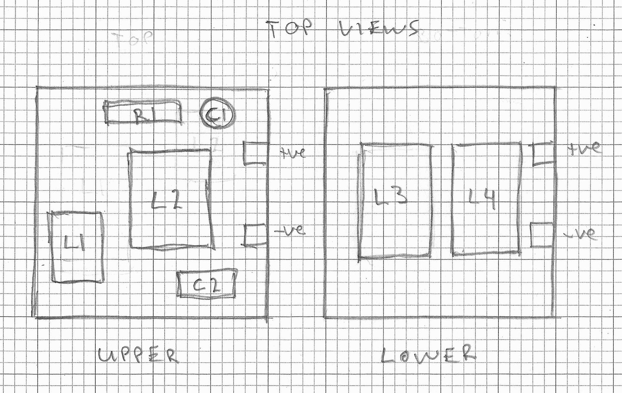

Just noticed I forgot a pic that may help.
The PCB tracking photo (post#8 ) is a bottom view and to make it easier to figure out the connections we need a top view to overlay the components. So this is the "mirror" and "rotated" view. It's like an x-ray view of bottom tracking as viewed from the top side. It aligns to the component orientations in post #9.

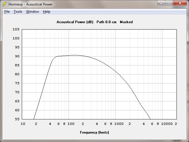

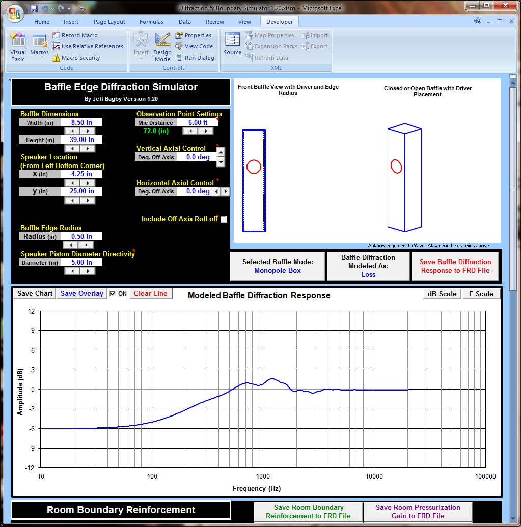

Baffle step loss
Hi Cori,
There will be a low freq loss due to the narrow baffle. Some of the pressure will peel back around the edges but most will go forward. There is a baffle step loss calculator from Jeff Bagby and we can calculate the loss for each woofer based on the driver size, location and cabinet. The calculator produces an FRD files that XSIM can use. Notice in the XO design (earlier post) the bass was raised several dB and it will compensate for this effect.
I've shown the calculator screen shot
Box Tuning
Based on the dimensions and the tuning ports, there are slightly different tunings for each chamber.

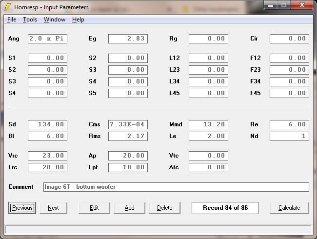

I've used the Jaycar CW2194. The spec sheet is missing a few parameters so I needed to guess at the motor inductance (Le) and strength (Bl). A weaker 6.5" woofer has Bl=6, and stronger one has Bl=10. I should say that from the speaker spec and design, it tuning favours a weaker motor (lower Bl). I've put the responses for the 3 chambers below. The current tuning looks OK, no need for saws :)
Next - putting all the info into XSIM
