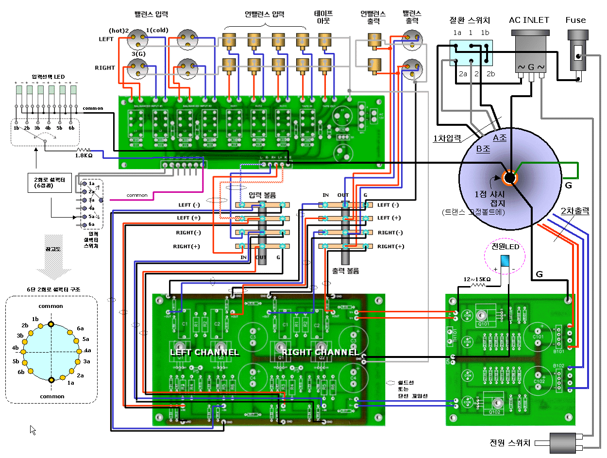

Here's a wiring diagram another member sent to me. I found it very helpful despite the labels in Korean. It departs from the ZBLS specs by using one four-gang pot instead of two two-gang pots to control input and output levels, as well as just one transformer for the power supply. But it includes balanced and unbalanced inputs and outputs so that's a big help as wiring goes.

That is nice, the diagram isn't using an XLR and RCA in parallel, just separate XLR and RCA inputs.

I'm to the point of wiring the signal inputs and outputs. As I read various articles on balanced circuits (the clearest of these, to me, is at Sound System Interconnection), they say the XLR shield (pin 1) goes to CHASSIS ground. If I do that, what do I do when I wire my selector switch and then the pots? There's no ground lug on my selector switch. Then I'm supposed to connect the grounds out of my P1 and P2 to GND on the IN side of my main PCB. Finally, as I leave P3 and P4, do I ignore the GND lug, since I'm supposed to ground pin 1 of the output XLR to chassis?
Joined 2013
Here is what Nelson says:
Speaking of input and output connections, I have not specified connector types for this project. Usually for this sort of project I use both XLR and RCA connectors on both the inputs and outputs. The inputs are female XLR with pin 2 = plus, 3 = minus, and 1 = ground. At the output it is a male XLR connector. In parallel with the XLR connectors are 2 RCA connectors, one for each polarity, with XLR pin 2 connected to the "live" of the positive RCA and pin and XLR pin 3 connected to the "live" of the negative RCA. XLR pin 1 is attached to the grounds of both RCA connectors. These grounds are isolated from chassis ground. The case of the XLR connector, if metal, and shield are attached to chassis ground.
I have no intention of deviating from his recommendations.
As far as grounds go, my selector does not have provisions for ground either. I plan on using a "star" ground. This is a single point where all grounds come together, I have this point just behind the selector switch so the grounds area as close to the connections on the selector switch.. The PC board grounds will also go to the "star" ground point., along with the shielded grounds on my 10K and 5K pots.
