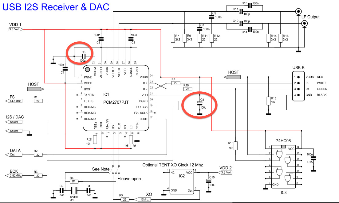

Have a DDDAC 1543 mkII, assembled long ago, about 10 years. Worked fine back then.
Ten year DIY hiatus.
Fast forward to 2019, I'm having trouble with USB (PCM2707) getting recognized: USB enumeration errors.
PCB looks fine, apart from some rust on not used pads. Gave it a thorough clean, and reflowed all solder joints on non SM parts.
It gets recognized one time out of fifty. Usually after tinkering measuring live voltages on it.
I followed Texas Instruments Troubleshooting USB enumeration errors but found nothing.
Uses Guido Tent XO, measured freq with a digital multimeter, stable 12MHz.
VDD: 3,39V
USB: > 5V
Piggy-back soldered new caps on PCB underside for circled positions, just in case original caps had dried after 10 years:
No change.
Tried several USB cables, and different computers, same symptoms.
Tried battery power, and the hefty transformer linear unregulated PSU I use with it; same issues.
Any hints or pointers welcome, don't have a clue what to check for next.

measure the voltage here:
https://ctrlv.cz/shots/2019/01/30/nDTq.png
if is 3.3V, try to reflow all pins on PCM2707, if not helped, carefully change the PCM2707 for new one (heatgun for smd, solderflux ...)
