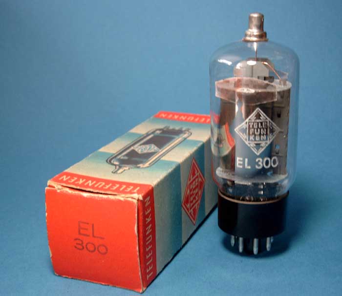

EL300	17.6	275	6.3	1.75	PL300	Octal		Yes		Same as 6FN5

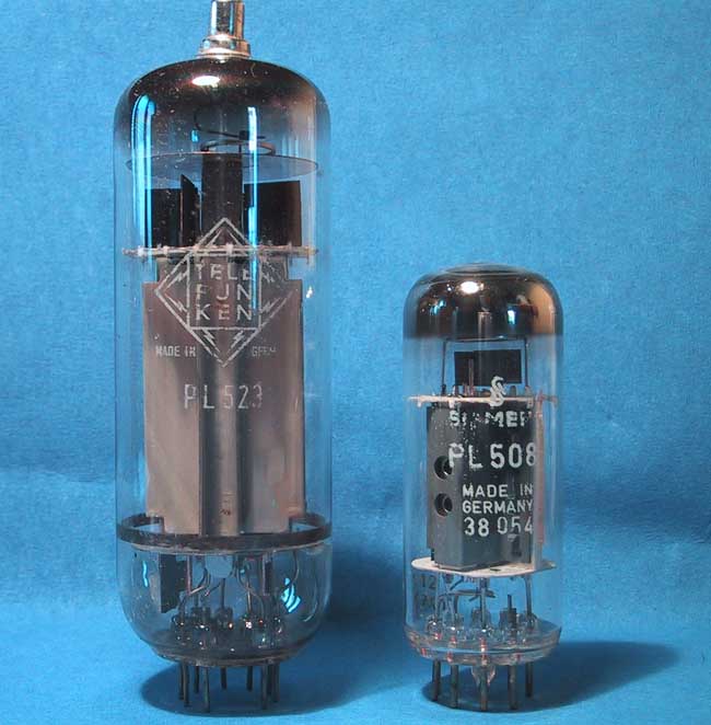

EL508	12	275	6.3	0.825	PL508	Magnoval		No

EL300 17.6    275      6.3   1.75  PL300             Octal    -     Yes  Same as 6FN5

EL508 12      275      6.3   0.825 PL508             Magnoval -     No

What about the PL523 by Telefunken?
or the EL300?
Thanks everybody for the suggestions. I have added a bunch of types and will update the file tomorrow.
The Russian types are difficult because they aren't in most of the data sources I'm using. It's hard for me to identify which are sweep tubes. But if I have type numbers and can find datasheets, I can add at least some of them.
