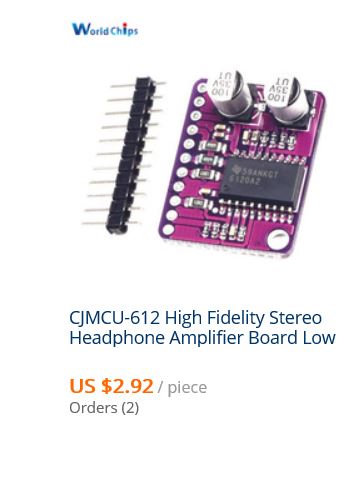

kokoriantz 1st January 2019 12:33 PM
tpa6120 modules
1 Attachment(s)
You need 4 of this . See on Aliexpresshttps://www.diyaudio.com/forums/data...AAAElFTkSuQmCC for others.
kokoriantz 1st January 2019 12:50 PM
or this
1 Attachment(s)
More DIY
