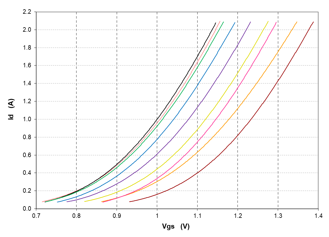

We purchased a sizeable stock quite a few years back, and are finally planning to get them matched in 2019 using our own curve tracer.
Matching conditions will be 24V, 0~2A continuous mode on 60°C (+/-1°C) heater block.

Curve Traces of 10 Random Samples
The curve traces of 10 random samples taken in 2013 as incoming check.
Patrick
