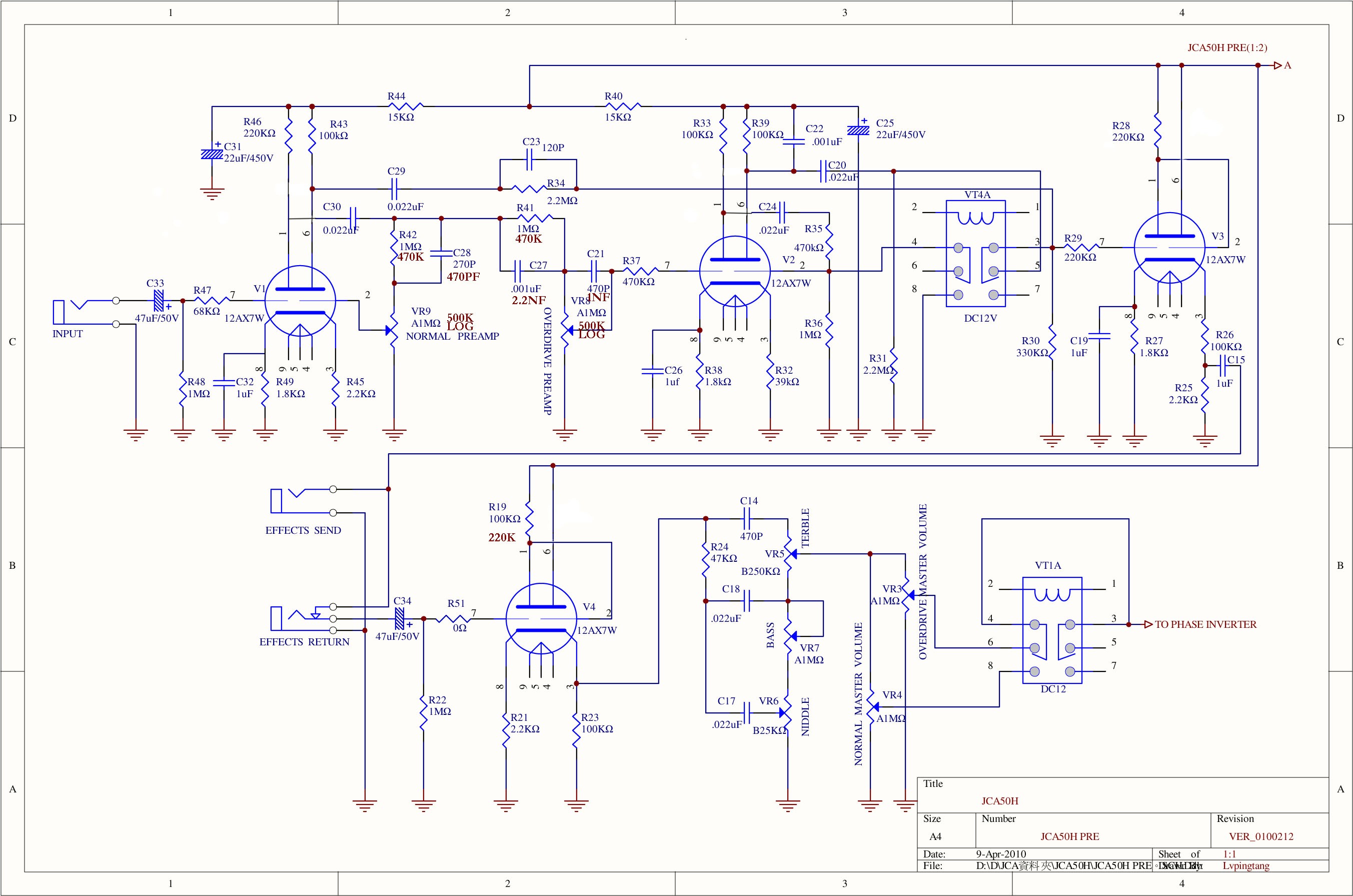

as been an long time fan of Slo-100 (played it a couple of time like 10 years ago and still cant forget), I picked up JCA 22H. Not Slo-100, but if you played the beast you would know that that amp cant play even moderately quiet. Also, JCA 22H schematically pretty similar to the SLO-100 with a number of cost cut solutions and cheaper components. So my thought are that it can be brought pretty close to the actual slo-100.

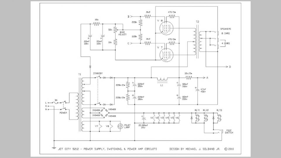

The amp I picked up had blown OT transformer, so I did some online research, contacted the ZM all-mighty and ordered Classictone Transformer OT Marshall JTM 45 Output Transformer and this choke: Marshall 3 Hy Plexi Style Choke
However, as I am tube kinda-noob ZM suggested me to start a thread before I fire it up as there are quoting him: "it could be easy to introduce separate biasing of output tubes", and most important this: "if you're not sure exactly how to set Iq and everything (secondary phasing is important , due to feedback) , start new thread before powering on ....... just to avoid more smoke" :).
Here is are schematics I found tp start. (There is a slo-100 clone thread here with slo 100 schematics)

wrong pdf
I see some particles , of which I'm even more clueless than in electronics
regarding changes to separate biasing of output tubes , if possible , post little better schematic (higher res) and I'll do edit for you

here Is the schematics of the output stage and PSU

Another thing I have the choke and Soldano replace 1k R51 with it. Rdc of the choke is almost 10x times less than that resistor. Should I change other resistors to keep the voltage to the tubes the same or it should be fine?
I mean R52, sorry.

So I've been playing it for a couple of days and doing some minor measurements and testing meanwhile. That is what I found.
1. Initially the voltage on the central tap of the primary was 370V and bias was around 30mA which is completely unacceptable for EL84 from what I found. So I trimmed down the bias to 19mA. Plate voltage went up to 385-390V. Too hot imo.
2. Even though the output tubes were matched pair from TubeDepot the bias is around 18mA on one and 21mA on the other. Should I worry about it or it is ok?
3. I did some experiment with my Variac and found that sound wise I like plate voltage at 350-360. I cannot attest for going lower as I think the filament heating go down as well.
So I did some searching, but can not get any good answer and would appreciate your help. Is it possible to lower the plate voltage to 350-360? Change resistors in PSU maybe? Thanks!
