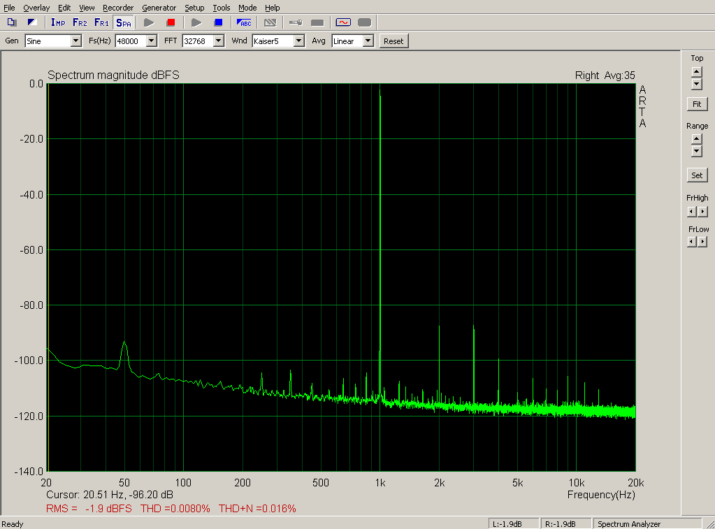

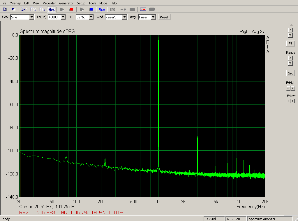

An internal soundcard of a large noisy dual-xeon workstation, stereo loop out -> in with a 2m coiled thinnie.
Measured by Arta running in linux + wine.
  • The first screenshot shows performance of the actual hardware - loop hw out -> hw in.

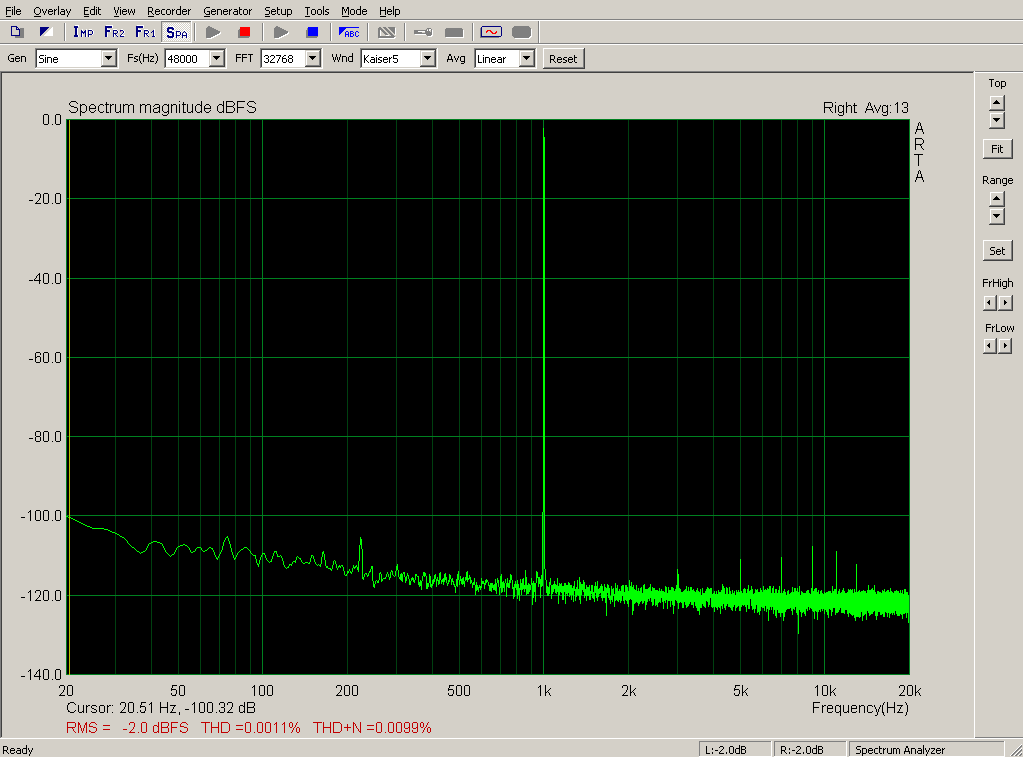

  • The second screenshot is virtual balanced setup made from two channels where each has its DC offset and linear gain calibrated/compensated.
  • The third screenshot is virtual balanced setup, each hw channel is compensated with a fifth-order polynomial calculated to cancel out static non-linearities.

The principle is actually very simple - the polynomial is calculated as best-fitting transformation from a wave recorded in calibration to a precise sine wave, generated directly in octave. Frequency of the incoming wave is known (since we have both ends of the measurement chain under control), phase shift of the recorded wave is measured with fft (just a few periods of samples produce very precise phase value for the first harmonic). Surprisingly simulations in octave and the actual measured performance are rather coherent.
The calibration holds only for a very limited range of frequencies and amplitude levels. I think that many not be a problem for measurements, it is possible to fully automate the whole process with several signal relays and resistors (my next goal).
All the scripts and route plugin patches will be posted on github within a few days, any improvements/patches/suggestions are very welcome. It will take some time before the scripts get robust enough to allow reliable automated calibration.
I will compile the plugin for my measurement workstation with ESI Juli to test a decent soundcard in a cleaner environment. Simulations in octave with pre-recorded Juli output are positive :)
It seems to work :)
