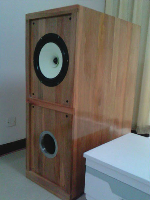

Here is a product listing for the drivers, mine is the white cone, not that it matters much :rolleyes:
声韵12寸全频钴磁喇叭hifi发烧钢磁铝镍钴扬声器超古董全频非同轴

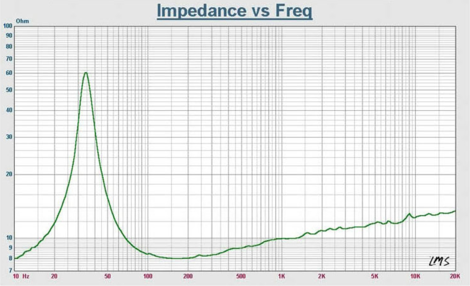

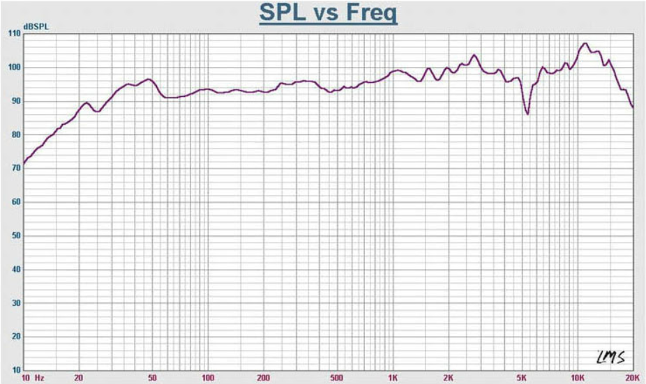

Here are the relevant specs, straight from the datasheet, I've also attached the full PDF-
Aucharm UR330B8-11F full range 12"
Impedance : 8 Ohm
Minimum Frequency Response: 34 Hz
Reproduction Frequency Response: Fo~18K
S.P.L. : 92.806 dB/W(m)
Rated Input : 30W
Music Power : 45W
Equivalent Diaghram Radius: 132mm
Equivalent Mass : 26.419 g
Magnet Weight : 1100g
Net Weight : 11900 g
Fs : 34.942 Hz
Re : 7.2 Ohm
Mms : 32.964 g
BL : 8.135 TM
Qts : 0.691
Qms : 5.647
Qes : 0.787
Vas : 228.816 Ltr
That high Qts seems to be pretty damning is my first impression.

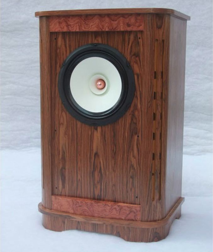

What would be a decent cabinet design that would not be excessively large for this driver? Ideally I would like to do some sort that would have the driver approximately ear level to seated listeners. Maybe some sort of back-loaded horn? I'm not interested in large open baffle types, as I just plain don't have the space for it, and don't really care for them all that much personally. She who must be appeased must also be taken into account :rolleyes:

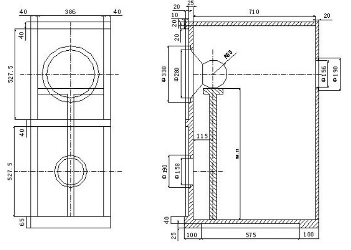

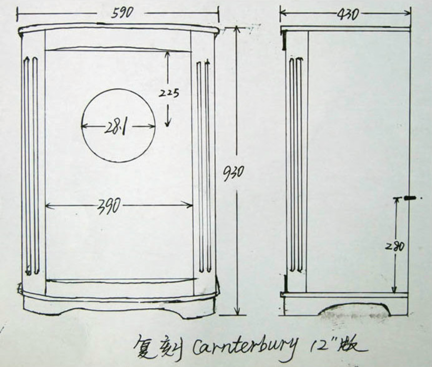

There are a few goofy suggested(?) designs on the product page as well, and other than the "Canterbury" style, they all look pretty much to be oddly sized. I'll attach a few for reference, just in case the product listing disappears later. Something of a similar form factor would be nice, and I can go maybe 18" deep, maybe 20~24" wide, by 32~36" tall I suppose, but depending on what works I can be a bit flexible on things. I really wish I had a PC that I could set up some simulation software on, I don't have access to a windows machine for more than an hour or two a night at home, and what I do have is old and tired. Everything I can use at work is Chrome OS, so unless I find some sort of web-based solution I don't really know of much, other than basic vented/sealed box calculators.
So, what do you guys think? Any ideas? Maybe just a basic version of the "Canterbury" with some nice stain? Could double as a stand for a small aquarium to take up less space :D

How big? Looking at sealed box ideas I may be able to build something with a 28" wide, 44" high, 17" deep sort of form factor, with maybe .88 system Q, which may be too high I'm thinking? That's already a 350L box, not counting the driver displacement, and that's already getting pretty big. Any smaller box and I'm thinking it would make the bass too warm and boomy.

Call me old fashioned, but vintage type drivers seem to work well in vintage spec cabs with best overall power handling short of a BLH, especially if tube driven, so thinking a Vb = Vas/1.44 tuned with a vent area [Av] = [Sd] and damped to 'taste'. Worst case is one winds up stuffing it enough to be a 'Pensil' type alignment.
Assuming a ~38" seated ear height minus 1.5" thick base = ~63.37" x ~153.14"^2 WxD, ~547.39"2 vent x 0.75" baffle thickness with driver, vent offset = ~26.87", ~53.74" from top. All dims inside [i.d.].

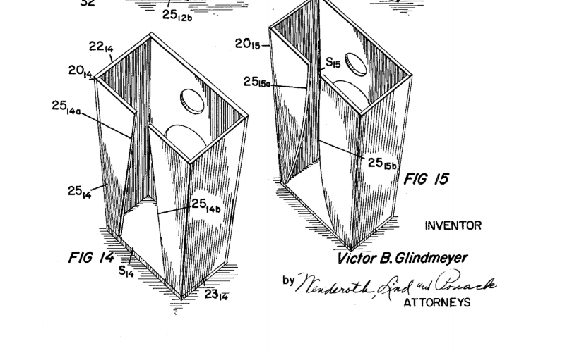

maybe someone here can guess how this arrangement of an open top pipe might work in practice - - one variant for the rear slot is "K-ish"
Well, they would mimic any number of spray/bleed nozzles used in fuel, etc., systems.
Shades of B0$3 'cherry picking', with others being Klipsch, Jensen, R-J, etc......... apparently all those earlier patents had been abandoned by '60. Noticed they misspelled Voight's name [Voigt] among other words :(.
