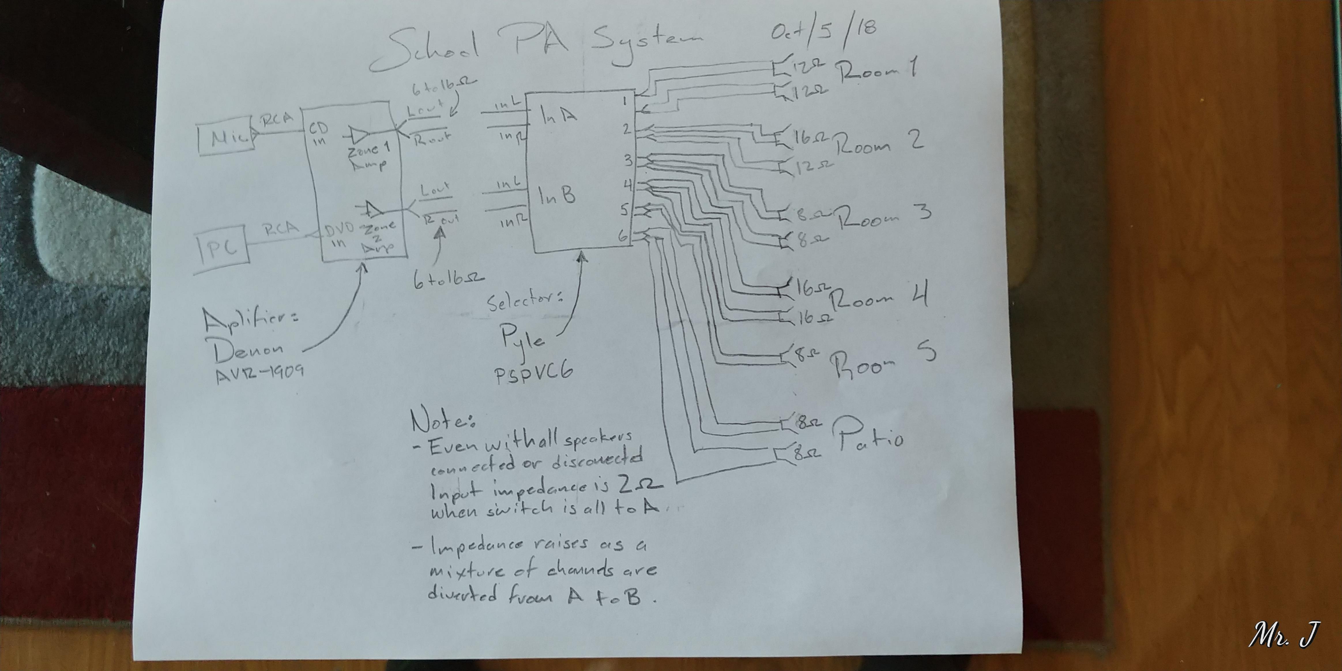

Hello all,
Please find a sketch of the current system attached.
Note that none of the speakers have a transformer, as they are regular home theater speakers.
Also, the speaker selector creates a load of 2ohms on the amplifier when all speakers are guided to one channel.
In my mind it is still cheaper to buy a reputable 2ohm stable amplifier at $250 USD and keep the current speakers and current selector than buying a new 70v amplifier, speakers with transformer or transformers to go with current speakers... What do you think?
If you think going to the 70v system is better, please provide examples of a good amplifier and speakers.

If you really really want to go cheap all you need is a $50 mixer. You do have four amplifier channels not two. Just feed all four the same signal and you can drive all your speakers at once. Put multiple speakers that are in each room in series to raise their impedance. Then put no more than two rooms in parallel on each amplifier channel.

If you have 100 speakers then yes use a 70V system, but each transformer looses 1.5dB so between the amp transformer and the speaker transformer, you loose half (3dB) the audio power. And only very expensive 70V transformer are fit for music. Also, any amp with VI protection will puke when connected to a transformer ~zero ohms DC.
So, If you have only a dozen speakers, you should series parallel them. You will get more power even with #18 wire, and better sound than using transformers. This does not allow local volume controls.
It is most likely that some electrician changed the wiring on you, or the amp has developed bad electrolytic caps.

Actually it's more like 1ohm and that isn't going work. There is an easy solution that won't cost any money, for each room that has more than one speaker simply wire those two speakers in series. That will raise the overall impedance when all speakers are selected but still allow the mic to be addressed to individual rooms.
