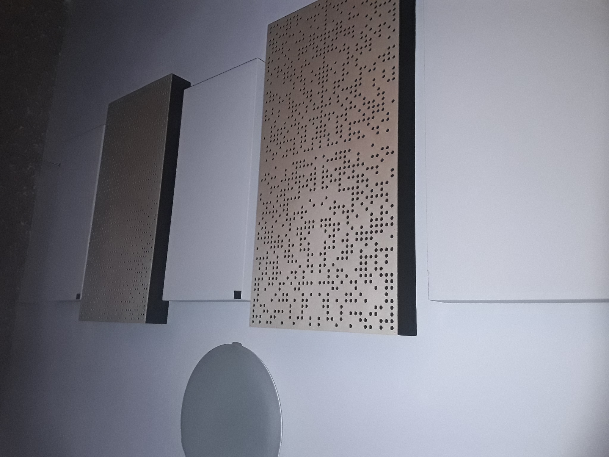

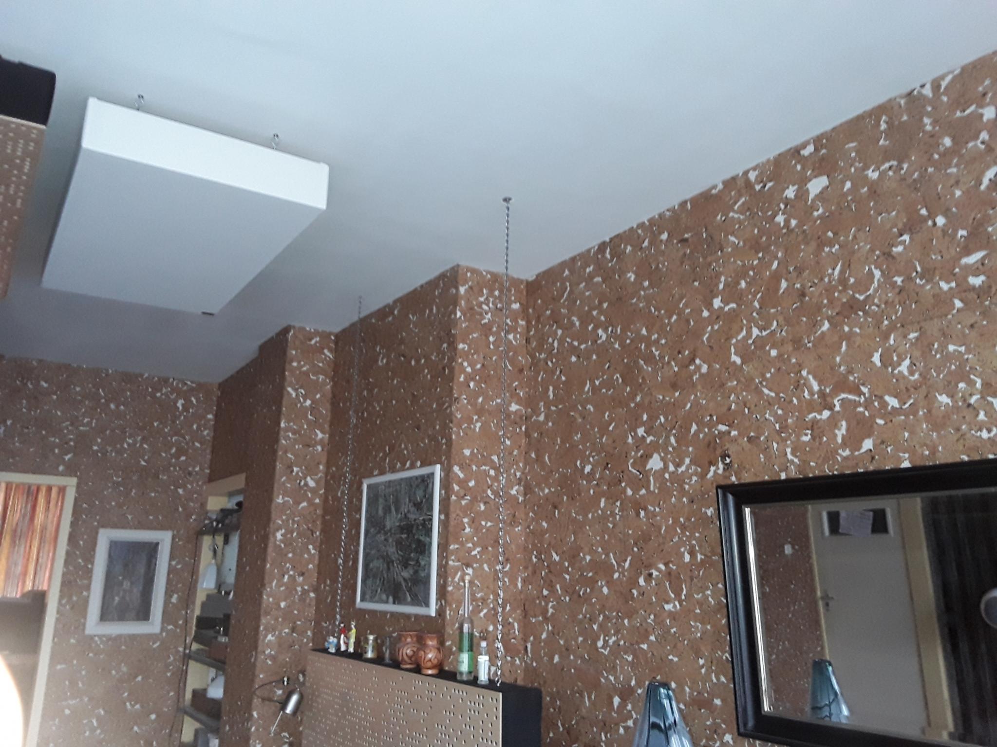

eduard 16th December 2020 03:07 PM
3 Attachment(s)
Hello,

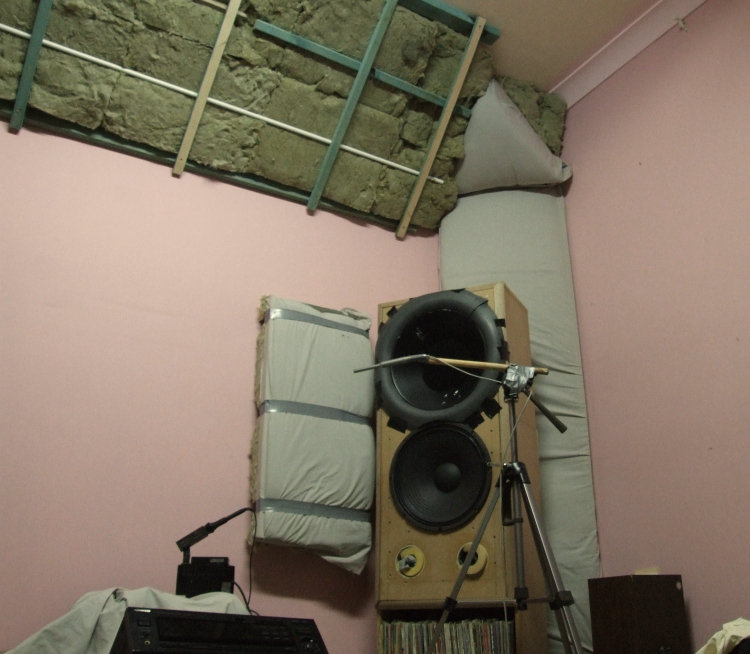

As you can see i already installed some acoustic panels on my ceiling and sidewalls. The company where i bought them doesnt have something that will fit in the area between the outer panel on the ceiling and the panel in the middle of the sidewall. ( the one in front of the plasma screen can be lowered when i listen to my big set)
My idea was to make a kind of construction looking like a fence with let us 2 inch and 4 inch diameter bamboo poles about 3 feet long and then switching from a thin to a thick one all the time to create some diffraction.. The poles will follow the long side of the panels and make a curve in the area where wall and ceiling meet.. Maybe it will just give a tiny improvement but it is mainly done for the looks.
I could put them vertically, let them start close to the outer panel . I could turn them into a bass trap when closing the two sides with a fabric and use the usual filling.
As usual all good ideas are welcome,
Greetings,Eduard

eduard 22nd December 2020 06:30 PM
Hello,
Searched the internet a little bit more and i cam across the info that if you wanna use an absorber with considerable depth (in my situation about 16 inch) you will have to use material that has a low density. In order to have the benefit of the depth the '' sound wave '' needs to be able to reach the other end of the trap. I found some interesting material in Germany (called Caruso-iso-bond)
Because there are diffusors and absorbing panels in other areas of my room. The traps with the highest volume preferably only absorb the low frequency energy.
The bottom and top side will be open. Just the two sides that can be seen will be covered. I can use the bamboo from my last post. I can use a mat made of half inch diameter bamboo, one inch diameter bamboo or flat strips of bamboo 1/8 inch thickness and connected to the strip next door with some space in between.
The most eye catching solution is the one from next post. I think and i hope it will not degrade the performance in the lower region of the bass trap. The bamboo itself is not thick and the circular shape will diffuse,
Any ideas welcome,
Greetings, Eduard

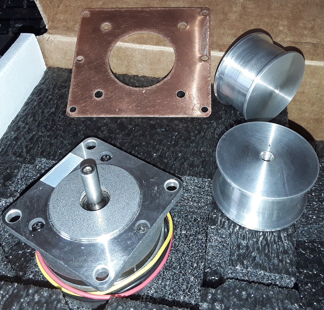

eduard 22nd December 2020 11:24 PM
3 Attachment(s)
Hello,
It seems there is no knowledge here to be shared.
I will try to find some more information on the internet and just trust my own common sense.
Greetings, Eduard
P.s Just finished my diy pom motorhousing so have more to do
