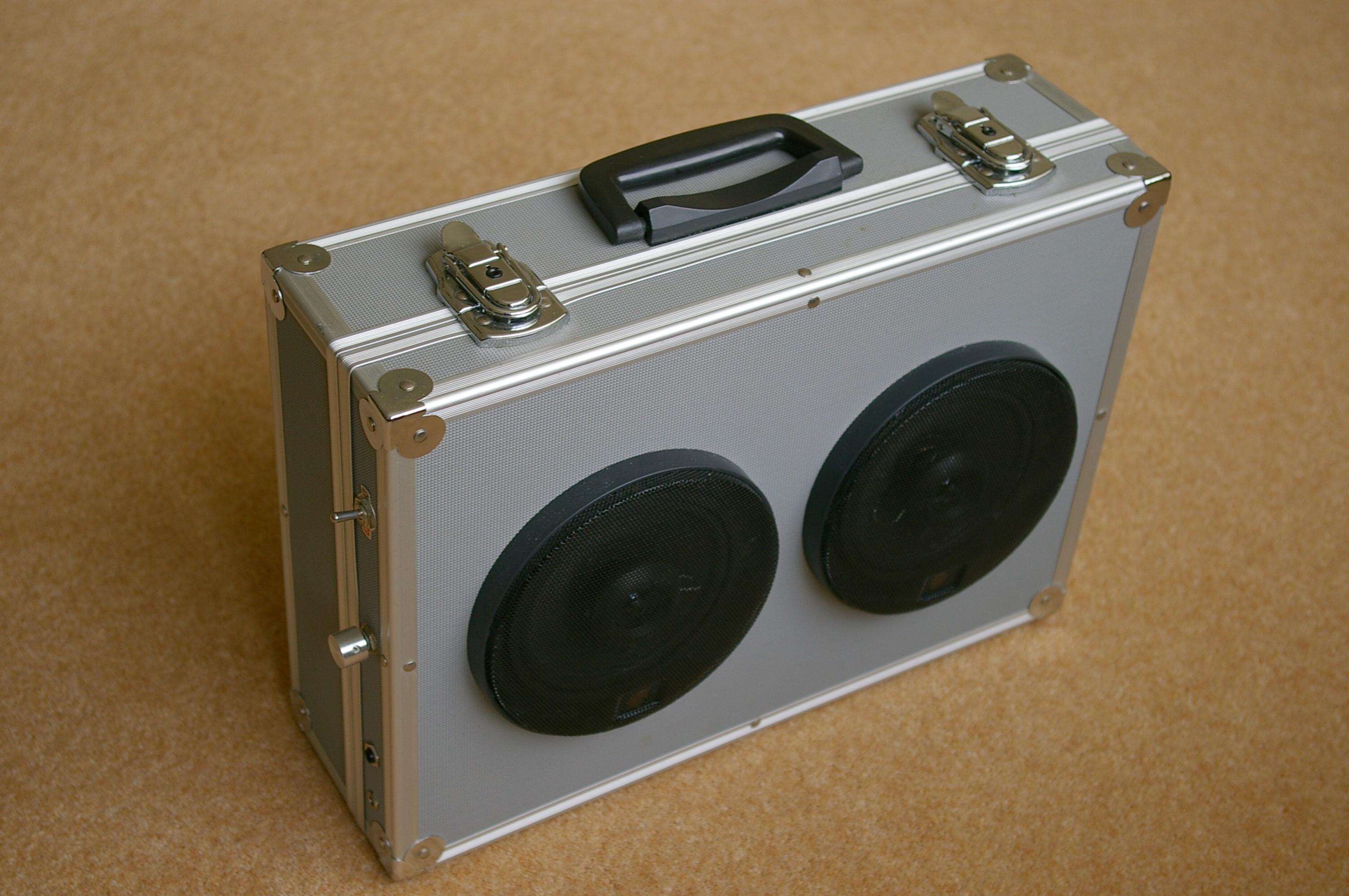

Consider a pure rectangular cabinet (which you can build) and not a plastic rounded edges one (which you can not) which makes it a little more difficult to fit inside a travelling bag.
No, "Tupperware" type plastic food containers are not suitable for this (I tried) , walls are too thin, too flexible, not braced, and vibrate way too much: unusable .
If anything, plastic tool cases are better, (I tried), and worst case they don´t need a bag for transport, they are self contained and even have carrying handles :cool:
maybe you find a size where 2 of them fit inside your bag, but in any case we need your data to be able to answer.
I bet a couple such cases, sporting, say, a 4" or even 5" full range speaker, and one housing, say, a 30+30 to 60+60W amplifier, maybe Class D and with an SMPS supply to save weight, will be immensely better than those 2" TV speakers, any day of the week.
I have built small Guitar and Voice amplifiers inside such cases (as well as powered mixers to be used with external speakers) for travelling Musicians, even with built in rechargeabla battery for street/subway performers, go figure.
Or you can build a lightweight box, any size you want, out of 12mm plywood, even down to 9mm if you are (or can get) a somewhat skilled carpenter.
