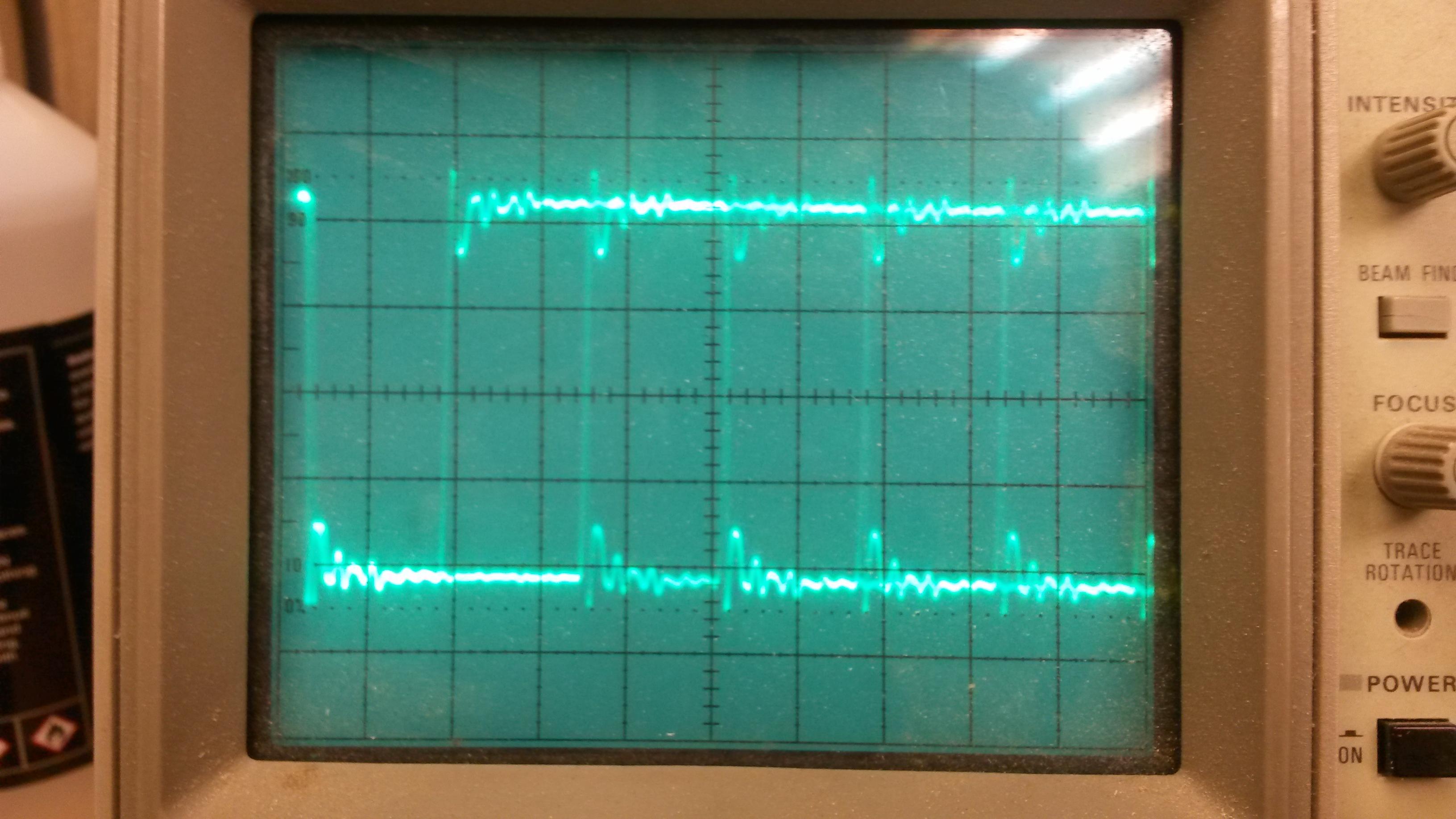

I've had moderate success using domestic 5.8GHz "AV Sender" transmitters and receivers to create a radio link that transports an S/PDIF stream over the analogue video channel (yellow RCA connector). Reception is very clear and the range is up to 50 metres, but only when the two stations are not moving. As soon as there is significant relative movement between TX and RX, the audio signal starts to break up unacceptably. This situation is improved somewhat by using circularly polarised antennas, but remains an issue. It is not improved by using a higher-powered transmitter - the original system radiates 25mW, but even moving to an 800mW TX does not make a lot of difference to the movement problem.
I've been analysing the signals in the system on my 50MHz Tektronix scope and have a couple of questions (pictures included below).
1) The first picture is the S/PDIF waveform as measured at the input of the TX. It is reasonably square, but should there be so much ringing at the transitions?

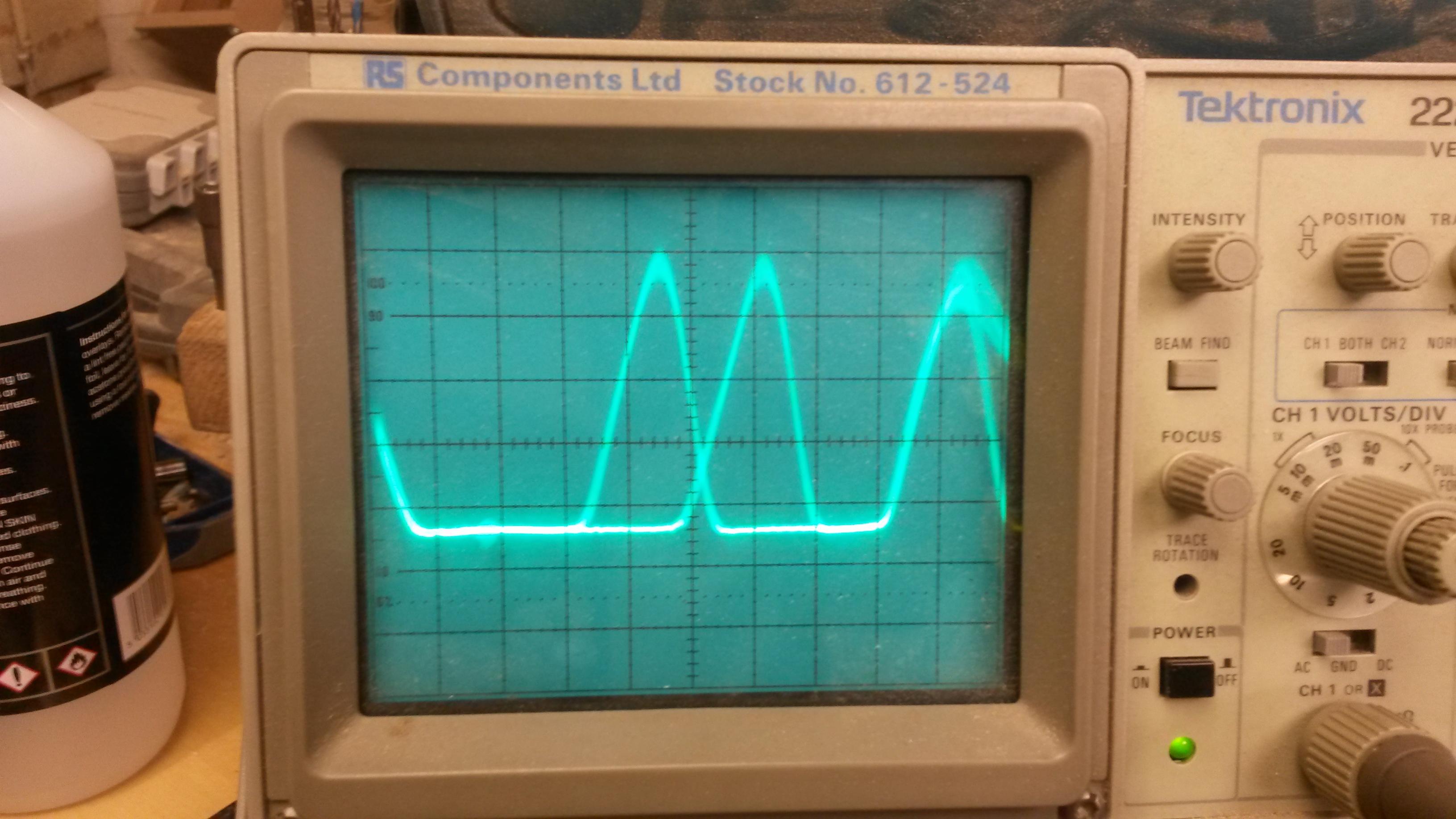

2) The second picture is the signal as measured at the output of the RX, terminated into 75 ohms. It is obviously quite badly degraded, although the DAC can still lock onto it with surprising accuracy and reconstruct a good audio signal....most of the time. Should I expect to see a better-looking received signal, given the bandwidth of a composite video channel?
3)Having observed these signals, it is easy to see on the scope that physical movement of either station causes a large timing deviation in the received signal, which I suppose would constitute a massive amount of jitter in the digital bitstream. Given that, is this system doomed to failure, or could I re-clock at the receiver and gain an improvement?

Using S/PDIF as RF transmission signal with a standard (analog) AV RF link is not a good idea for several reasons!
1. The S/PDIF fundamental clock frequency is around 1.7 MHz - thus the video bandwidth will definitely degrade the signal as a square wave signal is composed of the fundamental and many many higher harmonics which will be 'cut' by the AV bandwidth. Your scope images clearly show this
2. The S/PDIF signal must be highly stable and have low jitter as the signal is directly used to sync the local clock oscillator at the receiving end to reclock the signal. Any increased jitter will lead to degraded sound quality or to a total loss
3. The wavelength at 5.8 GHz is a mere 6.5 cm - this means that especially in cases where you may have signal reflections like in a room or some other objects around- you will see strong signal strengths modulation by slight movements of the receiver. Small shifts may already lead to a total signal null independent of the transmission power - this was also one of your observations as increasing transmission power did not improved signal quality a lot.

I suggest you try to use the lowest feasible sample rate for your application. When I was trying to send SPDIF over the video channel of an AV sender as a way to do whole-home distributed audio back in 2013/14, I found that 48kHz was barely doable, and 44.1kHz slightly more reliable. If you can drop to 32kHz, which some DACs will still accept, you might have better luck. The waveform shape should be better preserved. The lower you can go the better it will be, since the time that the spdif signal spends at either the high or low states will increase as sample frequency decreases.
Thanks Charlie. I've just looked at my ADC and DAC modules, which arrived without documentation, and although the mfr. has helpfully lasered all the numbers off the ADC chip, the MCLK crystal is 12.288MHz which suggests a sample rate of 48KHz. So I guess I will look into modifying that. Is it as simple as swapping out the crystal for an 8.192MHz unit?
The DAC can accept 32kHz signals, so there shouldn't be any issue there.
Quick run of the numbers suggests that a 32kHz, 32 bit signal will have a bandwidth of about 4.0MHz, so ought to survive transmission a LOT better.
Looking more closely at the specs of my transmitter, it claims 18MHz bandwidth for the video channel; I don't think I'm seeing that at the receiver, so it's probably safe to assume it *is* filtering down to the expected domestic video signal bandwidth. So, a better receiver might also be in order....
