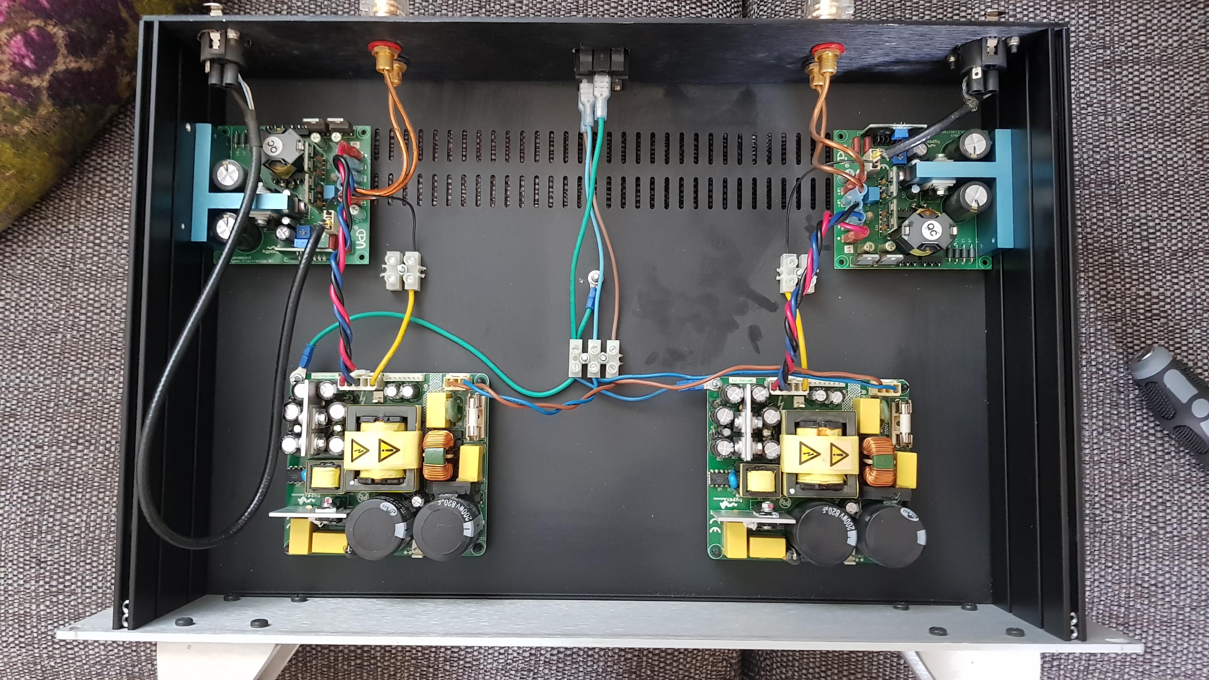

I have a Hypex amp with 2 UCD400HG (with HXR) and two SMPS400A400 power supplies. I've had it 3 or 4 years now. It was fine for a long time but has now started making a lot of hiss, and also some strange kind of 'interference' crackling type sounds. It can vary in loudness from time to time. If I unplug the audio input XLR cables, the noise gets very loud, which makes me wonder if this is somehow related to grounding issues? It happens in both channels of the amp and if I only power up one side at a time, I still have the problem so it would seem odd for both independent channels to develop the same fault.
Any suggestions on a solution before I try and ship it to Hypex for possible repair?
Here is a photograph:

Not related to hiss or crackling, but for your own safety I would recommend to look at the case earth connection again. The earth wire must be longer than the neutral and live wires. Furthermore, routing it through a terminal block does not seem safe to me.

please check the bottom plate and scratch the black collered surface away and reconnect the earth connection. mybe this black collered surface has to scratched away at other points too.
