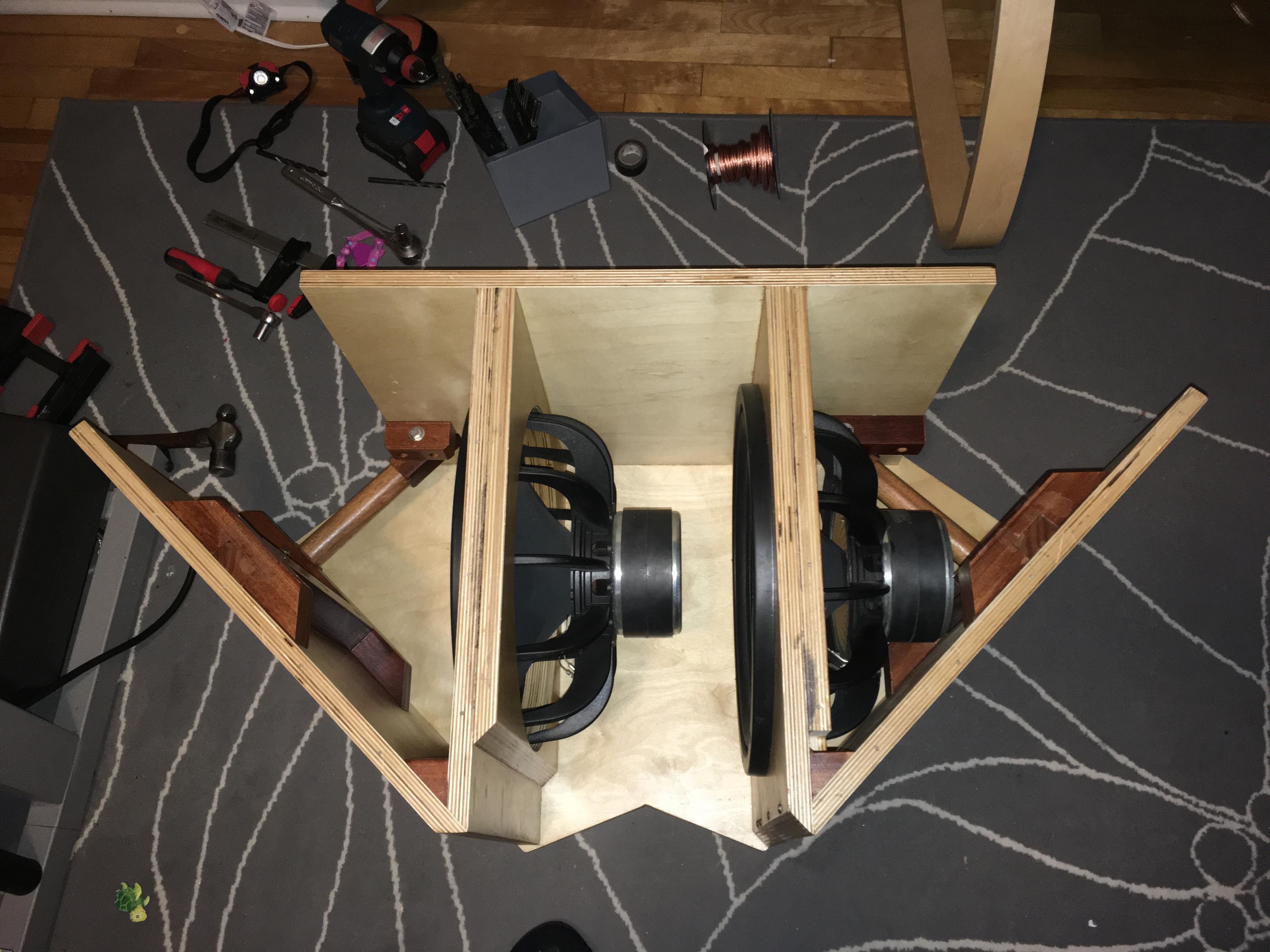

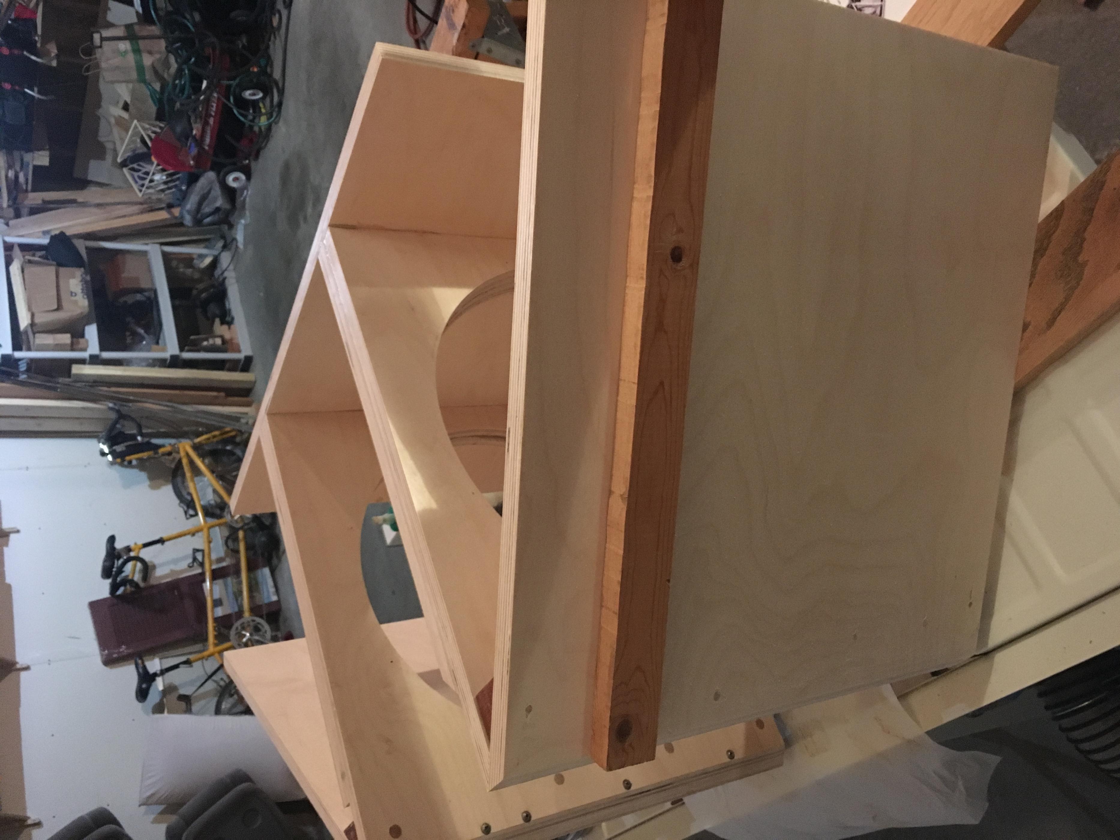

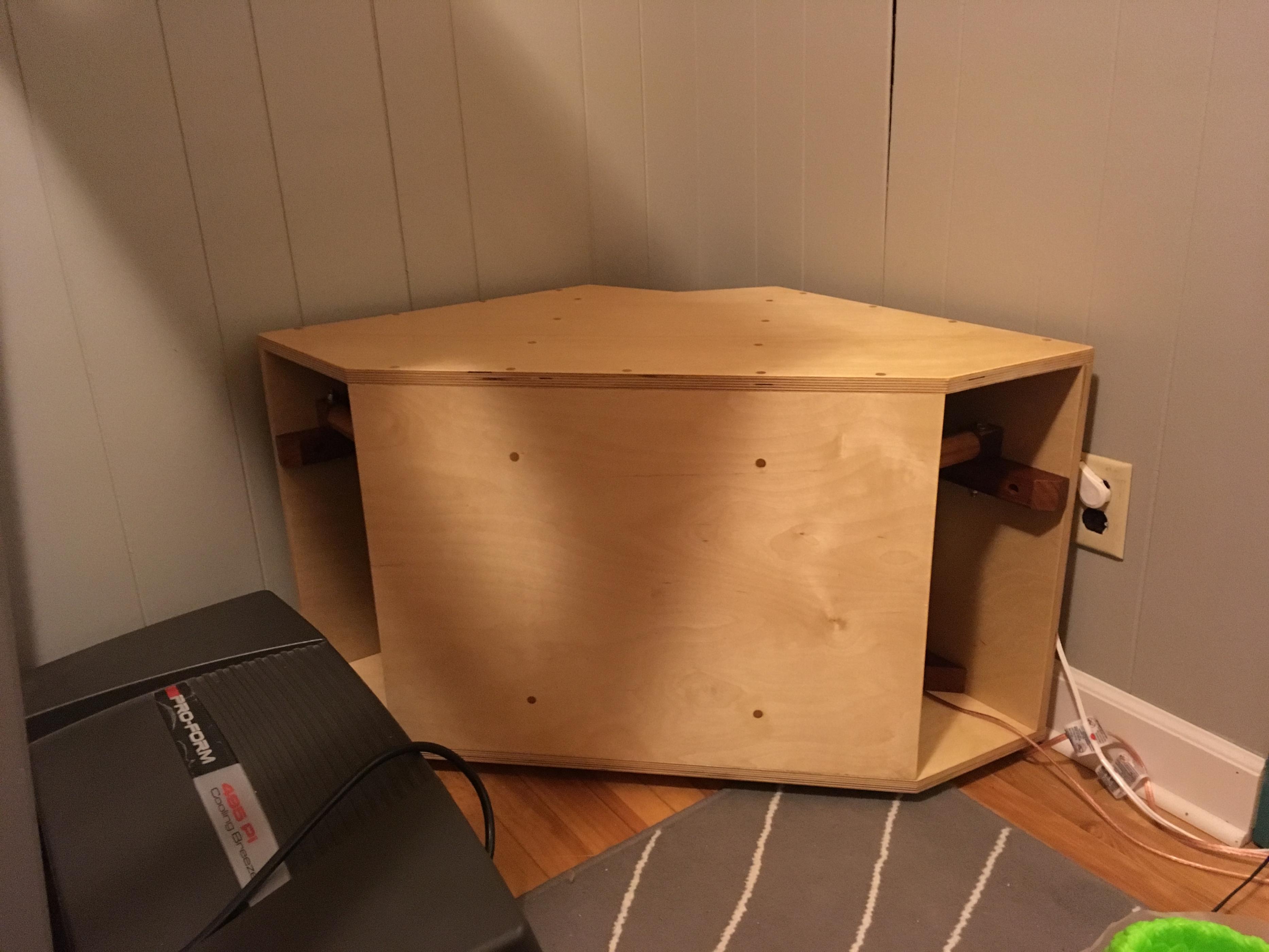

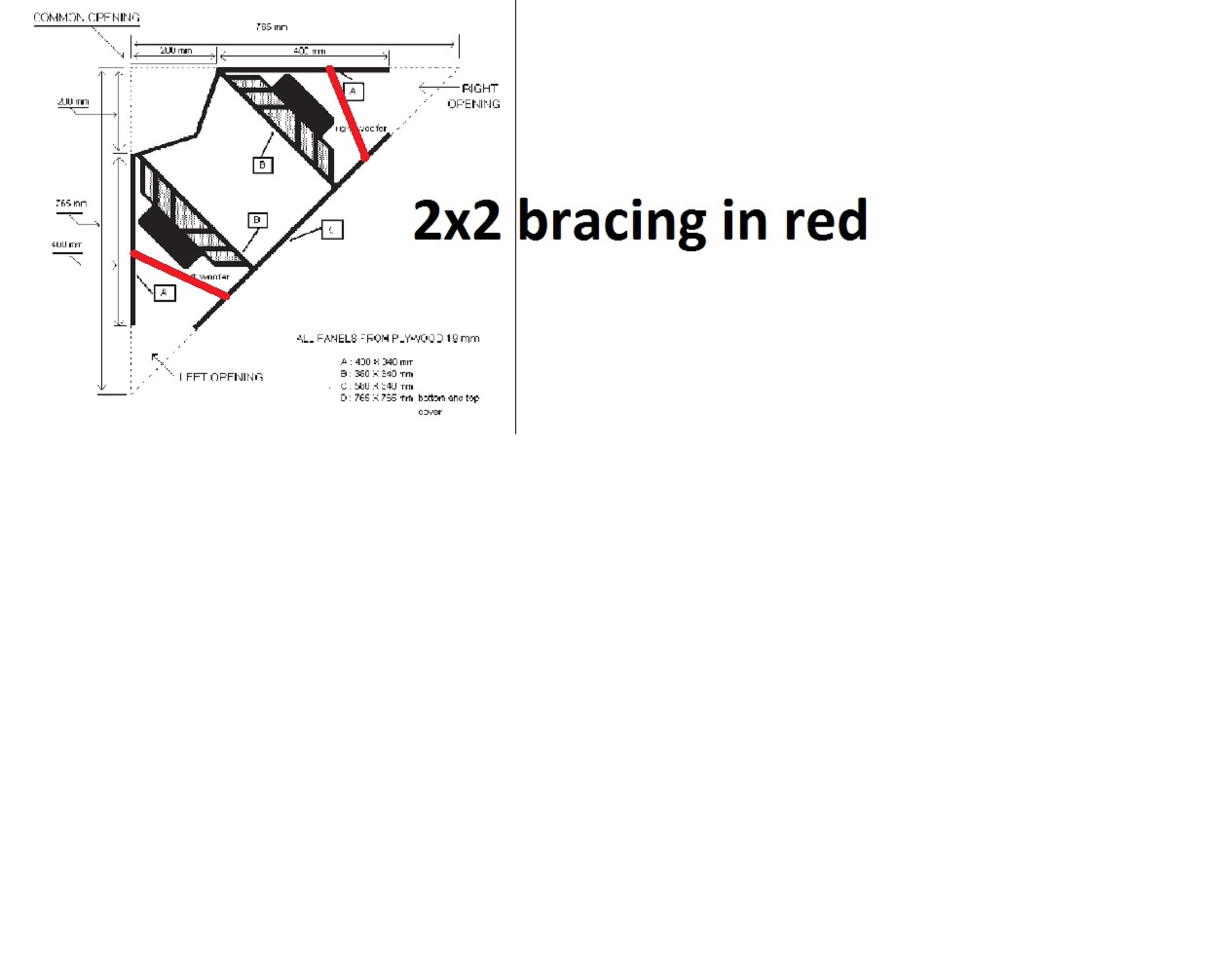

I am building a modified w-frame dipole subwoofer. It is made to go in the corner and is based off an audioxpress article from 2004.
The original plans did not have any bracing and I noticed that the linkwitz dipole has no braces.
However I am thinking of connecting the panels internally with a length of 2”x2” hardwood. Are there any cons to this approach? Can’t fit a window brace
I’m also considering adding strips of wood on the outside to raise the frequency of panel resonance. Any thoughts on this? See pic

Thanks for sharing your interesting project.
The original plans may not have had bracing cause it want needed. Open baffle designs are meant to be low on resonance due to the relatively low pressures produced.
It would be good to measure pre and post braces to see if they are needed.
Braces in the output might create diffraction and reflections, but that might not be heard. I suppose braces that are rounded in profile and thinner would have less effect on the sound waves. Take that idea to the limit and wire tensioned up could be effective. Otherwise thin dowelling should be fine as the forces will be longitudinal along the dowel.

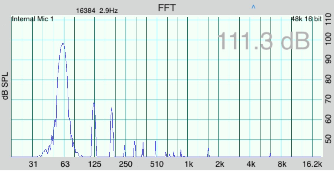

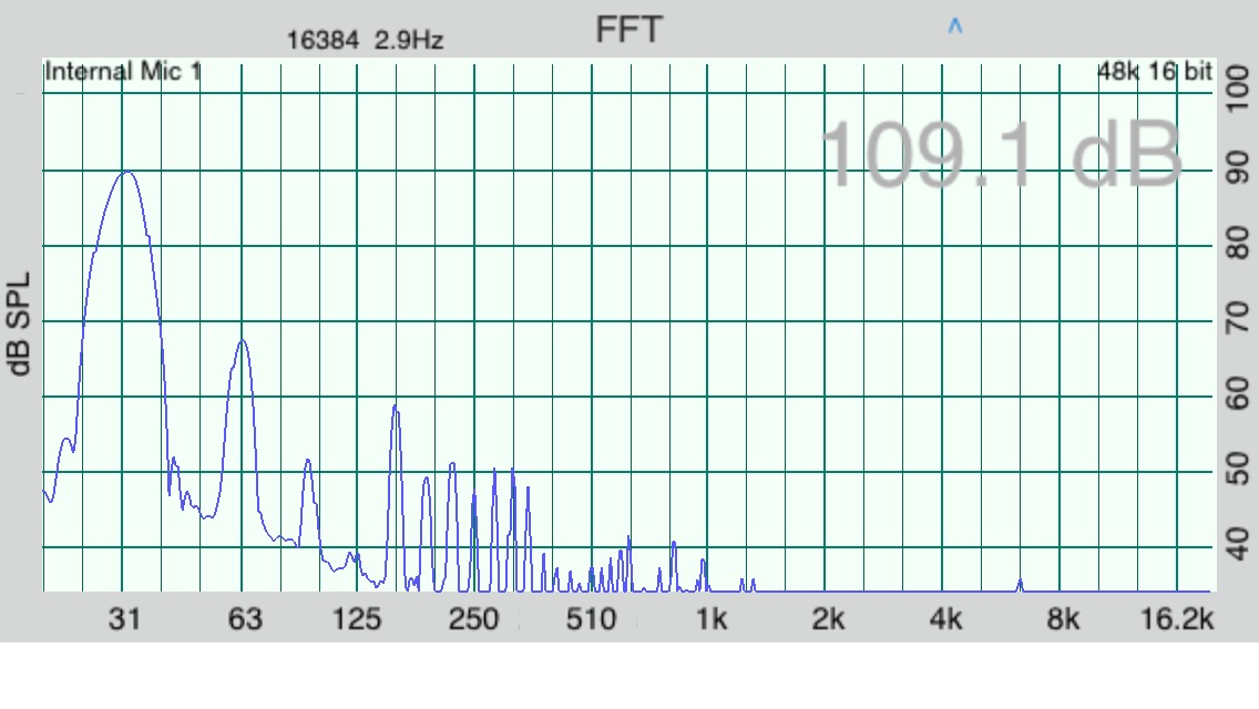

Hi all, just wanted to give an update on the sound of these corner dipoles.
I'm still playing with the DSP but I really like the clarity of bass reproduction. Acoustic bass is reproduced clear with no smearing of the notes. When you play a kick drum through these you can actually here the peak of maximum SPL. Bass extension is very strong down to 28 hz.
Movies and hiphop bass with 30-35 hz notes will shake the floor, and this was the biggest surprise to me.
I've built a 20hz tuned 200 liter 12" subwoofer, a sealed peerless xxls 10" subwoofer for the car and a sealed 12" subwoofer with an f3 of 30 hz but I've never experienced such clean 30-35 hz output.
However if massive deep bass SPL is your thing I would not recommend this approach as i can easily get these to bottom out above 95db at 30hz and I have applied a 30 hz high pass because 20 hz is basically a distortion machine.
I know in room measurements don't mean much but I've included some distortion measurements of these in the corner of a small bedroom with the mic about 1.5 meters away.

Those are harmonic distortion plots for 31.5 and 60 hz. I play a sine wave and then turn up the volume until distortion is around 5%. These measurements are taken at the listening position that is about 1.5 m away.
Let me know if you want more detail.

RTAs. Thanks. A nice way to present it, at least as a complement to the usual freq plot for a given constant-input sweep.
